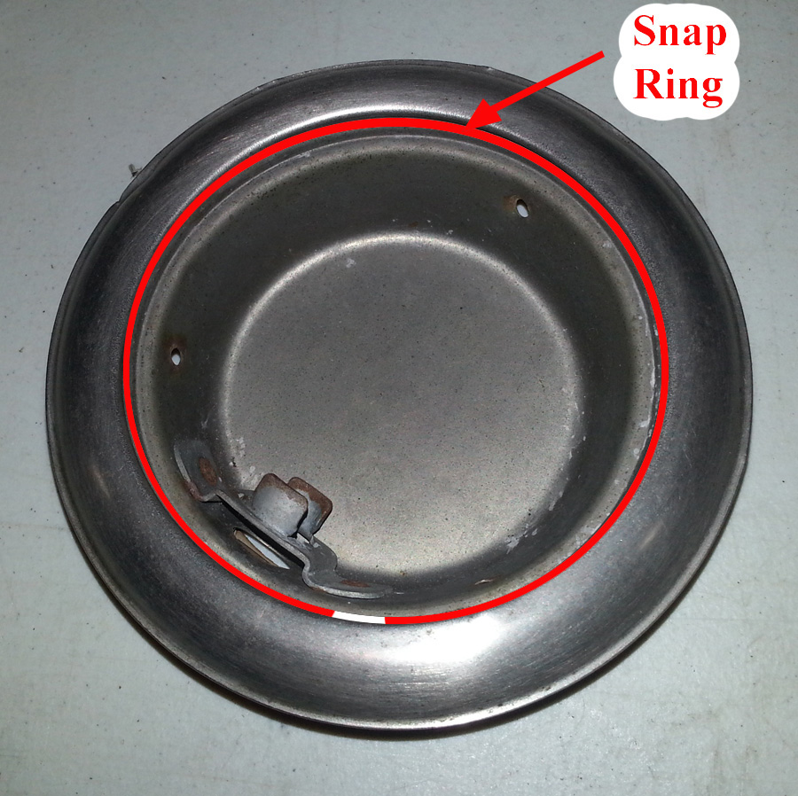

I have a 1936 Ford 2 door slant back . And I found out the Dome light does not work I put the switch up and down and the light does not come on. I am having a hard time trying to remove the glass dome lens to see if it has a bulb in the socket and I can not get the glass dome light to br removed HOW can I remove the glass lens ??

There is a snap ring holding the glass lens in place.

More of a wire clip,get under 1 end of it with an ice pick or sharp awl,will do it. ken ct

I’m having the same issue. I did get the snap ring off. I figured out that much. Now I cannot get the glass out. It is wedged tightly. Any ideas on how to remove the dome light glass? Thanks much.

Stuck glass try a suction cup to pull it down. Slightly warm the glass with a hair dryer.
