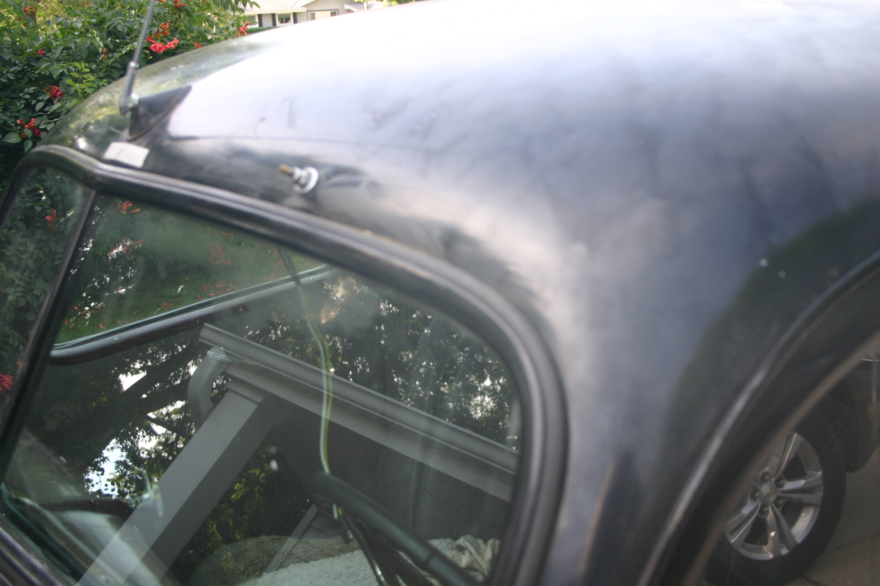

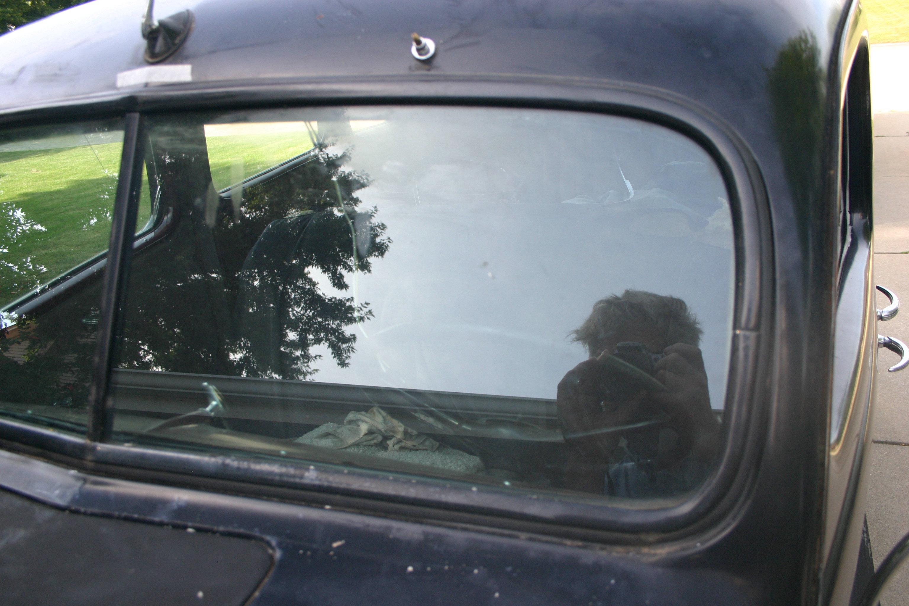

Here is a couple of pictures. In these pictures, I have the upper hinges removed and the windshield seal is against the roof line, not in channel. This seems correct to me, but the hinges are a long way from fitting to windshield. Even with all the adjustment on the hinges and mounting plate moved out. This leads my to believe that the seal does fit inside the channel, that seems to the only way the upper hinges will mate to the windshield and close right. I need to see another car. Mike

Here's another picture.
40cpe
07-10-2018 @ 10:21 AM
Posts: 488
Here is my take on it: Adjust your hinges so the top of the gasket will just barely close into the top of the body opening with the windshield in the out position. I would initially put some rubber lubricant around the gasket to help it slide into the opening. With the top of the gasket snug against the opening at the top and centered side-to-side, the regulator should pull the bottom into the opening. As mentioned above, having the channel that the lip fits into perfectly clean is critical. You might have to get creative and fashion some tools to clean it thoroughly.
