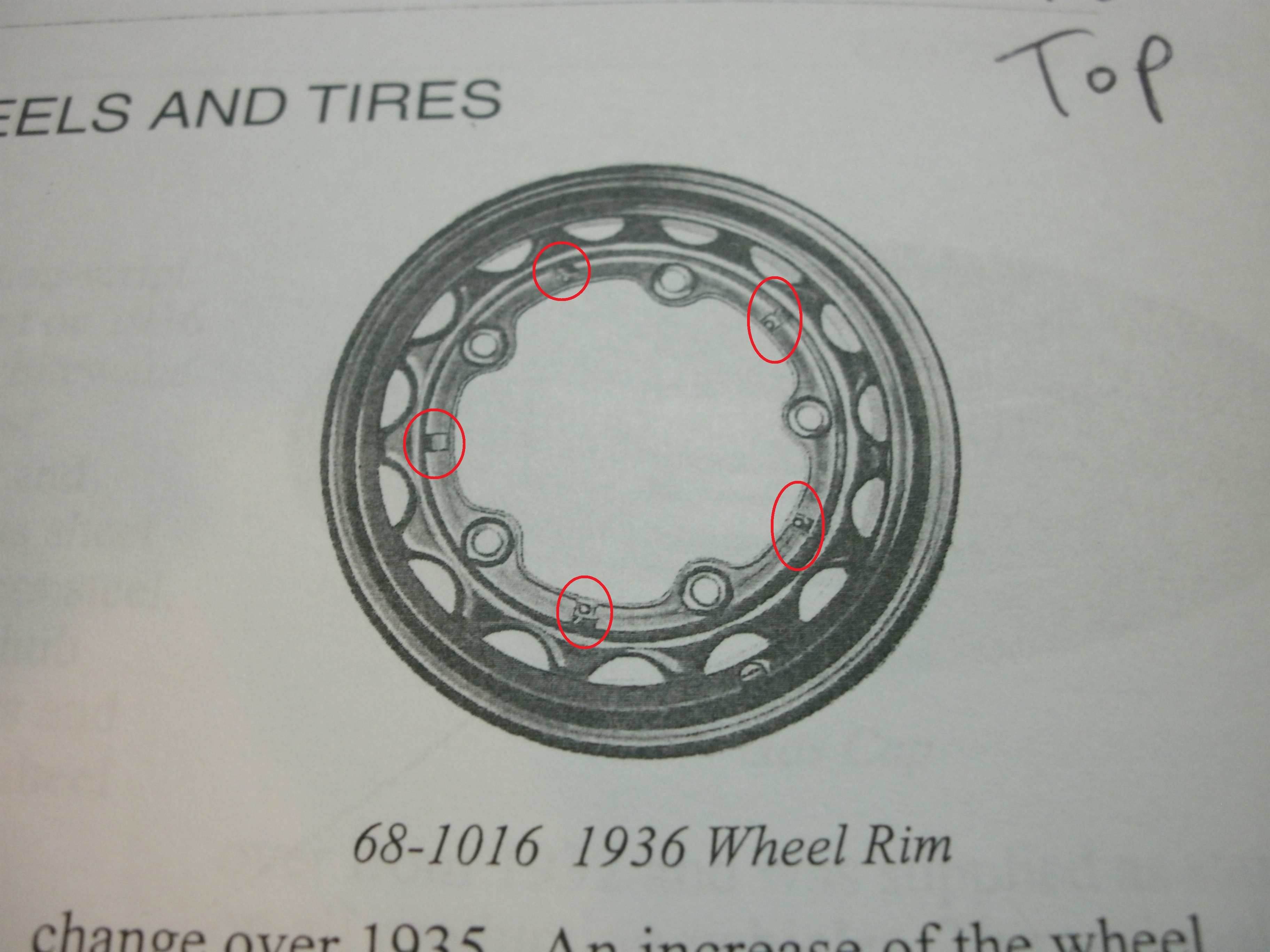

I'm going to try two photos to help. The wheel has five clips, circled in red. These hold the hubcap to the wheel. -VT/JeffH

In this next, I've tried to draw a line between the hubcap and the wheel. Towards the tire is the wheel. Towards the center is the hubcap. Applying your efforts to this zone will reveal the lug nuts. Your next task, to service the brakes, will be removing the rear hubs. Seek the purpose-built tool for this job. Shout-Out to the authors of the club's '35-36 book, for the illustrations. Available here for those that don't already have two or three copies. https://shop.efv8.org/collections/ford-books/products/1935-1936-ford-book-softbound

My God are things easy when you know what you're doing! The cap pried off instantly with my trusty Harbor Freight trim tool requiring very little pressure and yes as Tom pointed out it goes sailing if you're not ready . Thanks you so much for the picture and kind explanations ! What a great community , a man in Iowa a fellow Watts read my plight and actually called me shortly after my post explaining as well the 5 clips and their location etc so thank you Mr Watts as well! Bob
