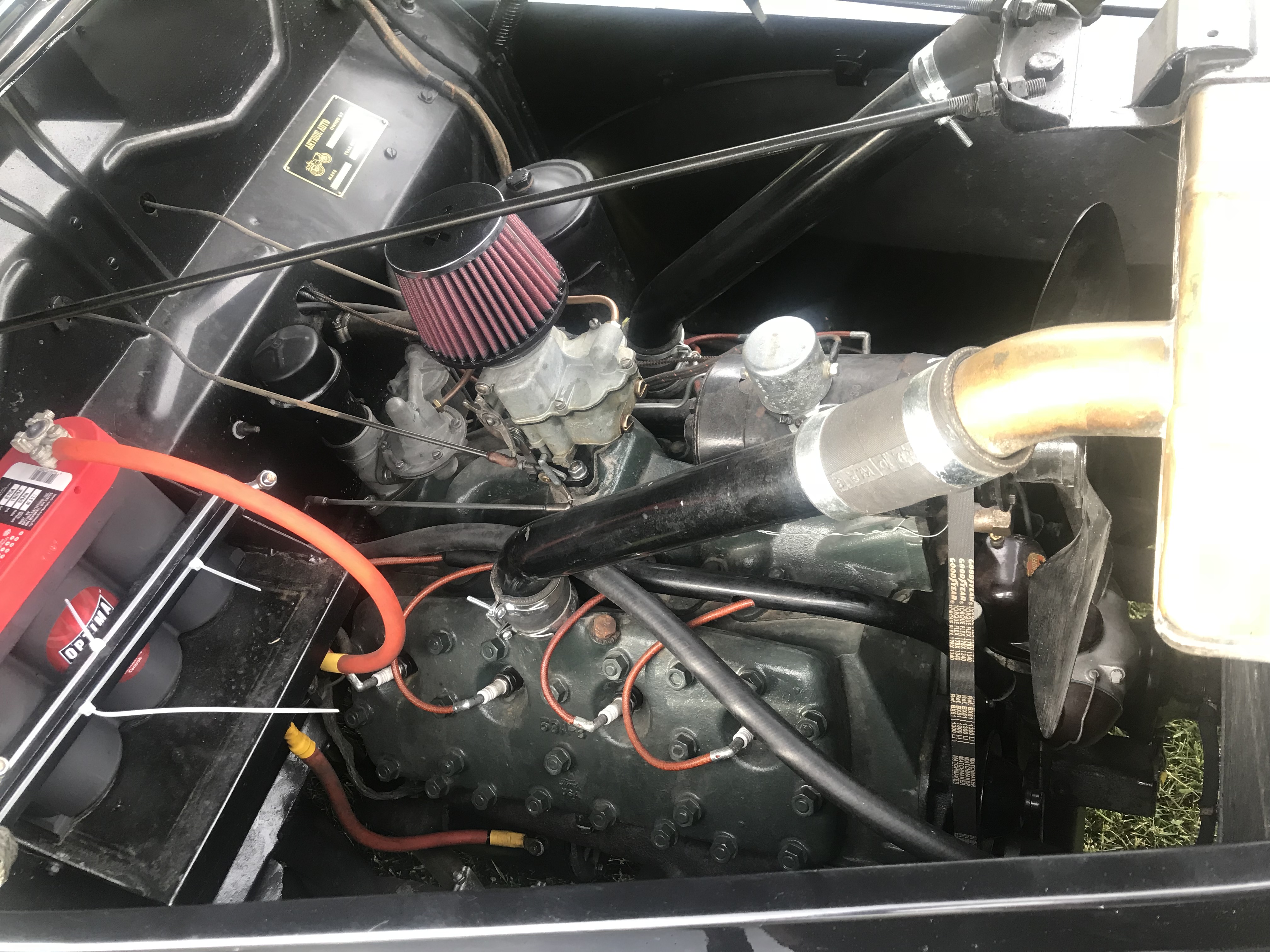

Hi guys n' gals!
I have a completely restored 1939 pickup here in Finland. I didn't do the restoration my self, so my knowledge on this car is not as wide as it should.
The problem is that when I go out for a drive, I can get as far as around 6-8 miles and the engine stalls and stops. After, I just pump the gas pedal and push the start button. While starting I keep on pumping the gas and at the same time I pull on the choke and I get the engine running, but just barely. After I get it run just so and so, I have to do tricks with gas pedal and the choke at the same time and it runs for a half a mile or a mile and does it again.
Fuel pump rod is in accurate length, it moves the accurate amount up and down, there's no leaks anywhere and the glass cup doesn't collect anything, nor does an extra filter in the rubber line before the cars own pump. Cars own pump works all fine too.
I swapped the original air filter to a K&N, since the original oil bath filter has few bangs here and there and I'm not really shure if it works the way it should.
Everything is rebuilt or new.
...help...
