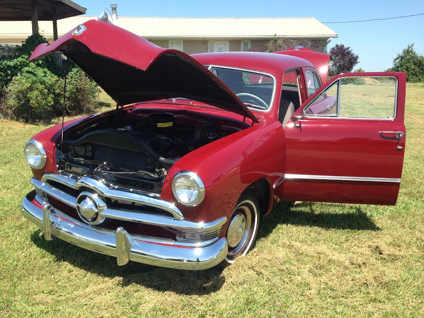

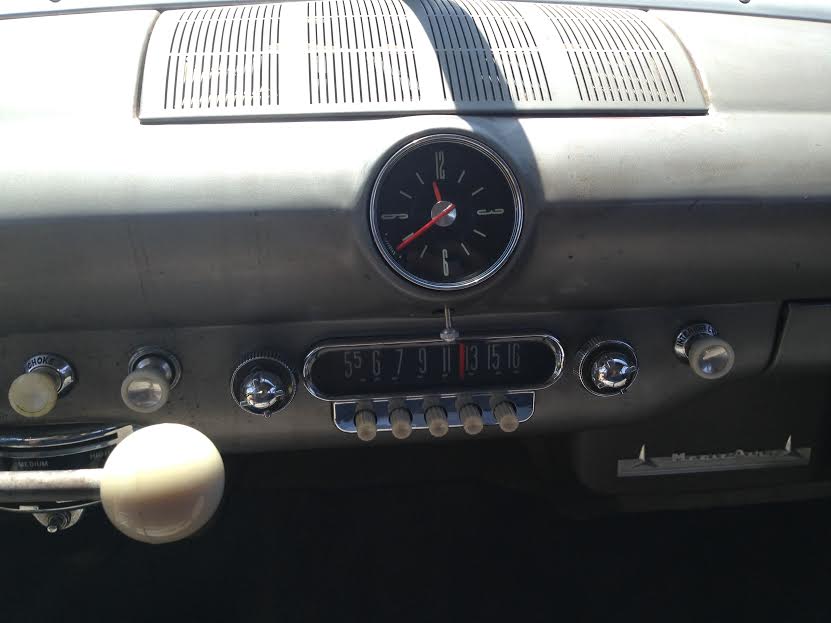

You all probably know Randy Rundle at the Fifth Avenue Garage in Clay Center, Kansas and his 6V alternator for old Fords and other classic cars. My question to you is this: If I install one of Randy's 6V alternators I have to change from positive ground to negative ground, so how will that affect my dash clock and stock tube radio in my 1950 Ford Custom Fordor?
Any help and advice will be greatly appreciated.

It won't affect your original tube radio as long as you still have a mechanical vibrator in it.
