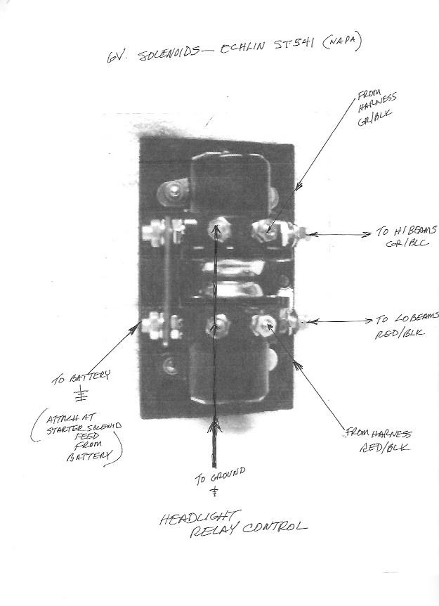

I agree with my friend TomO. The dimmer switch is located on the road side of the floor panel where it is exposed to the elements. I did try to rehabilitate mine but it wasn't successful. I'm still seeking my info on the relay panel. Seventy years as an old car enthusiast has produced two file cabinets of clippings, notes, and diagrams. I have posted it before.
I have attached a small version. The small panel is mounted on the left front side under the hood near the junction where the headlight wires branch out. one set feeds the high beam, the other the low beam. I used some bullet connectors so if desired to have the car judged, the panel can be removed and the original wiring put back.
I have noted on the photo where the battery and headlight wires are attached. Over the years I have been asked why I use starter solenoids instead a separate relay. The answer is that finding a six volt DC relay is difficult and expensive.
The solenoids are available at NAPA. I also use them to control the top of my convertible. My car is a "driver"so I save considerable cost and time trying to locate hard to find parts that are now unavailable by designing my own.

If you have dim headlights, installing halogens usually will not help. I installed halogens in my '47, as the headlights were still too dim to drive after dark, but they made no difference. Tracing the headlight circuit all the way from the battery, I found only a fraction of the power made it through the system. That path goes through the dash switch, the dimmer switch, and lots of the "bullet" connectors. Replacing all of these parts of the system is one cure, but instead I designed a simple relay board controlled by the original system that provides full power to the headlights. Now, my headlights are as bright as modern cars. If anyone is interested I will try to post the details. LEDs draw much less current than halogens, and older vehicle's charging systems may not be up to the task for halogens.
