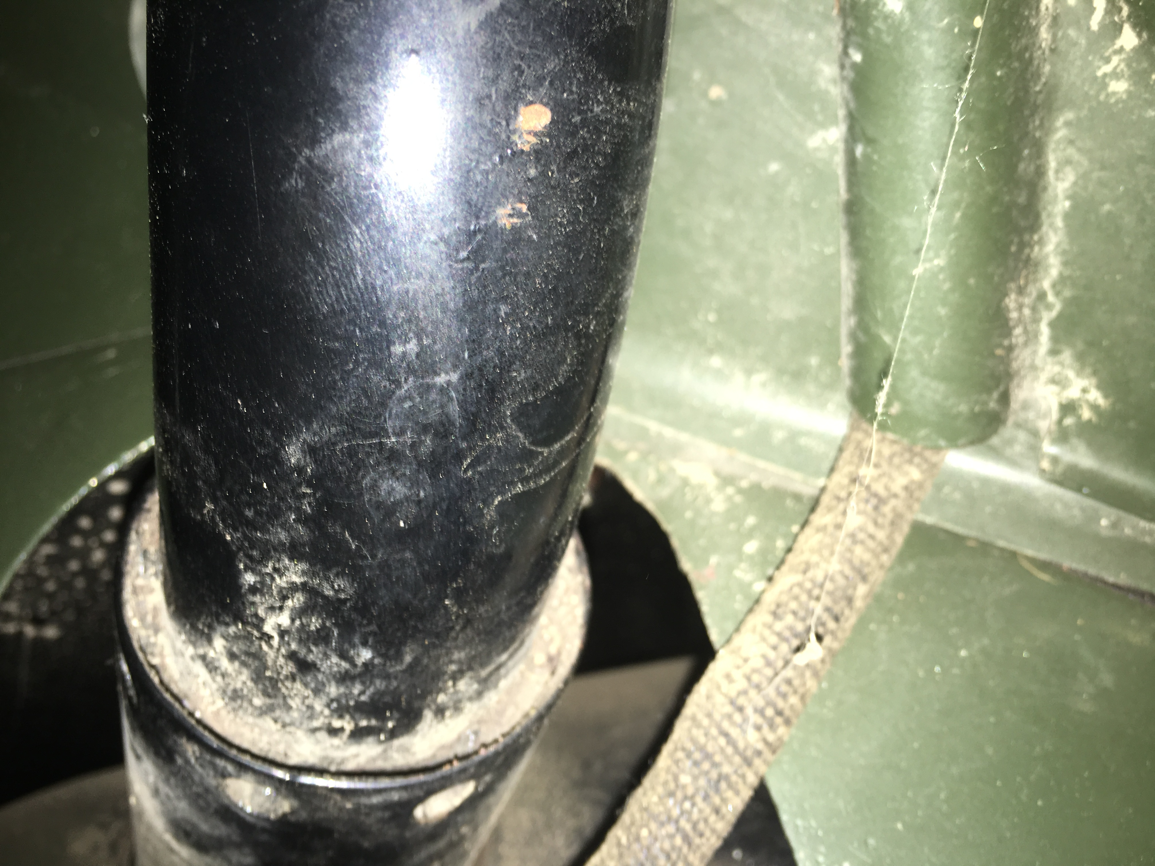

I have done this many times, there is no need loosen or lift the body. The tank can slide out with a lot of wiggling on your part. In some cases you may need to loosen and drop the exhaust pipe. However, before you do anything you MUST remove the filler neck. These are scr*w*d into the tank. Unfortunately, these things get rusted to the tank and can become a real nightmare to remove. At the very minimum you should try to use a spanner wrench to remove and reinstall the neck. Note the picture.

As long as the neck is off and everything is disconnected it should come out. Just for safety sake I would remove the gas tank pickup assembly before removing the tank.
