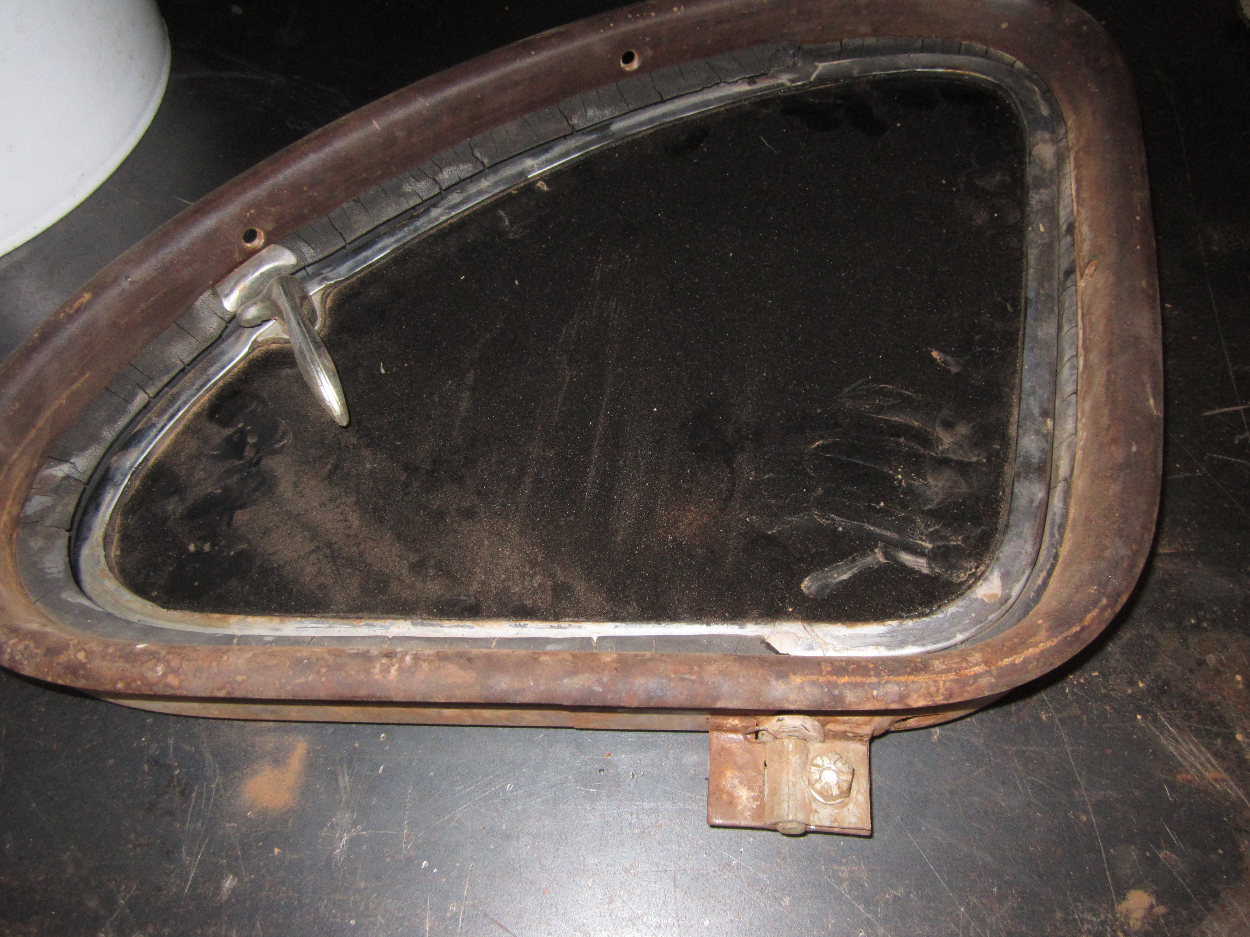

The Tudor window may be different from mine. To remove mine I just removed the screws that hold the garnish molding in and then had to bump it a bit with a rubber mallet to loosen it up. It all came out intact. I went further and removed the glass from the molding so I could have it woodgrained. The rubber gasket crumbled off. I have more pics and measurements if you are interested. Gregg
