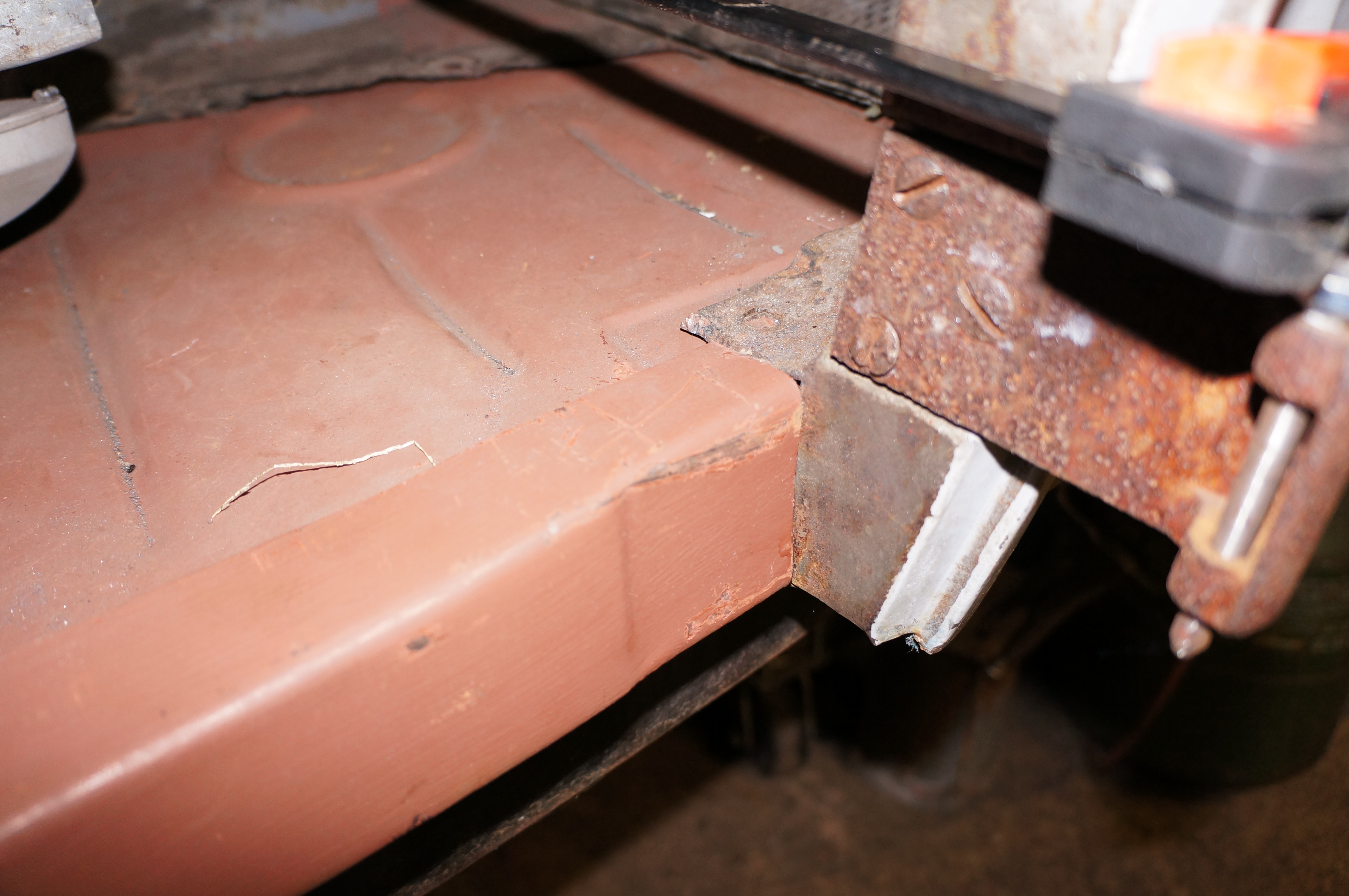

I need to replace my driver side rocker panel and have found a handful of floor pan spot welds. Other than the A & B pillar supports, are those the only floor/rocker attachments?

My rockers are spot welded and welded to the a&b pillars, i think Kube would know more than i do.
