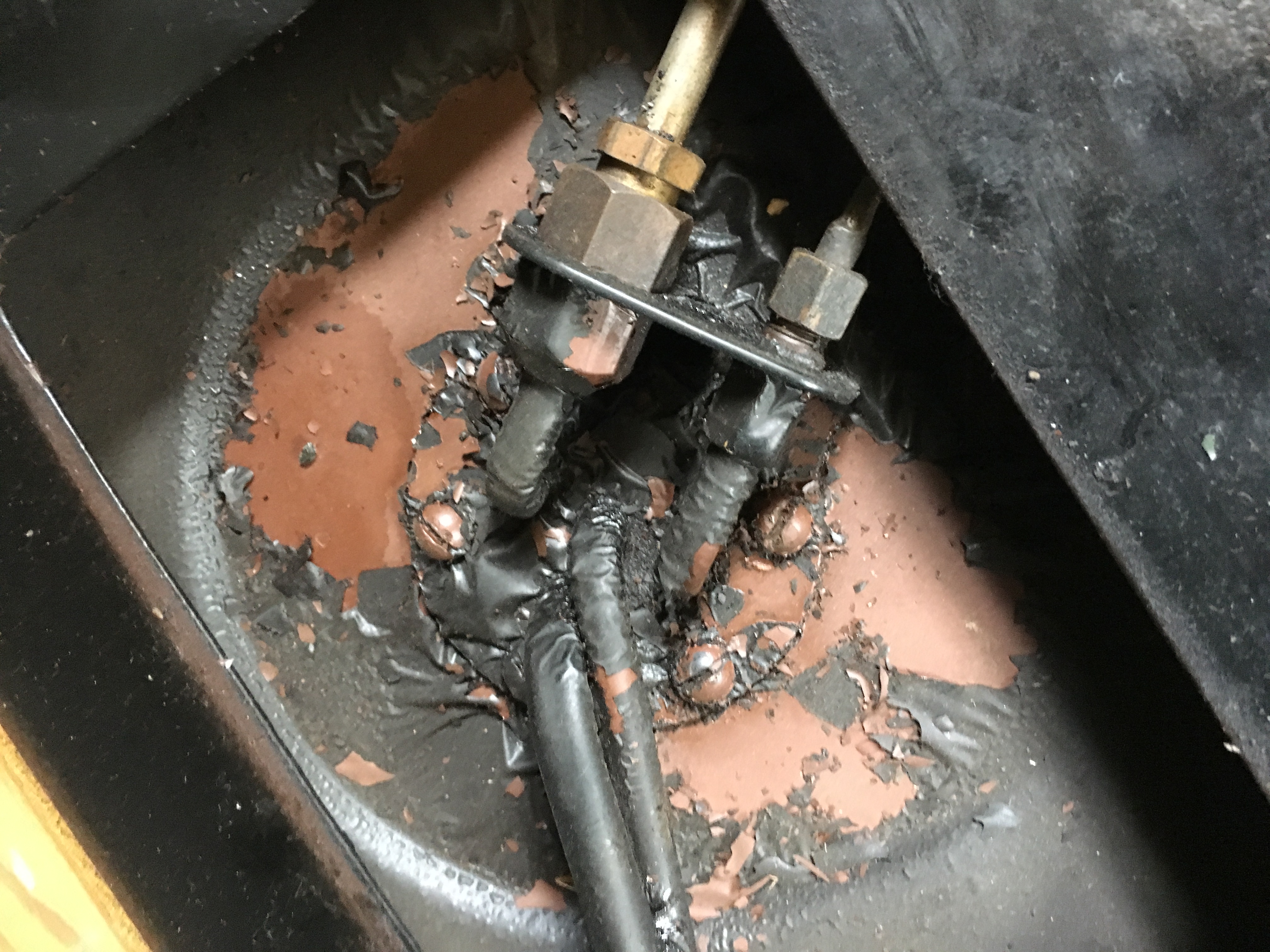

Is the fuel gauge mechanical? I do not have any wires from the sending unit to the gauge.
Does this look correct?

It's called a hydrostatic fuel gauge. It's not electric. It uses a sender in the tank to transmit air pressure through a line to the gauge, which moves fluid up and down in the glass sight tube. Ford used this type of system through 1935....

Thanks for your response. Question, looking at the photos does the set up look proper?
Do you have any suggestions regarding troubleshooting the system.
Lastly, I understand the oil pressure gauge and the fuel gauge are separate. Both of mine are out is it possible that one failure interferes with the other?

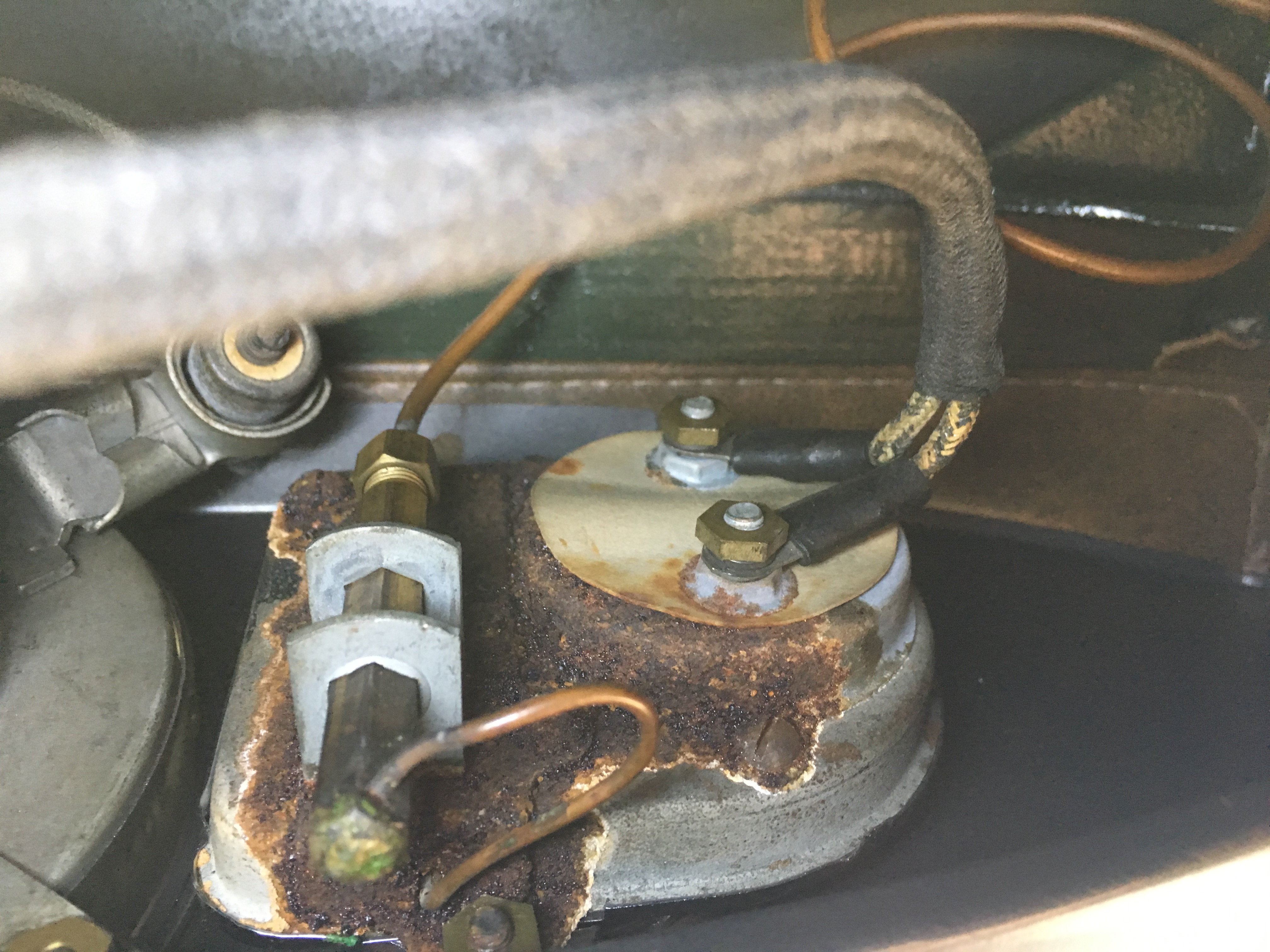

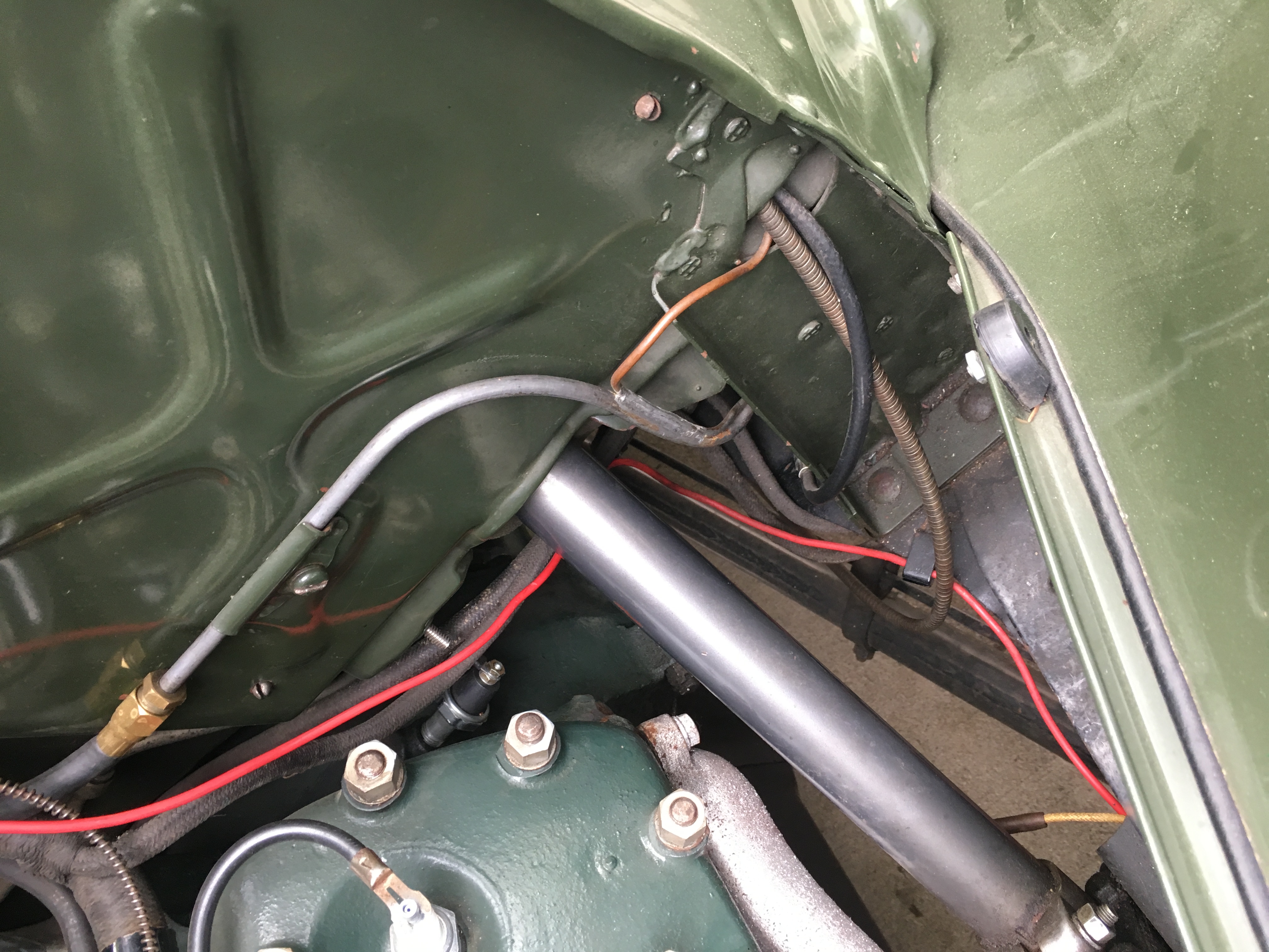

I wish you would have taken a picture of the front of the gauges. Your fuel gauge will not interfere with the operation of the oil pressure gauge and vice-versa. Your oil pressure gauge is hooked electrically to a sending unit on the backside of the block - drivers side. I don't have the expertise to advise you as to troubleshooting the fuel gauge. As for the oil gauge, the sending unit might be bad or you might have a problem with the electrical connections or the gauge itself might be faulty.

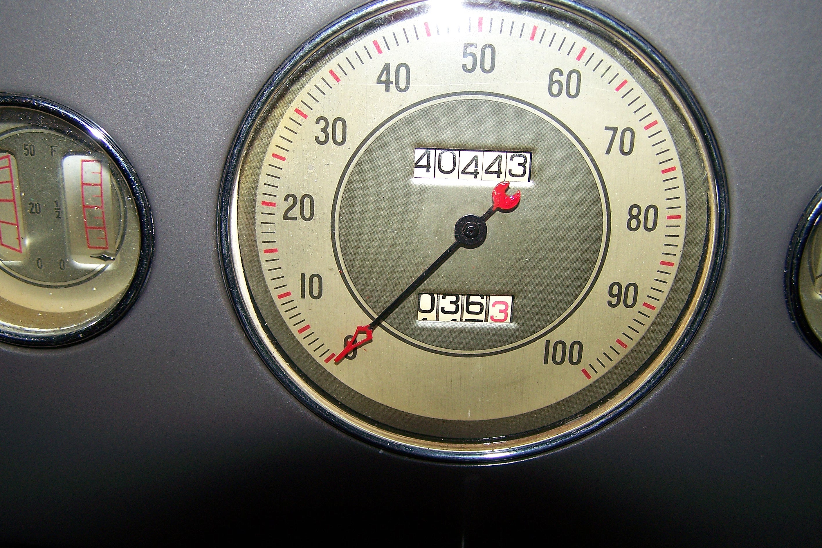

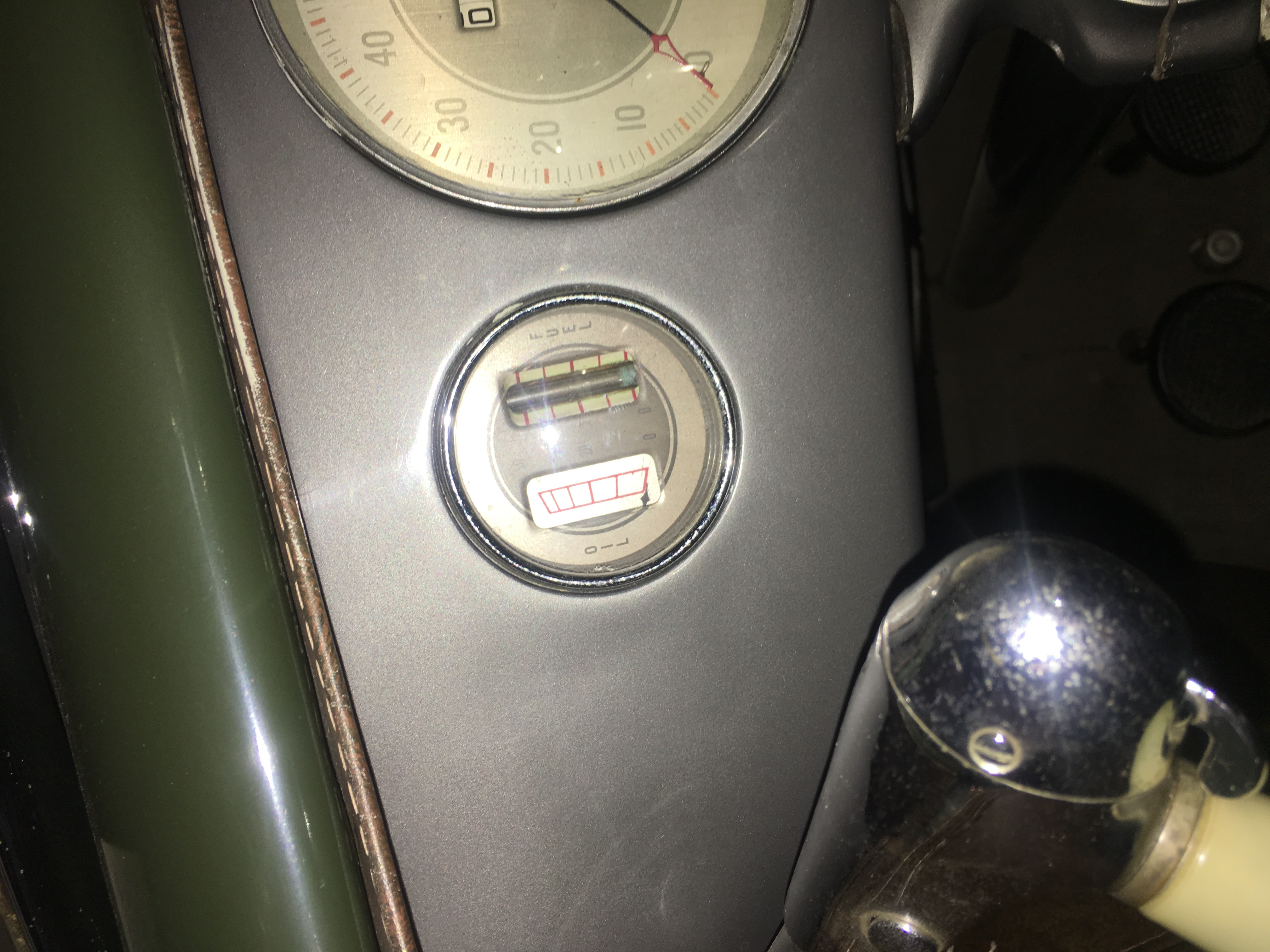

Front of gauges

It looks like you have a real mess on your hands. Unless you are going for a 1000 point car, have you given any thought to switching to a '36 fuel gauge (all electric) and tank? If you plan on doing any serious driving you will be glad you did.

In the second picture you posted you can see the oil pressure sending unit with wire connected to it just below the red wire. I've never seen a sender like that but that doesn't mean its not correct. Looks like the primary problem is the excessive corrosion on the back side of the gauge. Doesn't appear to be any red fluid in the gas gauge. You will have to remove the gauges for repair.
You might want to try this vendor to repair your gauges > http://www.classicandexotic.com/store/c-85-king-seeley-hobson-fuel-gauge.aspx
