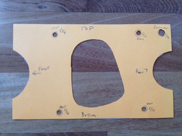

If your 37 frame has not been altered there should be a large circular hole through the center of the frame where the original pedal assembly was attached. There should also be four 5/16 holes (one on each corner) at the top and bottom of the frame rail.
In order to use the 39 pedal assembly the large circular hole needs to be enlarged and reshaped and additional 5/16 holes drilled. I have a template which shows where the holes should be drilled and how to reshape the large hole. I'll send you one if you want. My e-mail is bandjlewallen@gmail.com
