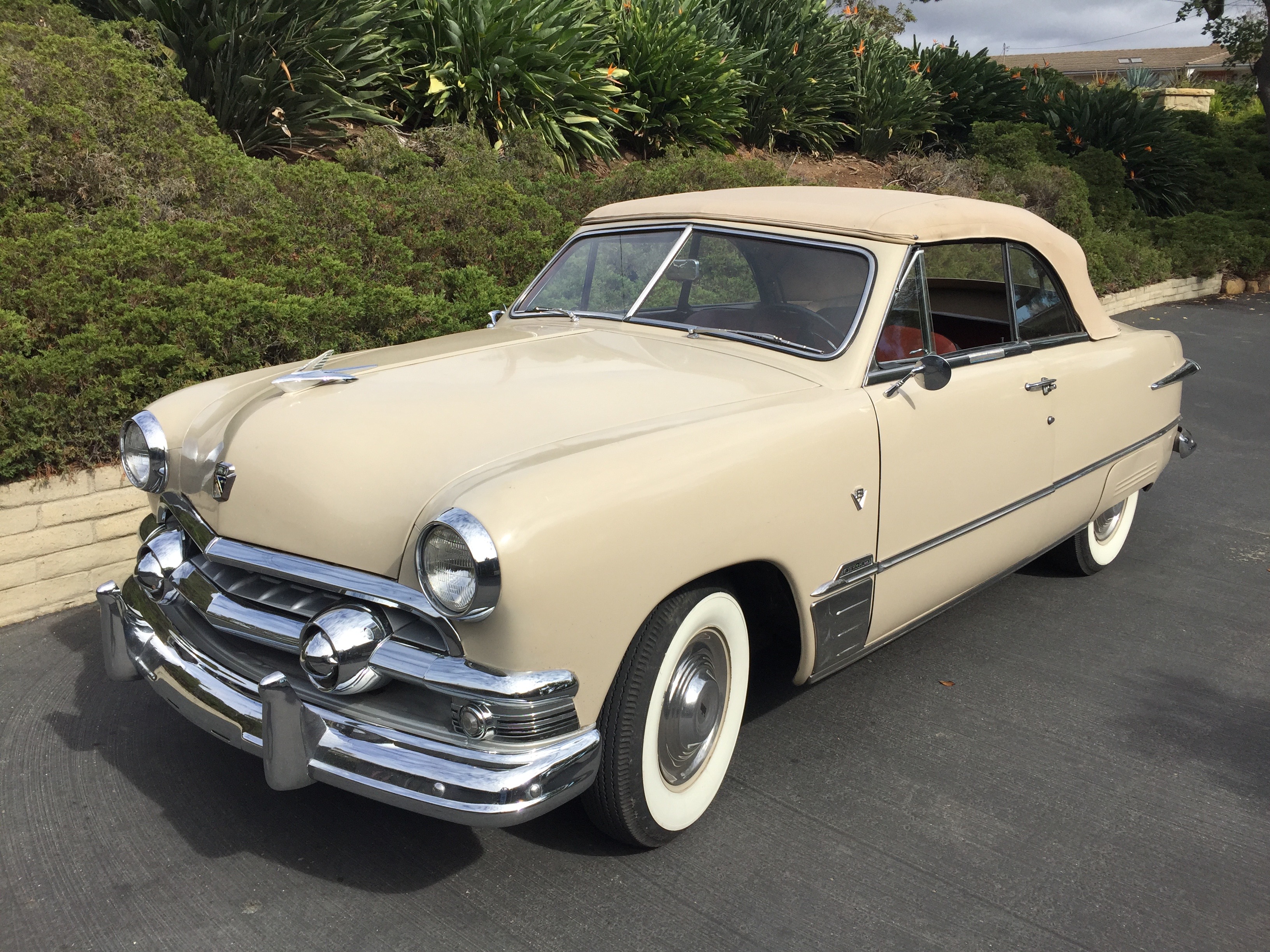

deluxe40
05-06-2018 @ 3:30 PM
Posts: 413
Check out eBay auction #282950570724 . It's a Sandpiper Tan (R code) '51 Victoria with a Hawaiian Bronze Metallic (K code) top. Also, just for good measure here's a picture of a Sandpiper Tan '51 Convertible.
