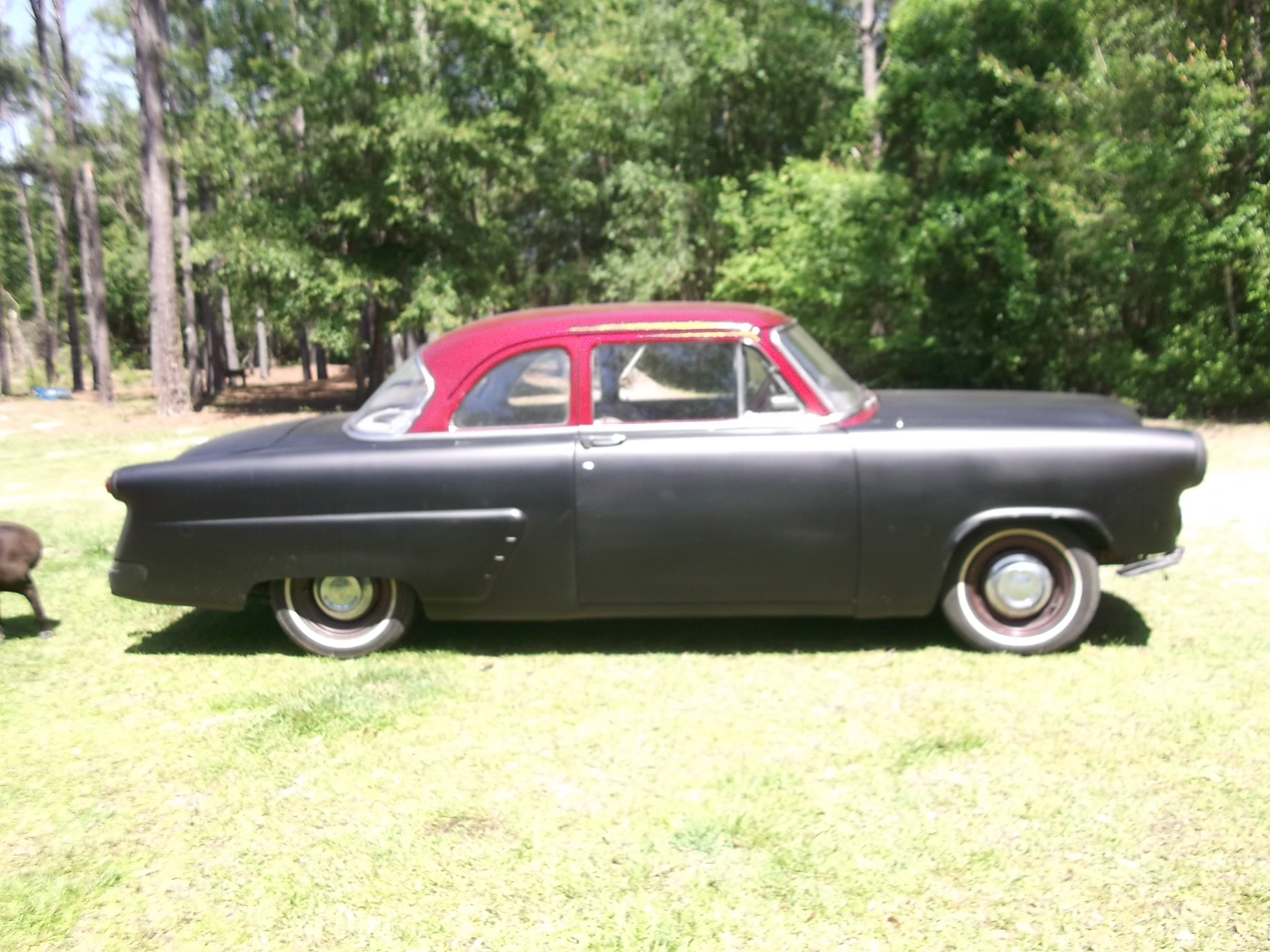

recently bought a nice 1952 Ford Customline 2dr sedan, V8 with twin Ford Carbs and Edmunds intake.
engine runs great. however have problem with RF. thought it was a tire needing balancing, so I had it balanced, no change; so I switched left to right to left and no change. about 40mph it feels just like a tire out of balance, gets worse at 45mph (and I have not went faster). almost new tires. any ideas?
