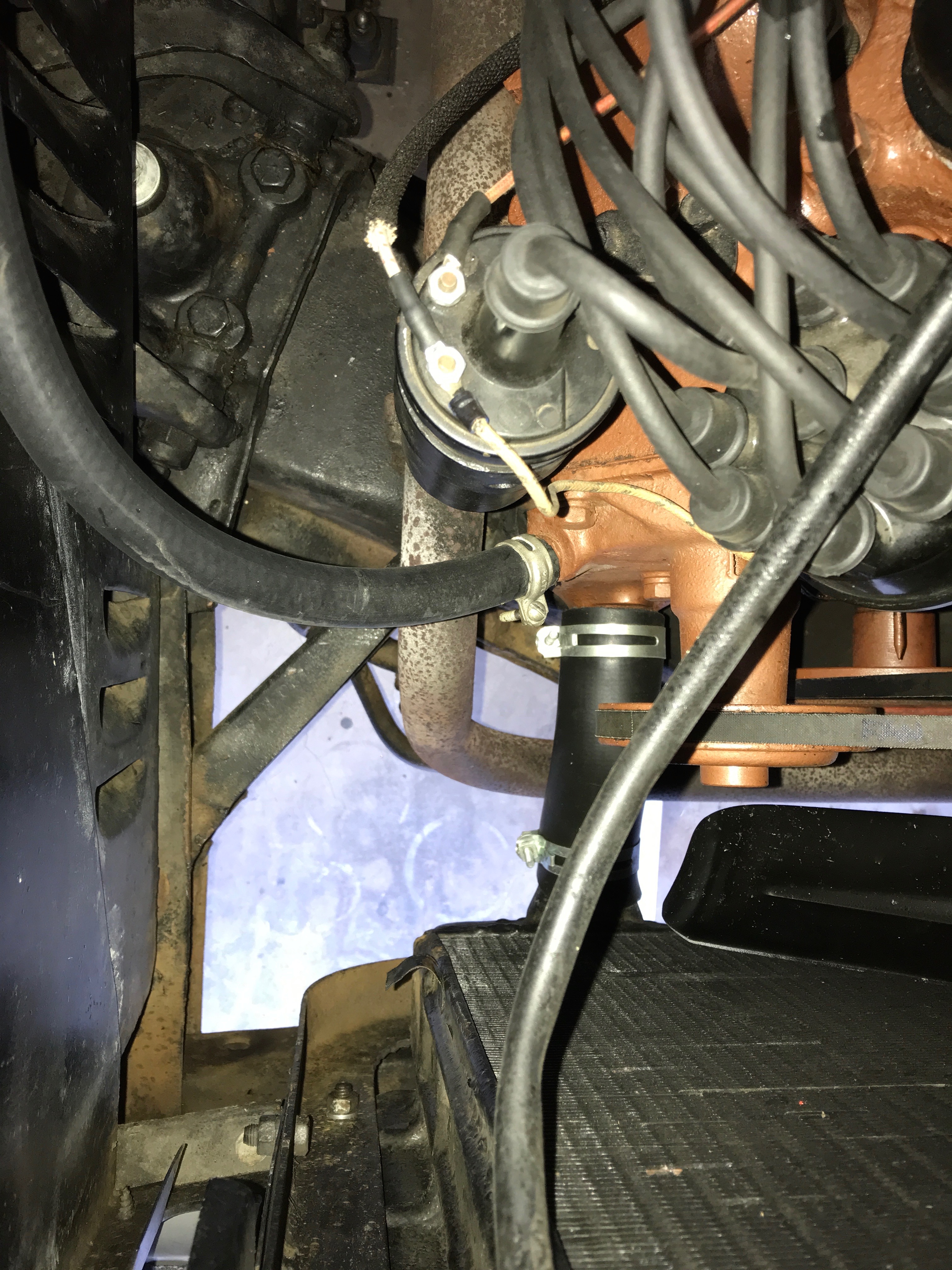

Here's a picture to get you in the right neighborhood. You can just see traces of the serial number along the top edge of the brace running from the side frame rail to the front cross member. Scr*pe lightly because the numbers are not deeply stamped.
