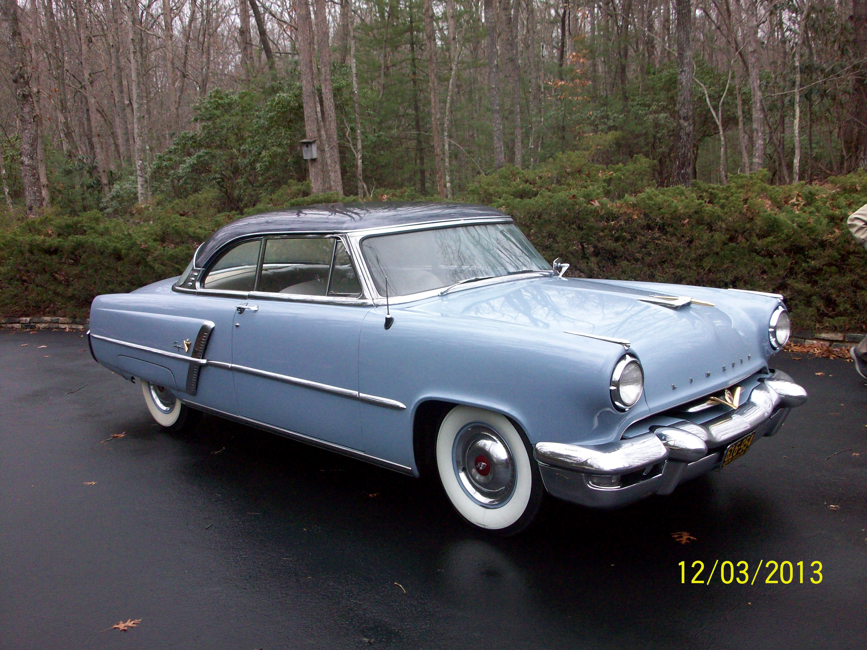

Those paints were enamel. I used Mequires Fine Cut Cleaner to bring the shine back to my 53 Lincoln. The paint was in very good condition to begin with, so if yours is very dull, you may not be able to bring the shine back.
Enamel has a surface layer that provides the shine, once that layer is worn through, you cannot get a good shine on the car.
Here is a photo of my Lincoln as I purchased it.

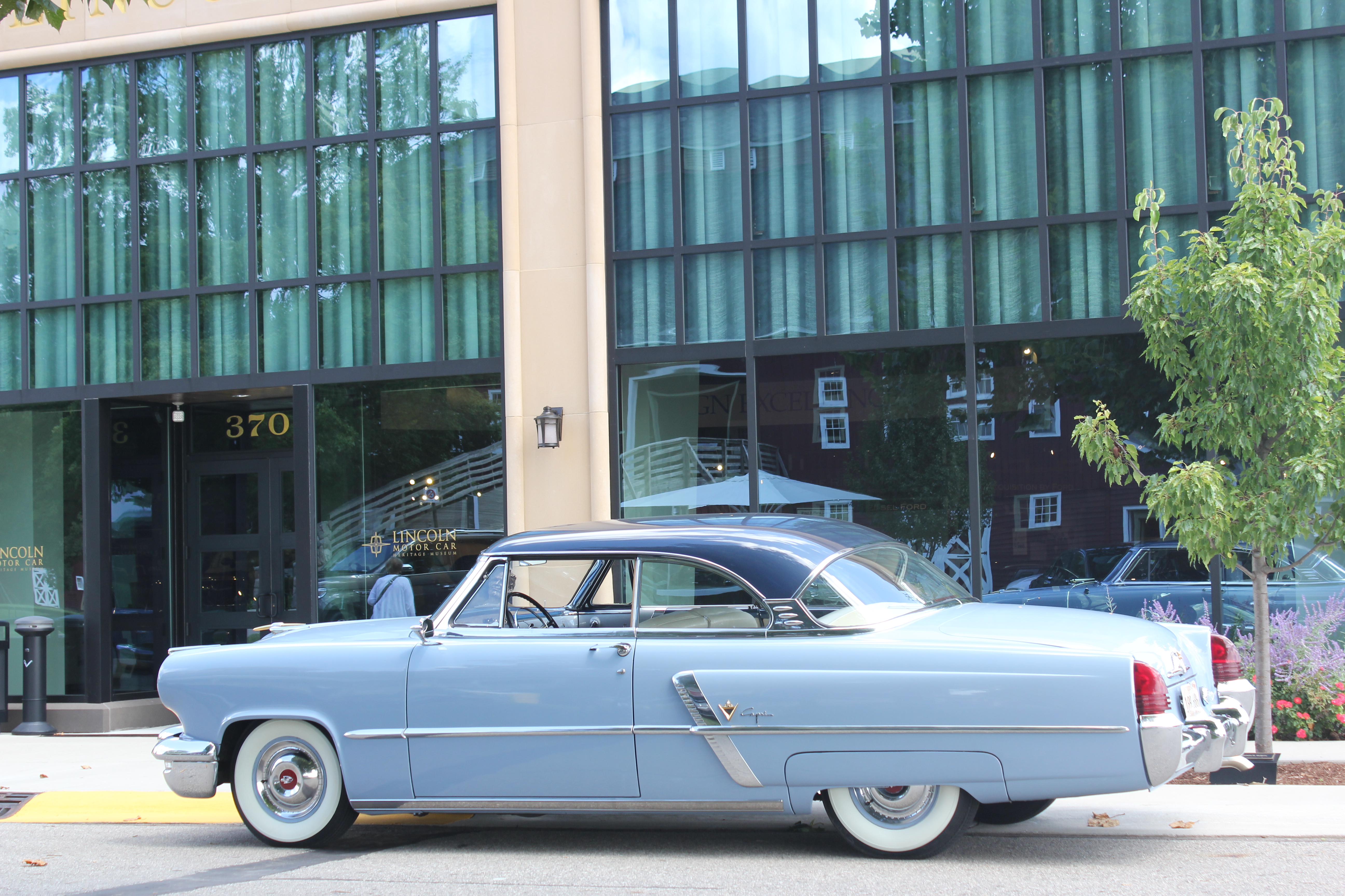

Here is a photo take last summer

That is one GORGEOUS Lincoln!! You can be EXTREMELy proud of it. and I know you are!! I'd love to see pics of the interior and motor!! (and so would everybody on the forum!!)

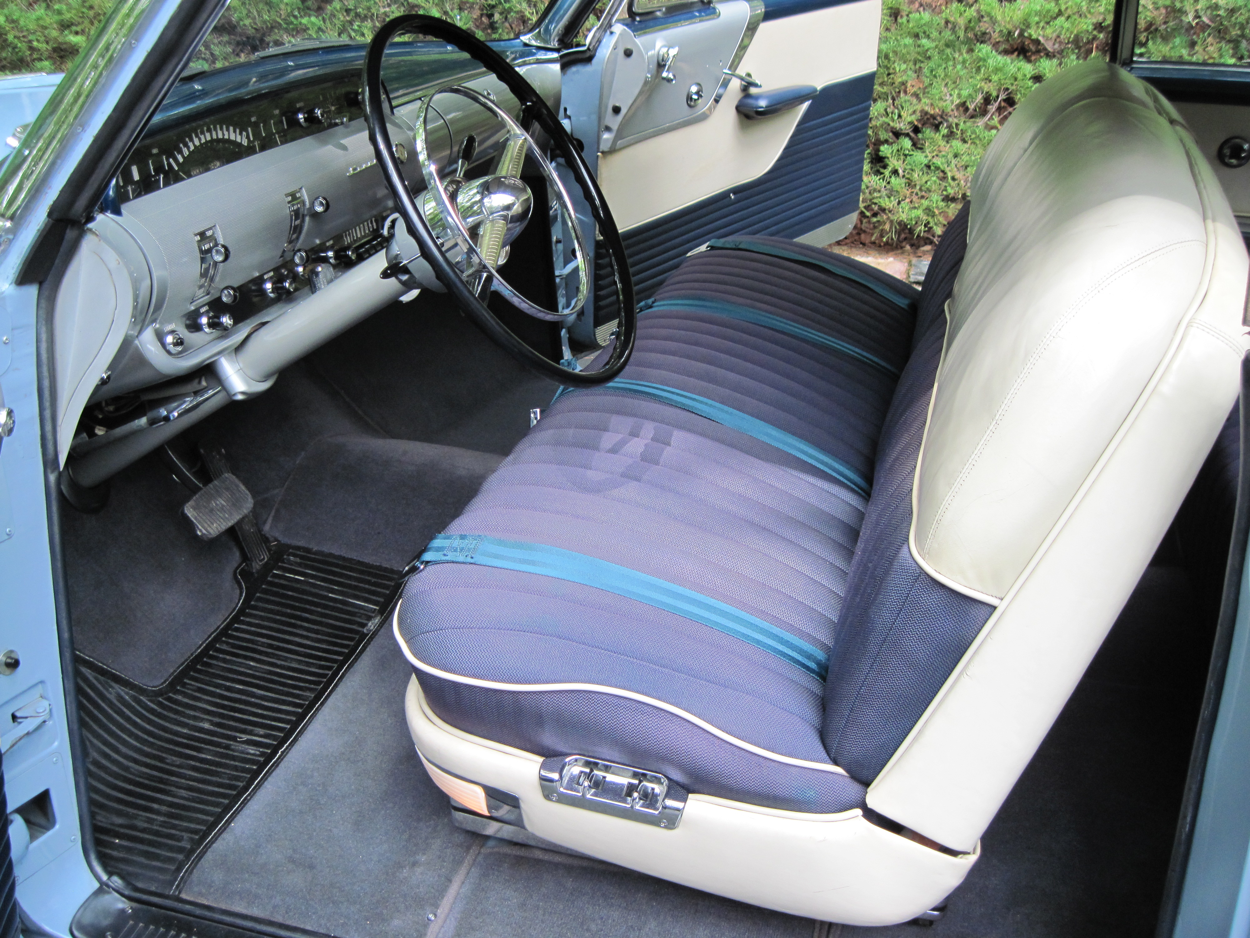

Thank you for the compliment. You can take your own photos at Auburn in 2019.
Here is a teaser

All I would do is a good machine polish and wax. Your car is beautiful as a survivor and I would be proud of that fact.

artron9 did not post a photo of his car.
That is my Lincoln and I was trying to demonstrate that you can get a very good shine without using a machine polish. Most machine polishes are more aggressive than paint cleaners. Clay bars are good for removing bugs and other debris that get embedded in paint, but they do not remove the oxidation like a cleaner does.
Now that my car shines nice, i just use Meguiar's Wash and wax to keep the car clean and every other year, use the Cleaner wax followed by Yellow Wax. My daily drivers get that treatment more often.
