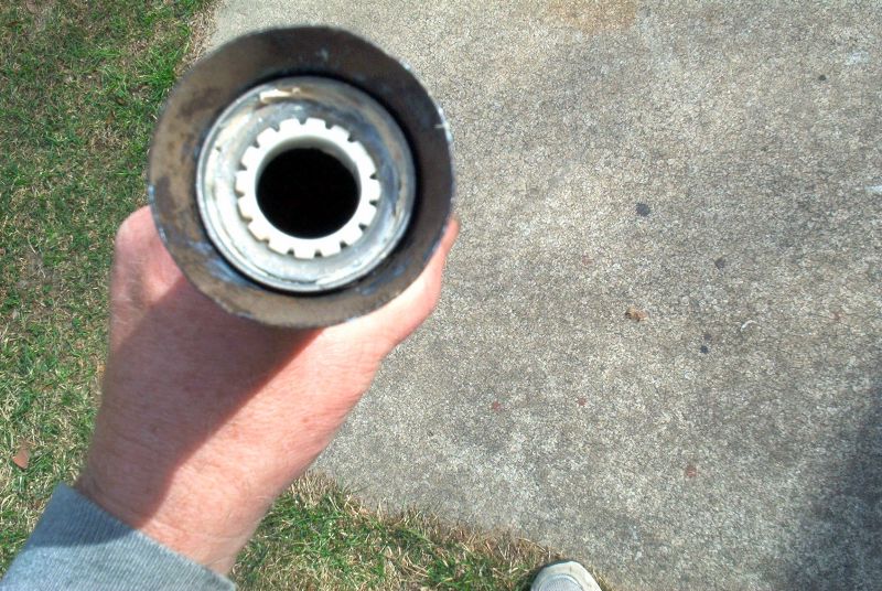

I can't comment on Dan Bruseard's bearing. However, I have a modern Ford 2-part assembly( C3DZ-3517A and B1AZ-3518A), in my '35 and '36. It is a perfect fit. The change in effort is remarkable and the cost (at the time), was much less than $10. Note the picture..

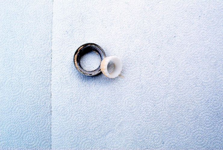

Additional picture-

X2 for Dan Brusgard's bearing. Did mine 20 yrs ago and still good. Very easy to install,you will be a happy camper. Other one looks like it rides in a nylon core. ken ct.
