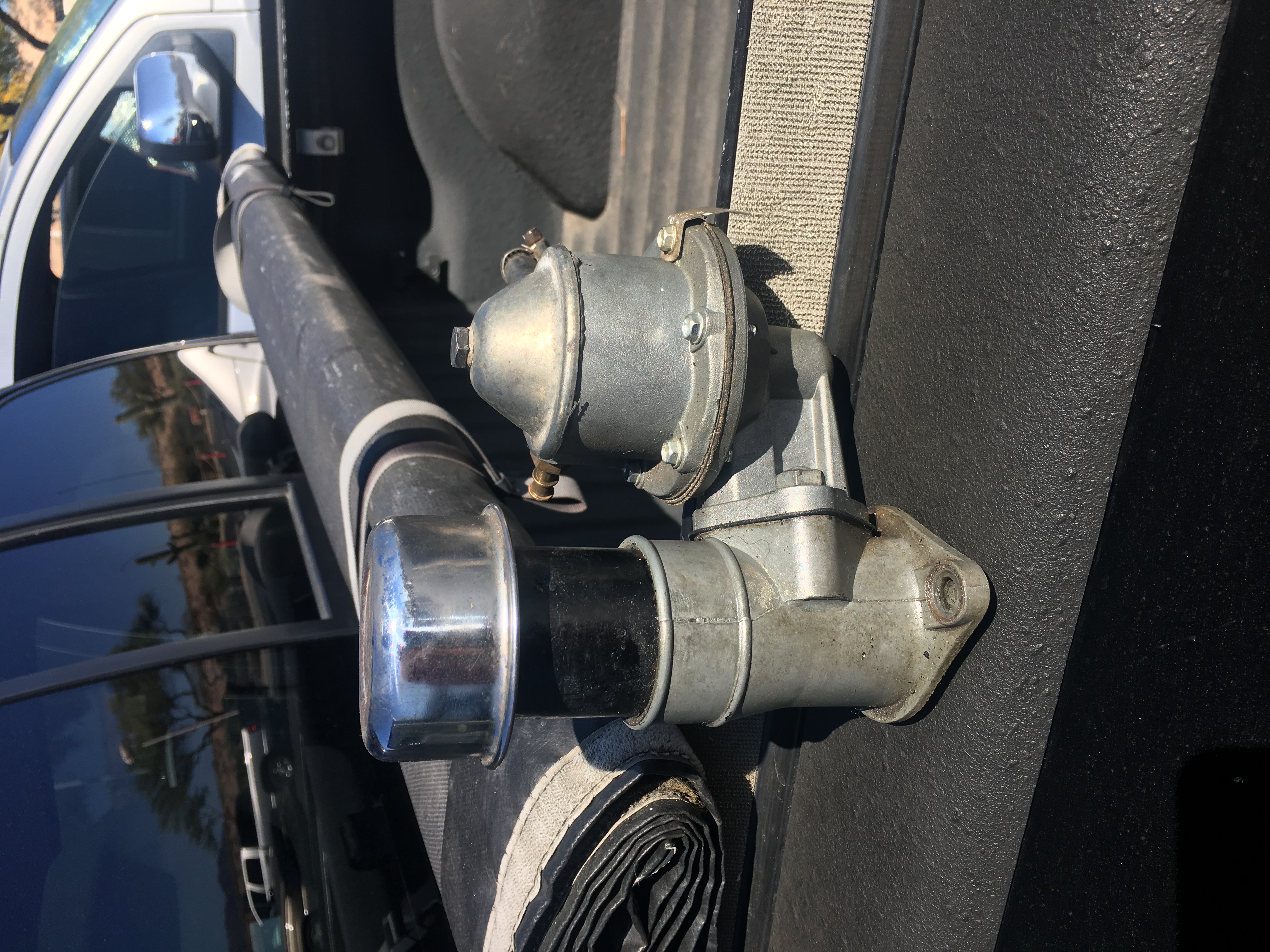

Where may I find a a fuel pump rebuild kit for my 36 Flathead?

I need to see other side of pump. Late 36 pumps are 2 1/4" (bowl diam.) Early 36's are 2" diam. Both have diff internal parts. ken ct.
