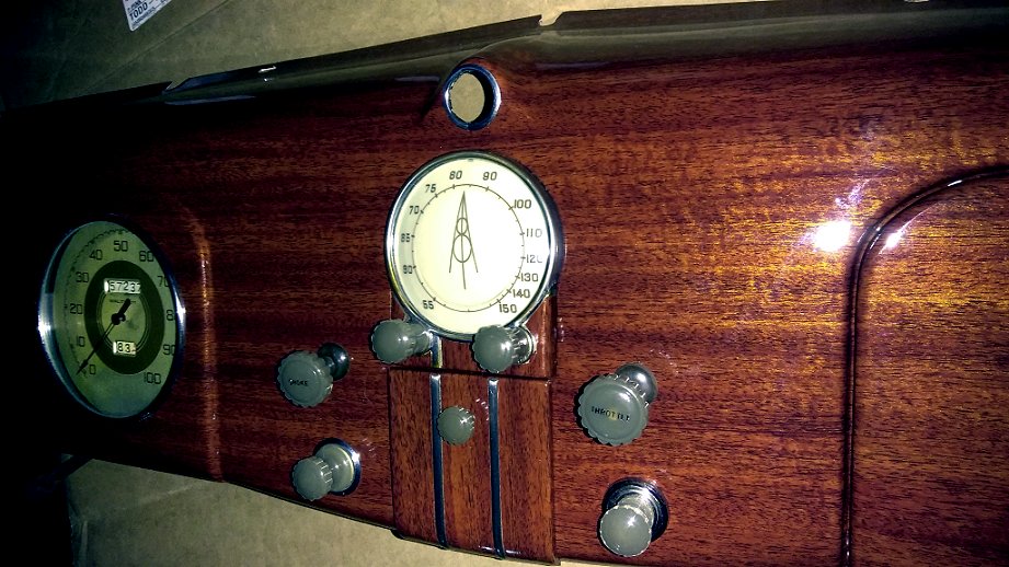

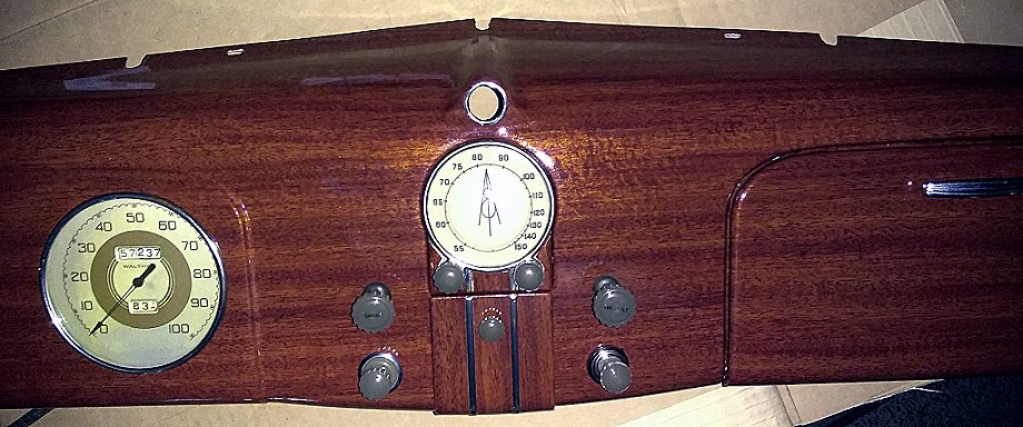

Hydro-dipping is not very expensive if doing it yourself. You can buy a complete kit with enough product/materials to do an entire car (dash and all window moldings) for under $200. I got my kit at www.mydipkit.com and it has been working out quite well as I restore my 34 Fordor Sedan. There is a learning curve so you will waste some materials at first, but the end product is so beautiful, and there are tons of videos on youtube to help. Here is a pic of my dash done in burlwood dark maple, the picture is not that great but believe me the finish is extremely nice with the buffed/polished clearcoat, and the pattern and color is a very close match to original.

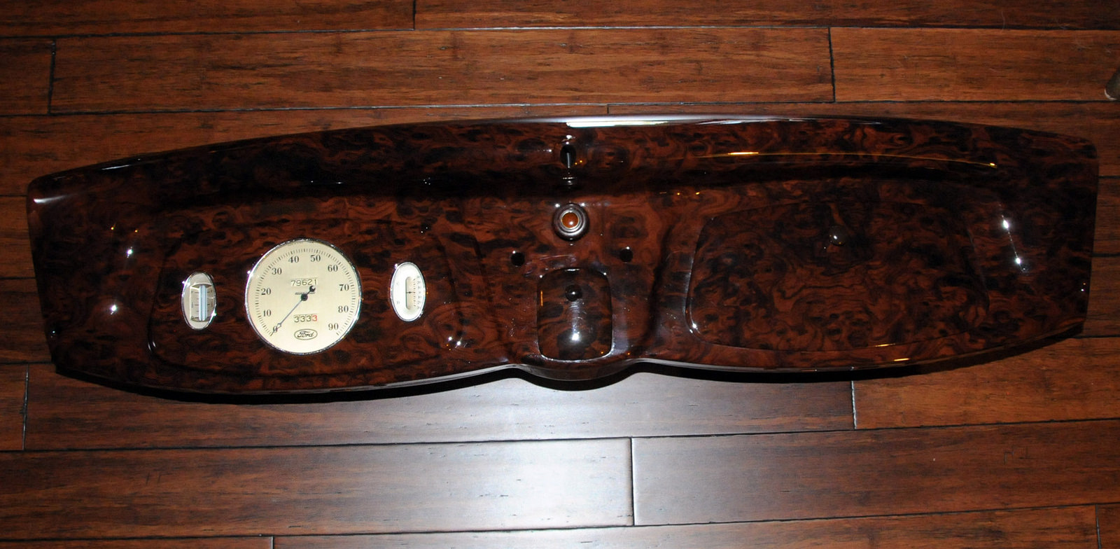

I did my '65 Falcon dash with hyro-dip carbon fiber, it came out nice. I used the Di-Noc on the '37 because it is tough stuff. You can throw rocks at it and it won't hurt it.

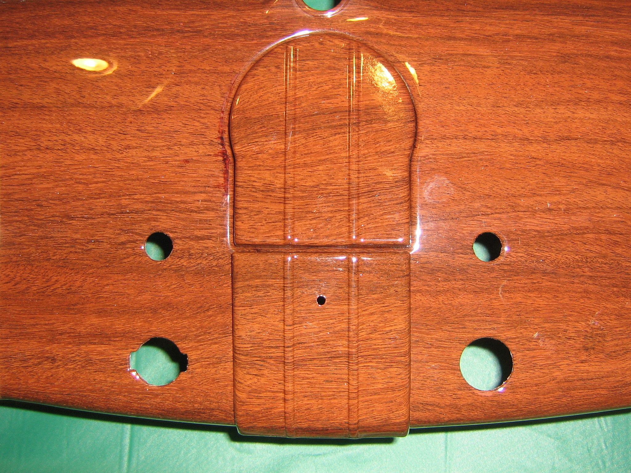

mine was done by a process called " hydro-dip". You have a tank of warm water big enough for the part you are doing. Lay the sheet of wood grain on the water. spray the activator on and slowly dip the part in. I checked Grain It, to expensive to experiment with. The shop that painted my car included it with the paint job. I'll try to post pics
