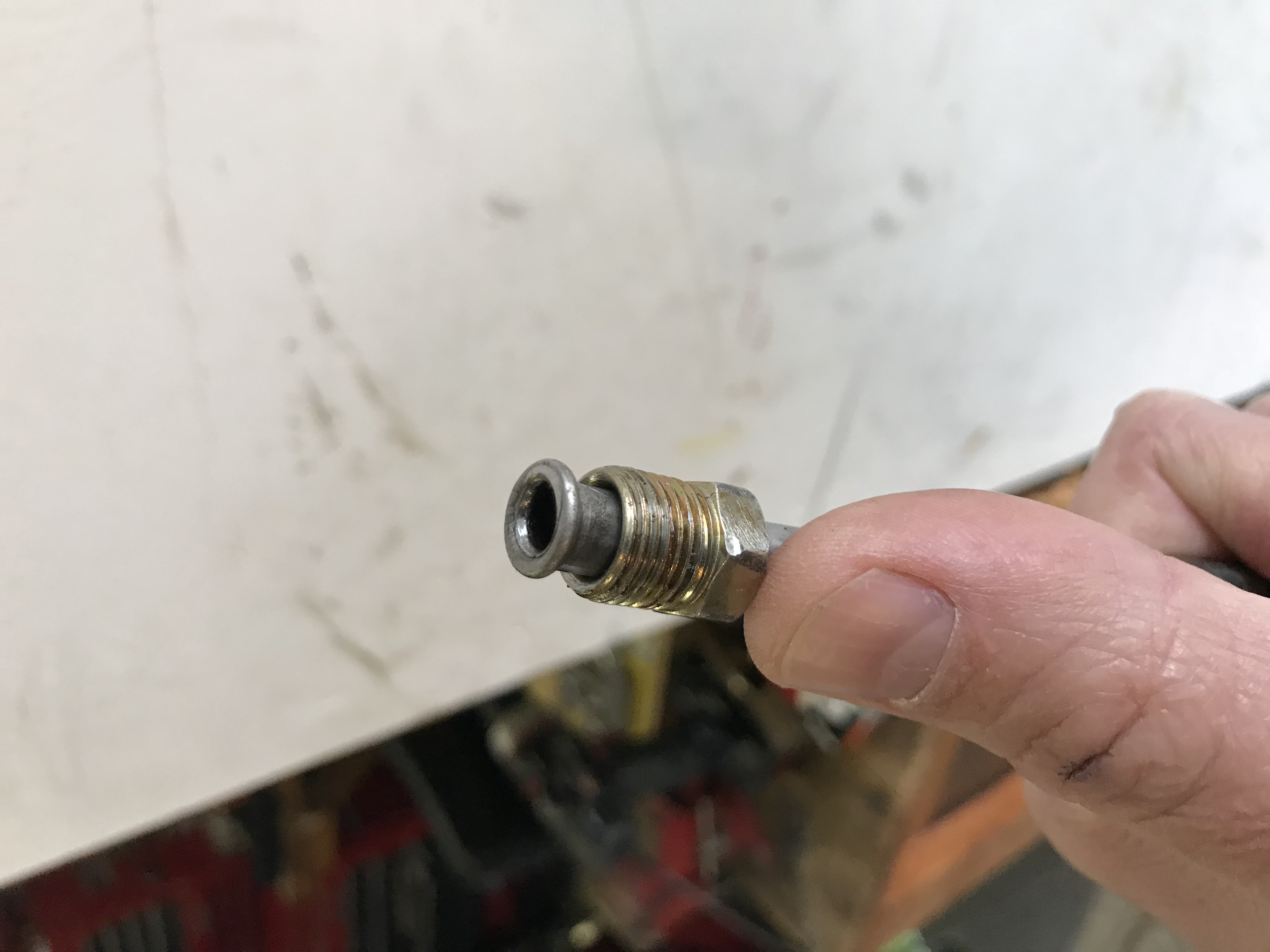

I talked to a local V8 Club friend who has the same car. He felt the fuel line/fitting I had were correct. He suggested I go to Napa and get 5/16 OD line and fitting. Napa did not have yhe 6 foot length I needed, but Carquest did. I have installed and have taken a few trips. I’m leak free so far! I believe the flare was done poorly and was the cause of my leak. Thx all again for the push to resolve this critical issue.
04-03-2018 @ 9:07 AM
I could not get a good photo of the flare on my Lincoln fuel line. I cannot hold the camera steady enough while laying under the car and the autofocus wants to focus on the frame crossmember. My flare does look different from yours.
04-02-2018 @ 7:43 AM
The flare on your line may be incorrect. This PDF file shows the common automotive flares and their sizes.
http://www.fedhillusa.com/webnuts/common%20flares6.pdf
My 53 Lincoln uses the 5/16" steel line that your car has and the end is flared. I will try to get a photo of the end with the fitting and post it for you, so you will have a reference of how Ford did it.

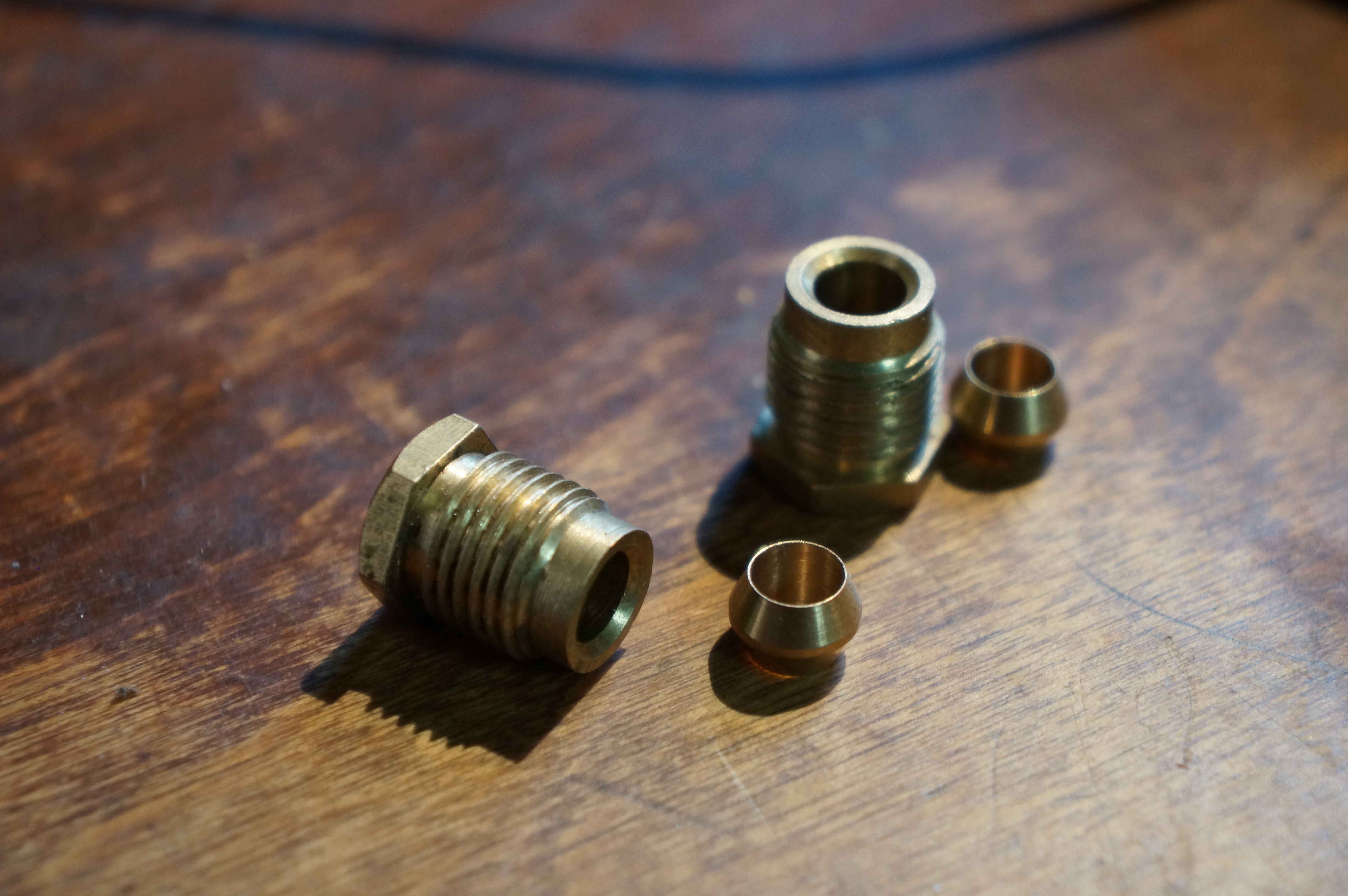

DJ, Yokomo99 shows the correct fittings for your car. I think you may be able to buy them at your local Napa Auto Parts store. I know for sure you can get the ferrule there.

That is not the correct fitting. You are showing a flare fitting, that is for a more modern car. The original is a male compression fitting. I show a picture of the ones I bought for my 53 Customline. I bought the correct fittings at McMaster Carr. You might be able to use your fitting. Just cut off the double flare and get a 1/4" compression ferrule to replace it. The taper of the double flare is not the same but it might work in a pinch.

I bought this fitting about a year ago, and would have to go thru receipts to find out where I got it. Appeared to be identical to the old one. Can you tell if it requires a compression fitting?
04-01-2018 @ 8:25 AM
Is it possible that you bought a compression type that requires a ferrule to seal? I may be wrong, but it is my understanding that the shape of the sealing surface is different between the flare fitting and the compression fitting. I do not know what the 51 Ford used, flare or compression, but most fuel lines used a compression fitting.
I can tell you that if you have a gas leak in the line, your fuel pump will have a hard time getting its prime. If the line is leaking fuel, it will also leak air making it hard to maintain vacuum on the line.

Ok, thought I had it completed, but one more issue. The fitting connecting the fuel line to the gas tank was in bad shape. So I bought a new fitting, then took the fuel line to a local auto repair shop. They cut the flair off, then installed the new fitting, and flared it again. I hooked up the line; put about 3 gallons of gas in and no leaks. Today, I filled it up, and look under the car. It had a steady leak from that fitting. I was able to tighten it slightly, but it still has a slow drip. I have drained all the fuel. The lines are steel. Not sure if original. I have a fuel filter in the line right below the drivers door. What would you guys recommend I do? New fuel line? New fitting? I’m not sure if the auto shop did a quality flair job. Thanks much.
