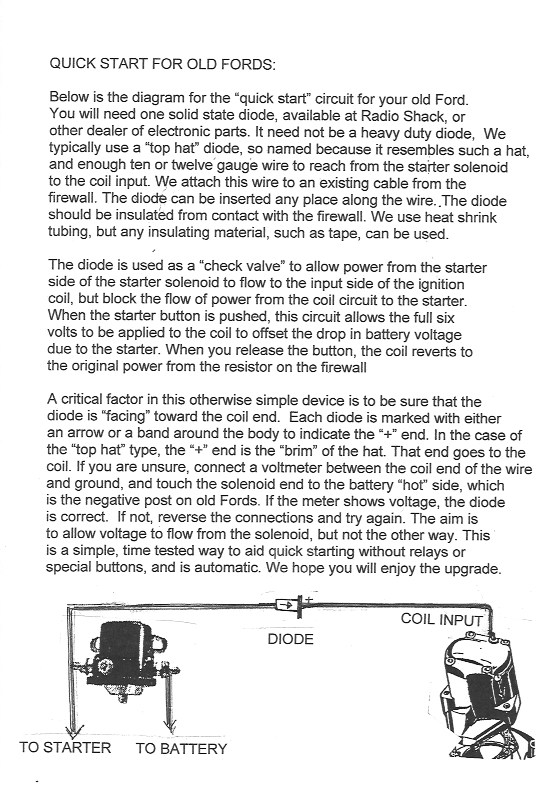

Installed Super's recommended starting enhancement; ran 10 guage wire, with a diode inserted, from the starter side of the solenoid to the positive wire on the coil. Fastest start ever, but when I moved the ignition switch to Stop, the engine kept running. Stopped it by pulling the lead from the coil to the distributor.
Where did I go wrong this time?

Here is my original instructionsM

Finally found the original page. Follow the instructions carefully and it should do as mentioned. If you connect the circuit to the battery side of the solenoid, instead of the starter side, it will override the ignition switch, the engine will not stop as mentioned in the post. A word of caution: Pushing the starter button without the switch will run the engine as long as the button is pushed. This is important if you are "bumping" the starter button to turn the engine while you are under the hood. Disconnect the circuit at one end or the other if you are working on the engine. I devised this "quick start" more years ago than I want to remember. The purpose is to bypass the resistor to compensate for the voltage drop due to the starter and provide full voltage to the coil. then automatically return the system to stock when the engine starts. For cars in the 50's and 60's this type of circuit was built into the system It really helps starting hot or cold.

The car is a 41. much of the wiring is original. 6 volt positive ground. Has a pancake distributor and round coil; both the coil and the condenser are new from NAPA.
The diode is installed so that the end with the band is closest to the coil. Used 10 gauge stranded wire. Diode was soldered in place. Connections were covered with shrink wrap. After the wire was connected to the starter side of the solenoid, the coil end touched some metal and a small spark resulted, so I assume that the diode is correctly placed.
