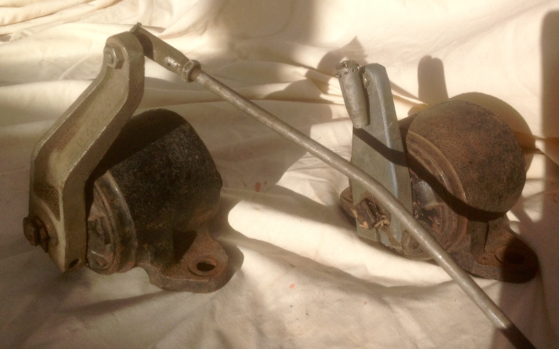

Greetings all
When I finally sorted out all the baskets that came with my 'basket case' 42 Fordor, there were a few oddballs stowed away in there.
The pics below are of a pair of Houdaille shocks. They are marked '19 42Z' and there is also a triangle with a three next to it.
They both have square filler plugs, and due to the plug positions, look as if they would mount on top of a structure.

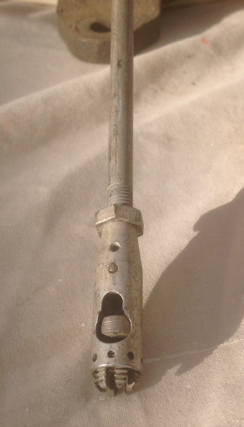

There is a different type of lever arm on each shock, and a flimsy looking rod arm with adjustable ends.
One of the rod ends looks like it might go onto a ball end arrangement.
I know they don't belong on a '42 Ford, and I can't find any similar pictures on the web.
I need help to solve this mystery - any takers?

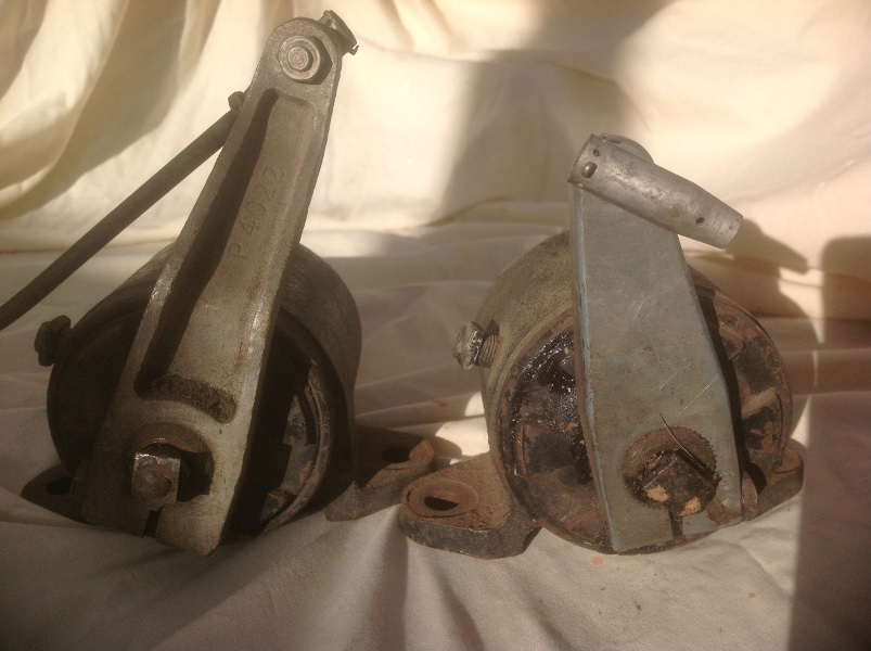

photo of lever arm with P4022 stamped on it

photo of rod attached to lever arm

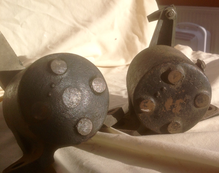

photo of the two shocks showing numbers in casting

If the bodies have a diameter of 2 7/8" they are 1940. The arms and rods appear to have been home made for some sort of dampening effect - I doubt an automotive application.
If the bodies are 3 1/4" diameter they are '41 - '48.

The body diameter is 3 1/4 inch, so they must be 41 - 48, just with different arms.
I can't imagine what the rod and clevis arrangement was designed for - certainly not any sort of rapid, high load application. How about something to snub a soft top roof mechanism?

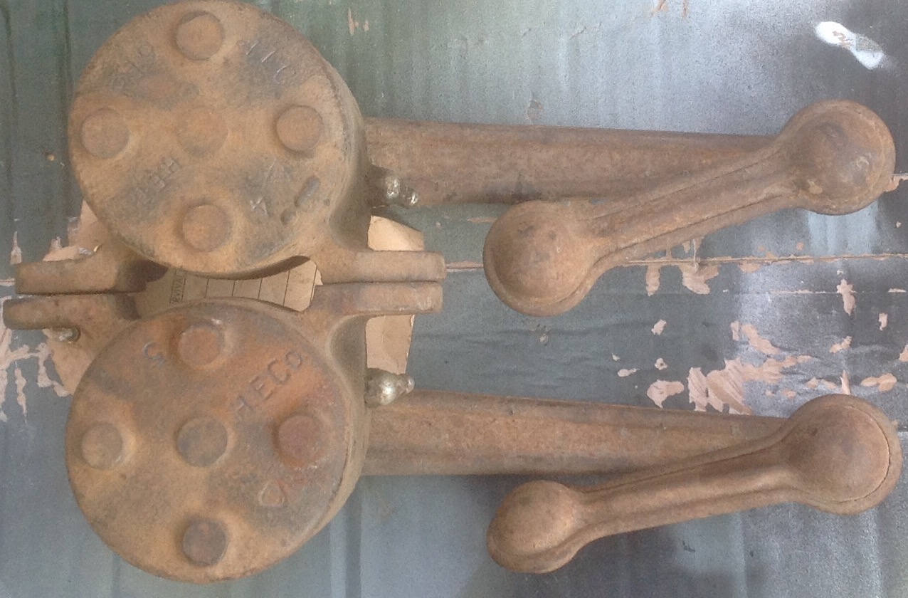

More photos of the shocks from my 42 rear end - check out the grease nipple mod . Have you seen anything similar?
MT

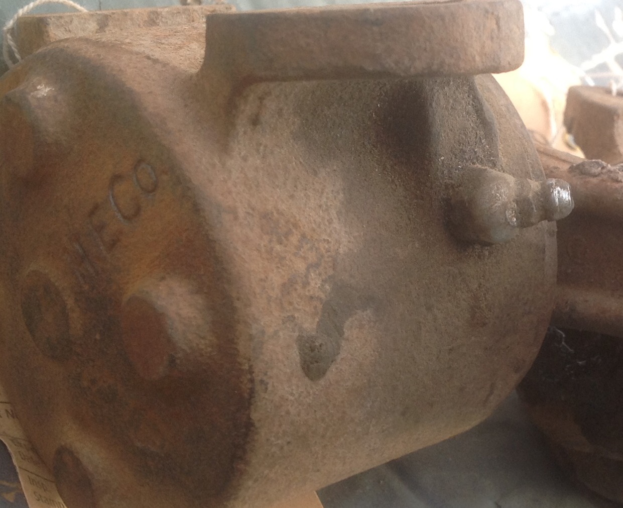

Another photo of shock with grease nipple mod.

I've seen shocks with a grease fitting before. I suspect many folks erroneously believed these were to be (re)filled with grease.
