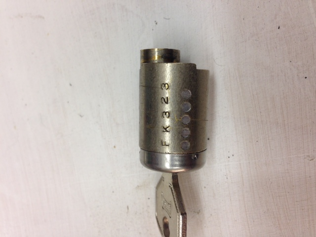

customer called me to remove broken key in steering lock on column with a switch as well. I'm a locksmith and my customer told me to check if I could remove a broken key from the steering wheel lock that also blocks a push button switch to start the engine. The key is in the vertical position with the cuts facing downwards. It doesn't seem to turn either way (clockwise or couterclockwise) and the key pulls out very slightly as if it was turned halfway and snapped at the shoulder.
Can anyone confirm which way the key should be and if the lock can be dismantled with a broken key in it ?
Thank you for your time

I have a 47 Ford and have had my ignition lock/switch apart. I'm not a locksmith. The way my lock works is as follows. With the cylinder lock in the locked position the key may be inserted with the cuts facing up. The key is turned/rotated counterclock wise 180 degrees to unlock the steering wheel cylinder. The ignition switch lever may now be pushed up allowing the car to start when the starter button is pressed. In this position the key cuts are facing downward and the key can not be removed.
If there is enough key left for you to grab with pliers, etc. you may be able to turn/rotate the key clockwise 180 degrees and then remove it. As you attempt to do this feel the steering wheel to determine if you can take some pressure off the cylinder lock by slight turning the wheel one way or the other. This should allow the key to rotate and be removed. If this does not work you will have to remove the pin under the lock cylinder to get the lock out. This pin may be drilled out carefully to not damage the housing or the lock. Use a small drill and go slow. Once the pin is out the lock will slide out. When you replace the lock use a set screw instead of the pin. Attached is a photo of an ignition lock. Hope this helps.

thank you rg30 for your tip. Idid manage to get the broken key out by turning the cylinder back to it's original position.
Now I'm trying to get the cylinder out because the key I made doesn't work. I' ve decoded the key from the broken part that I removed. Cut it on my electronic key machine to the manufacture's specs. And it won't turn so I think the tumblers inside might be damaged from the pulling I did and whoever else tried before me.
Can you tell me how to get it out of the column ? Does the key have to be at a certain position to pull it out ? Worst case scenario ,I' ll drop the broken one back in to rotate it if necessary to turn it at 2 o' clock for example. Thanks for your picture of the lock you sent. For your info, the code number stamped on the lock casing: Ican make a key from this number on my electronic machine.
