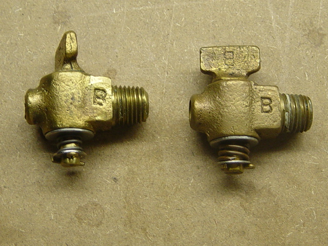

Can you post a photo ? I have several 1930-1940 vintage my Dad saved.

The image posted by 40Coupe is identical to mine, although cleaner. I used polishing compound to try to restore seal with nice cosmetic result on the inside but it obviously didn't solve my problem. I will try again.
If Drbrown has one like it, send me a PM. Otherwise I fear I will have to surrender this bit of authenticity . A continued search to the other sources listed will be done.
