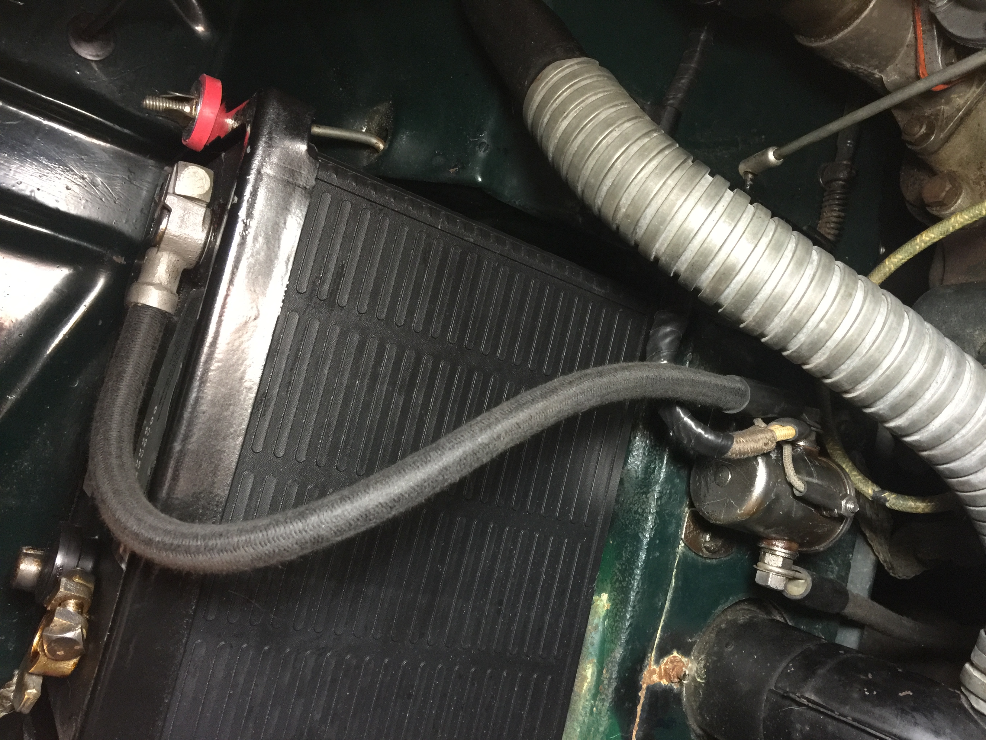

Tom. I attached a picture showing how it's connected. Now it turns over but wo having key on and no lights. Horn works

Common mistake is to install the solenoid backwards. The cable from the battery connects to the right hand big terminal side along with the smaller wires that feed the system. The other side big terminal goes to the starter only. For those taking anything for the first time, take a photo before you start.
