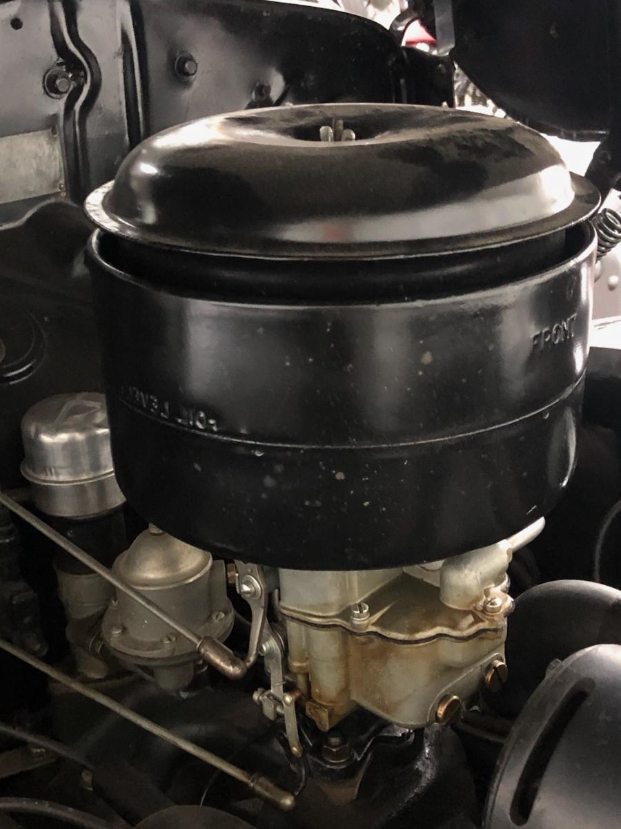

Here's a picture that may explain the problem. As you can see in the photo the fuel pump screen is loaded with debris, stuff that looks like coffee grains and a piece of white material as well. I installed a new Drake gas tank a few months ago so would like to believe it's not rust. Just before my problems started went to gas station with 2 gallon can filled it up and put it in the car; don't trust my fuel gauge. Could this be dirty fuel from the station. Would installing temporary filter up on firewall where the flex line is be an easy solution till I run the tank dry?

These days, fuel contamination is a big problem. Last week, we had three cars in our shop with bad gas, all purchased at the same station. It is a very good idea to install a fuel filter in the gas line as close to the tank as possible. Even then, fuel contaminated with water will cause problems. The worst we've seen was when liquid fertilizer was accidentally put into a filling station's tank. I'd drain the tank. It is also possible that someone put a handful of dirt in the tank. A locking cap is very good insurance against that sort of thing.

I don't show my cars, so having a filter isn't a problem. I have been marooned with fuel problems in the past, so the filter is a kind of "insurance". The stuff in your photo looks a great deal like the material we routinely find in gas tanks, but doesn't look like anything that would result from installing a new tank. I suspect that much of the bad fuel results from stations running their storage tanks down to the bottom where crud accumulates. Most pumps have filters that are supposed to catch contamination, but only if they are serviced regularly. In addition, at least around here, the operators are supposed to test gas for water. There is a product called "DeTex" which is a test strip. If you buy your fuel at the same place regularly, I'd ask them if they test their gas. Contamination can be very expensive in new vehicles, as it can ruin the in-tank high pressure pump. If that pump has a filter "sock" on it, the whole unit usually must be replaced, which is expensive, to say the least. Installing a temporary filter is a very good idea, as draining doesn't always get all the loose material. We put bad gas thru a filter of the type used in body shops for paint so we can identify the particles. Usually, the gas station is stuck with the repair bill in this area.

It all came back to me while I was sitting at my workbench cleaning out fuel pump. As I said before I replaced fuel tank because it was full of rust & removed fuel pump and put it in the shed & replaced it with another. A few days ago car started running badly so thought maybe the fuel pump was bad so replaced with previous pump, yes then dirty one. Cranked half a cup of fuel into jar with no debris, put clean pump on & runs great. Here's what came out of dirty pump.
