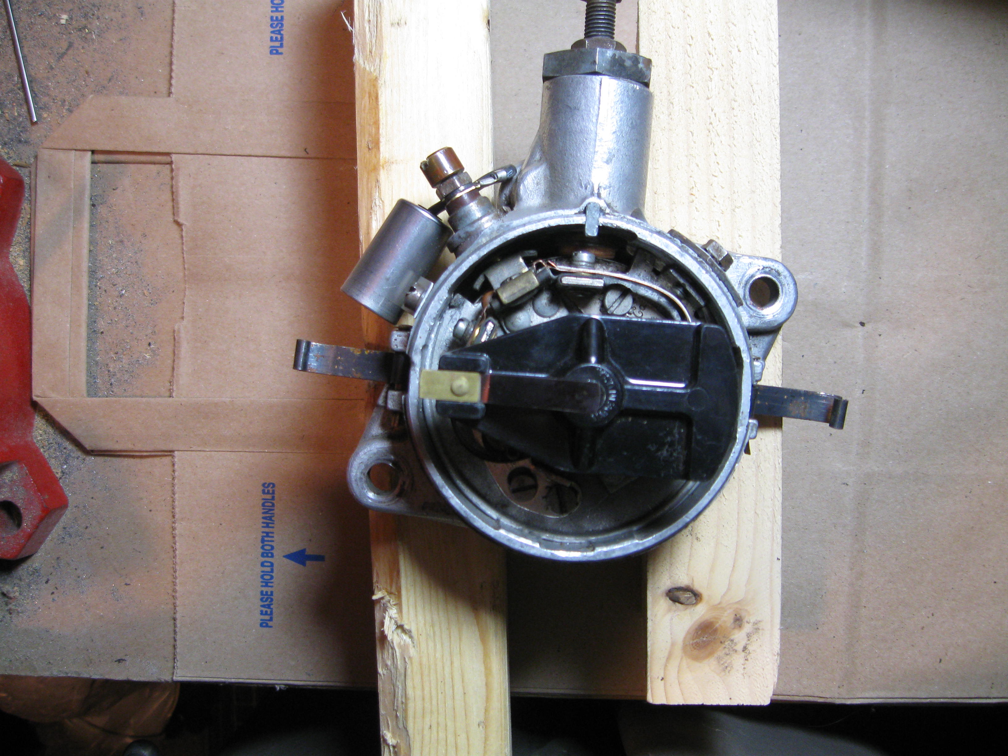

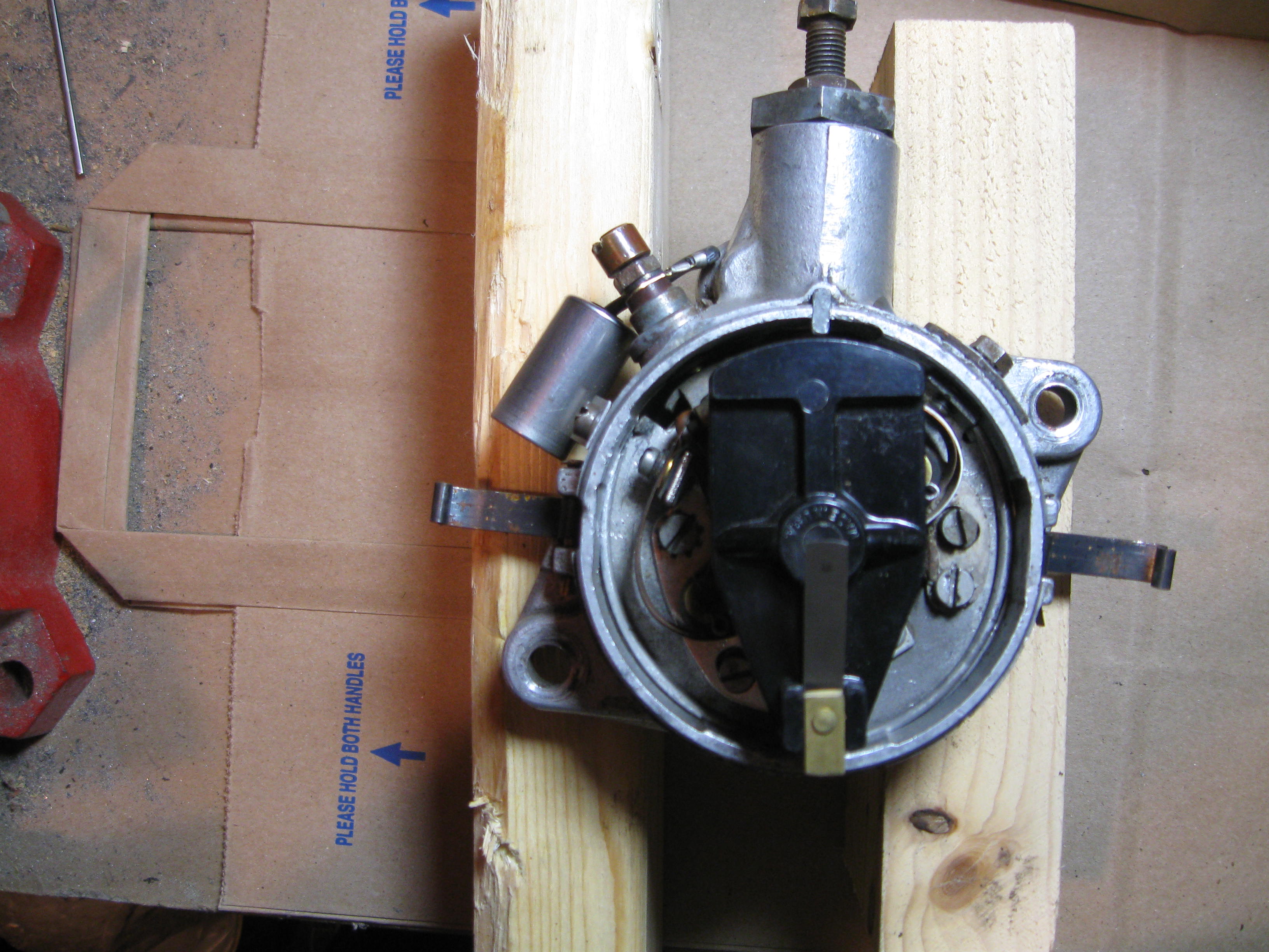

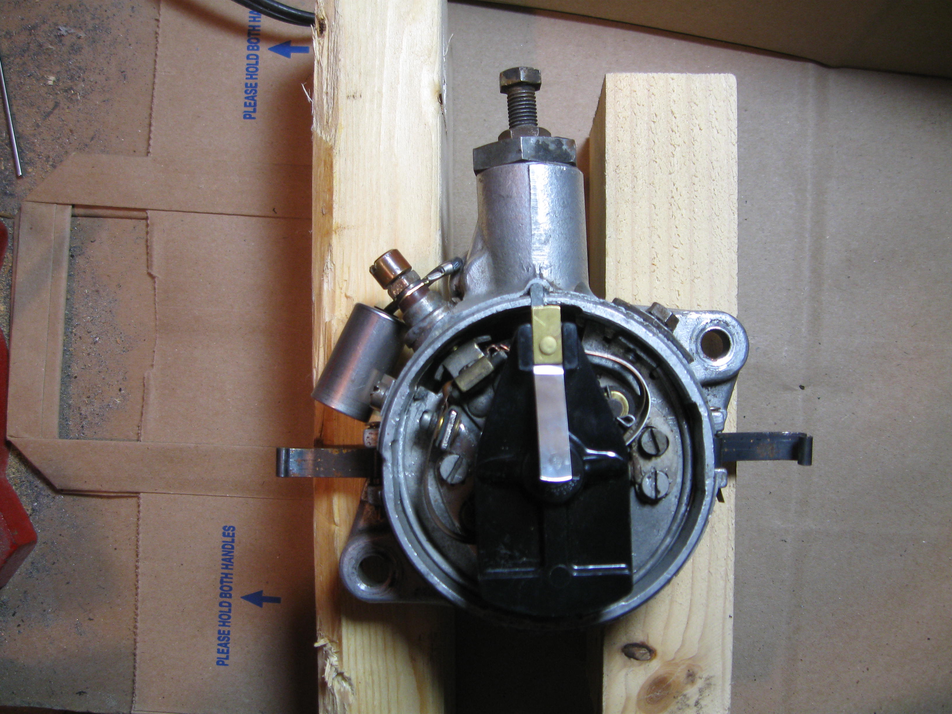

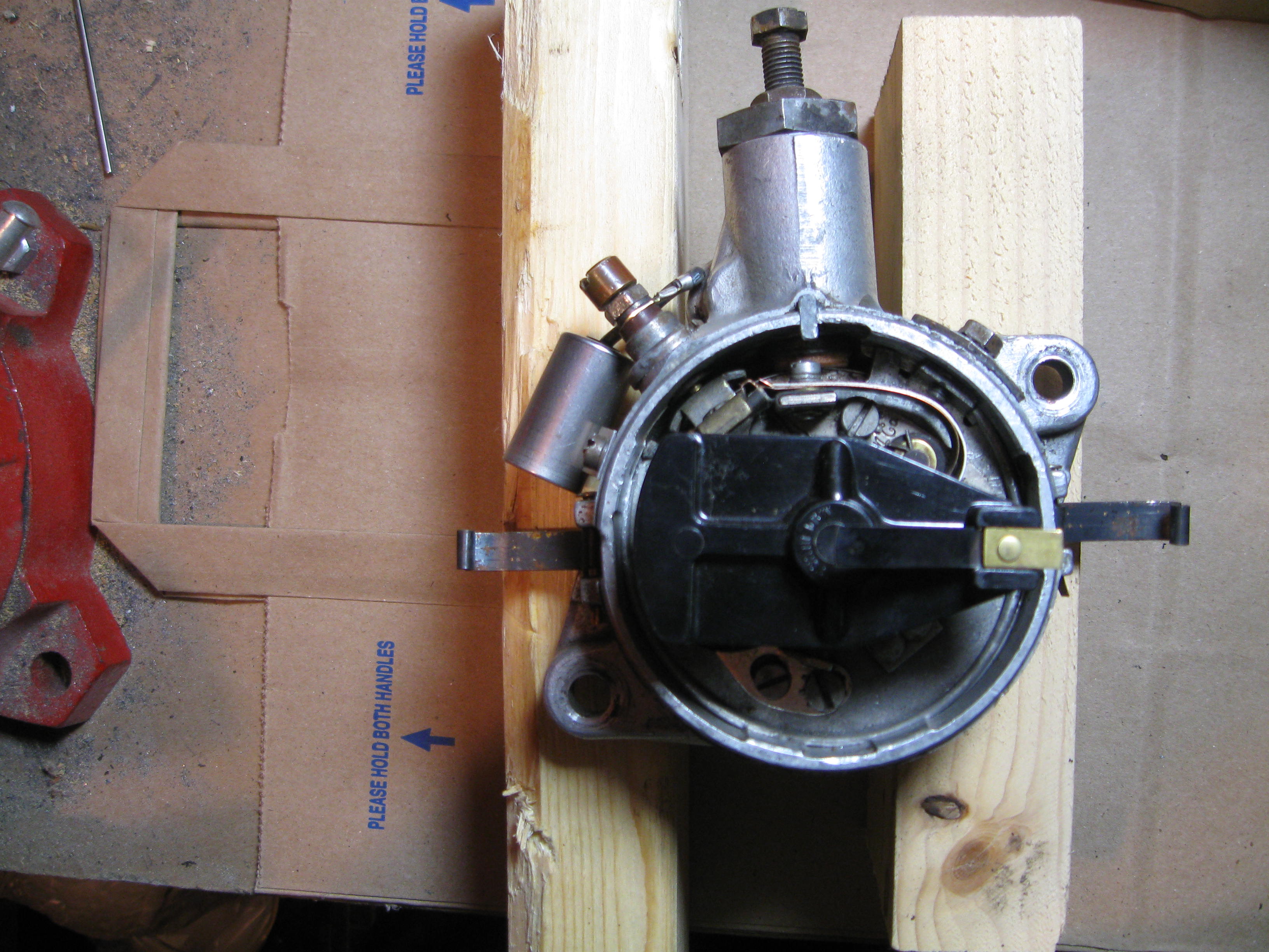

11-17-2017 @ 6:38 AM
Ken, I believe that the difference in rotor overhang is due to camera position and the angle that the distributor is held by the boards. Unless you have a precision stand for the camera and are able to center the distributor exactly parallel to the camera's focal plane, you will have some distortion.
ken ct.
11-17-2017 @ 5:34 AM
Posts: 1513
Look at where your rotor brass blade is in photo #1 and last photo. Blade in last one is acuallyb over hanging the outside of the housing,and inside on the first one. Pointing to a bent shaft (though hard to do as its pretty short compared to say a helmet shaft.) Either poorly made rotors or cap is not seated correctly ,I have USA made rotors and points if you need. I got NO response from PM I sent you ?? Something isn't kosha there. ken ct.
