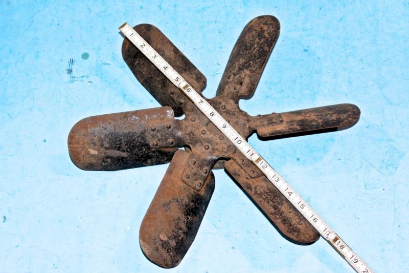

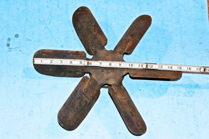

onedon- Not all six blade fans will work on your '36. The passenger fan (what you will need) has a diameter of 15 3/8". The truck 6 blade has a diameter of 17". If you attempt to use the larger diameter truck fan it will hit your distributor or upper hose outlets or both. Note the pictures . Oh yes, I guess "noise" is relative but I found the extra noise very objectionable on my '35. It did help cooling somewhat. Tom

Onedon- '35-'36 truck fan picture. Tom
