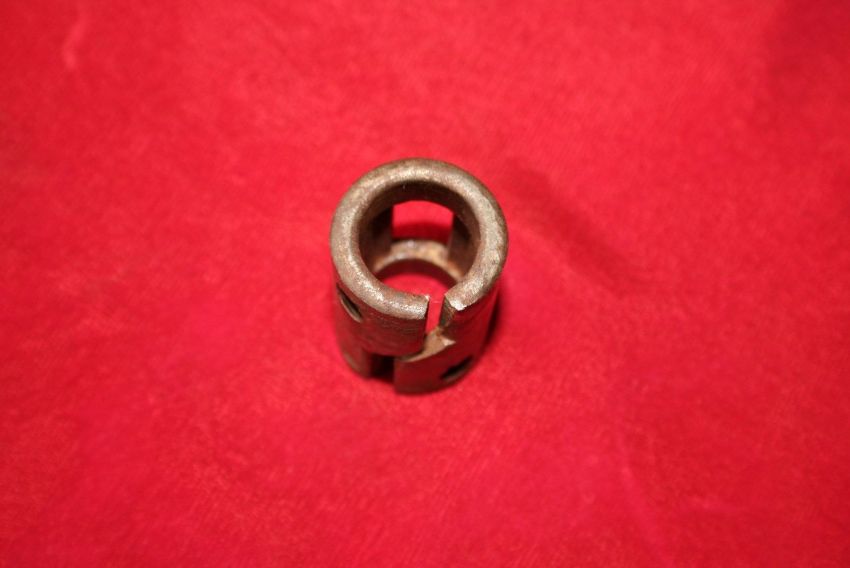

Posts: 450
This is common. On your steering shaft there is a collar (note picture), that has a slot for the for the locking pin to enter to lock the steering gear when the key is removed. Sometimes the pin gets stuck in the slot. Try this. jack up the front wheels enough to get the tires off the ground. Attempt to wiggle the wheels back and forth while a buddy attempts to rotate the key back and forth. Usually this will solve the problem. Tom
