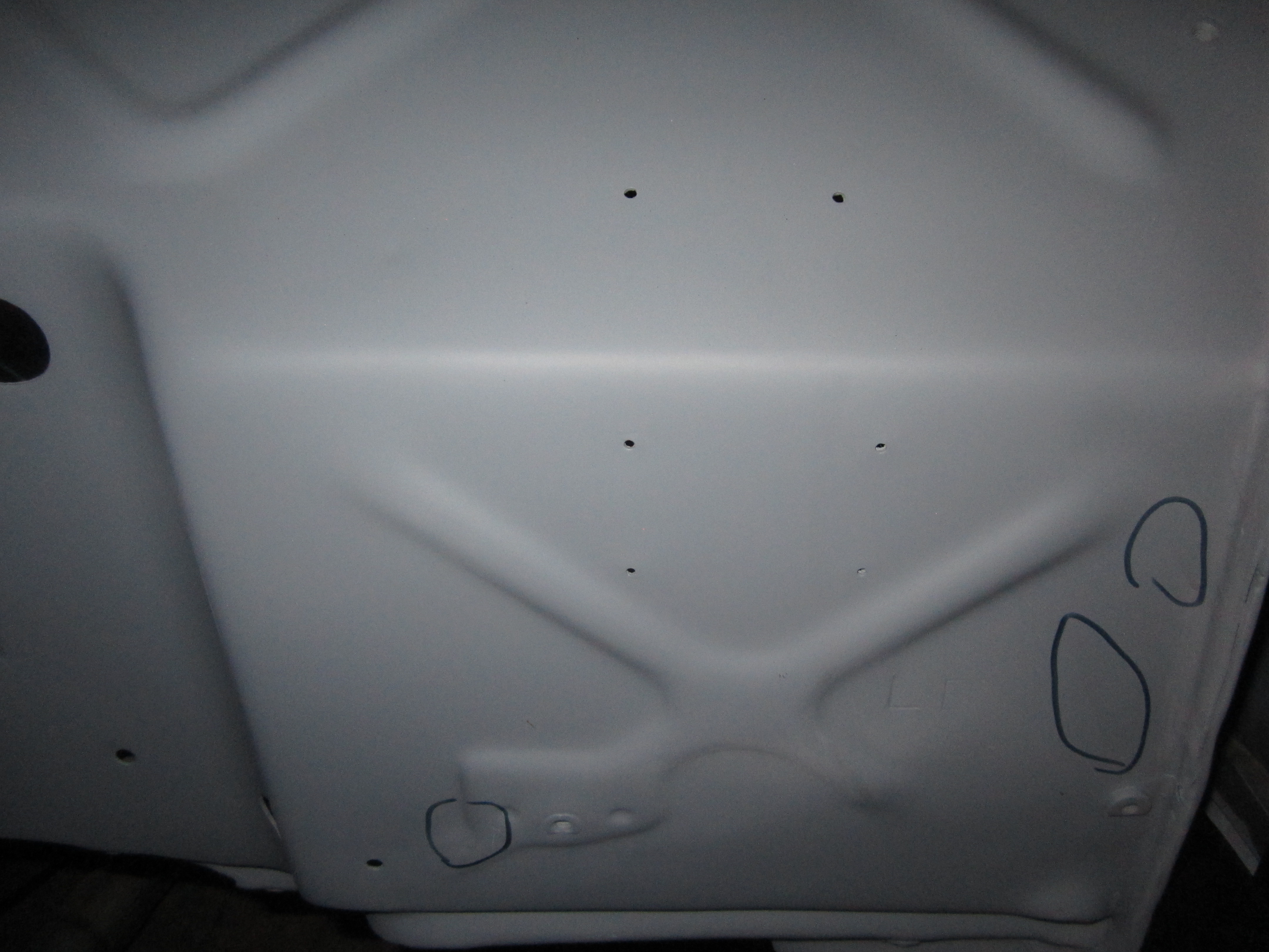

four holes for the big tag, two holes for the smaller tag above. 37 Sedan Delivery cowl pic attached.

And yes..., mine has two holes where the tag should be.

All the firewalls had the holes whether there was a body number tag attached or not. The presence of the holes is not indicative of a missing tag.

I have to disagree with 3w2's comment about all firewalls having holes for body numbers regardless if they originally had a tag, or not.
My '36 is a very late '36 that still has all of it's original black paint on the firewall/cowl, my car never had a body number, nor is there the "two holes" for same.
My firewall/cowl has the patient plate, four holes, located on the right side of the firewall.
