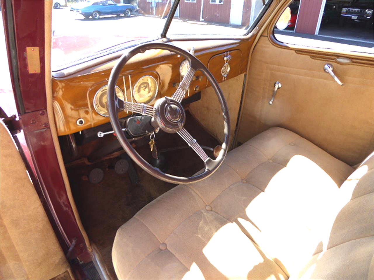

So my '37 Deluxe Fordor V8-85 has had a nicely done dual exhaust installed somewhere along the way, except for the fact that it has some kind of Glasspacks on it which are too loud for my taste for such a stock looking rig. I'm looking for some suggestions on what might be some good muff options that will be relatively quiet, but still give me some good flow with a nice rich deep tone?? I am assuming that the dual exaust in itself, even with the 1.75" pipe gives the Flatty a bit more breathing room than the stock single? Any suggestions will be greatly appreciated!

Nice looking car. I always love those grills. They look so classy. Anyway I have always been partial to the DynoMax super turbo mufflers. They came stock on the Saleen Mustang in the late 80's`. They are not loud but leave the deep rumble without the blatty overtones the glass packs have. If there is room adding a crossover pipe ahead of the mufflers will drop the SPL (sound pressure level) of your exhaust 12db and smooth out the tone. Modern mufflers are all designed for systems with a catalytic converter. Most cat's are so restrictive that new cars almost don't need a muffler. Most loud cars today have just straight pipes from the cat back. Without a cat our old cars are just too loud with the modern exhaust systems.
