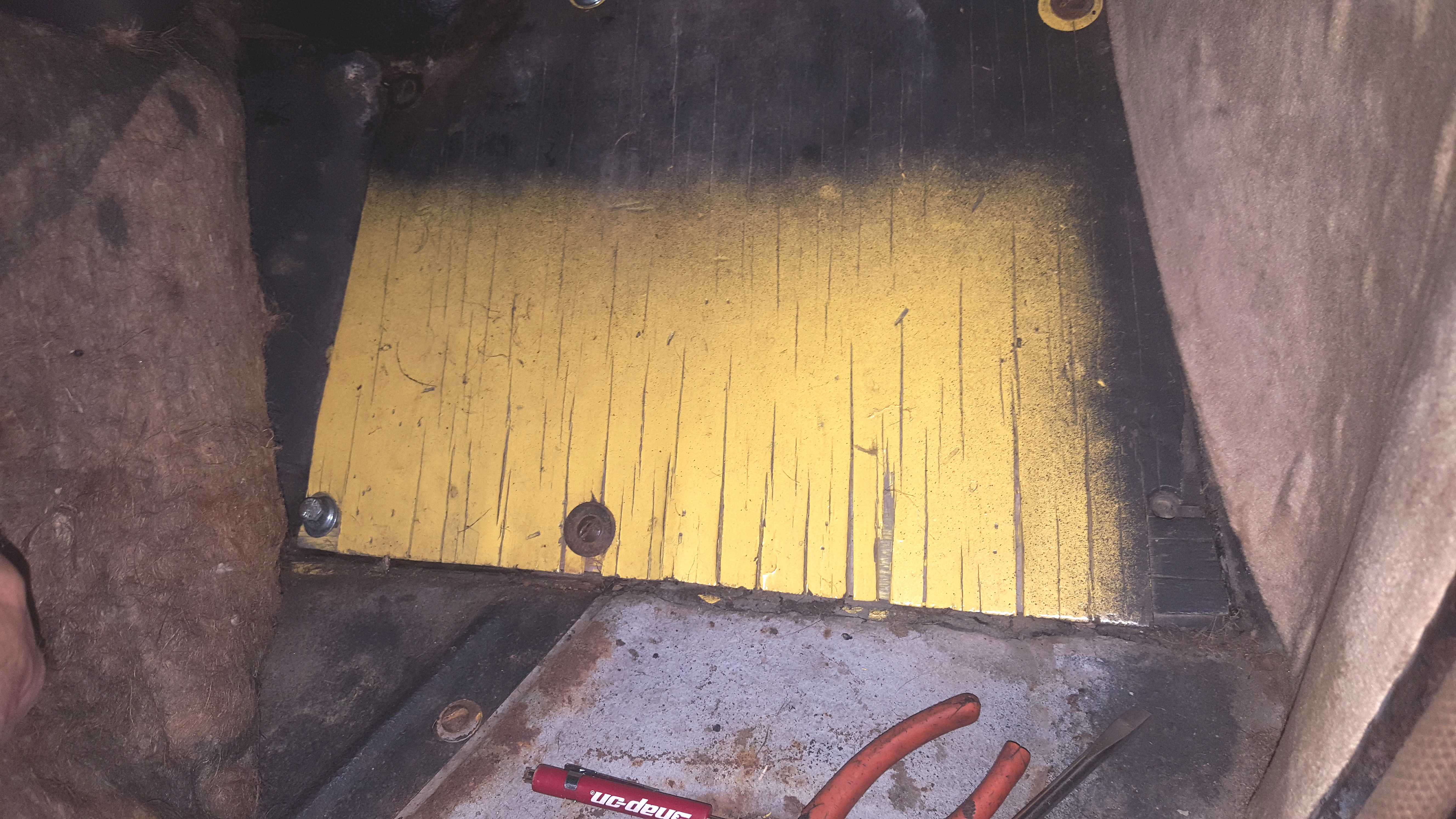

So......, is it possible that my 1937 Ford Deluxe Fordor came from the factory with wood toe boards???

Here is a picture of the drivers side Toe Board.
ibshane
10-18-2017 @ 11:24 PM
Posts: 147
Joined: Oct 2017
Woops..., here's the pic!
4dFordSC
10-19-2017 @ 4:20 AM
Posts: 266
Yes.
10-20-2017 @ 9:52 AM
The toe boards were wooden until 1941. They were painted black.

Here are some original toe boards. Someone hacked in a dimmer switch.

I didn't notice the wood toe boards..., until after the car had arrived at my house from the shipper and I had it in my garage toying around with my new..., what I thought had been a good deal! When I saw the wood, my first thought was "Oh Sh*t..., I've been scr*w*d".., thinking that the seller, had scabbed in some shoddy plywood patches in place of rotted out metal pans! But the odd thing was that all the metal I had checked at the time of purchase (from the toe boards back) was in d*mn near pristine condition!
So needless to say I am extremely happy to hear that this is normal!!
So Thanks guys for sharing your knowledge!! I think my blood pressure is back to normal now!!
