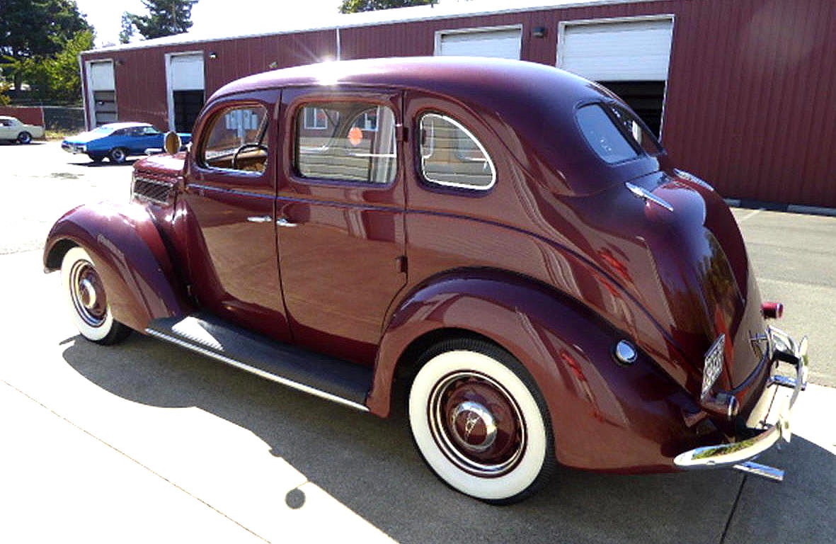

I am a newbie to earlyfordV8.org as well as being a newbie to my new/old (Almost Bone Stock) 1937 Sedan Deluxe Fordor.
My question is: Can I put tubeless radials on my stock wheels? I've been looking at the Coker & Diamondback wide whitewall radials.

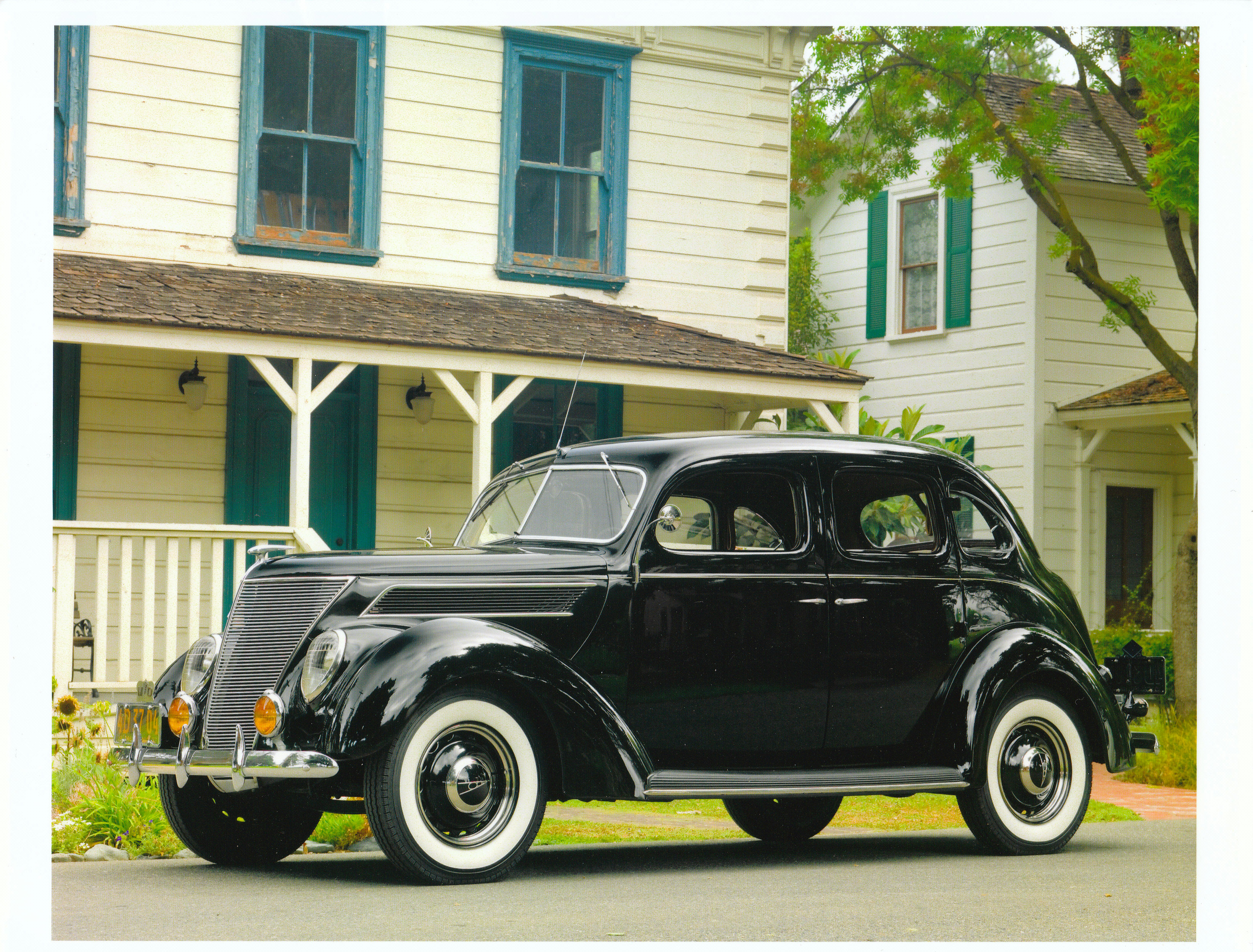

Radial tires on a '37 pictured in attachment below. The Coker tubeless radial tires on this car are being run with tubes inside....

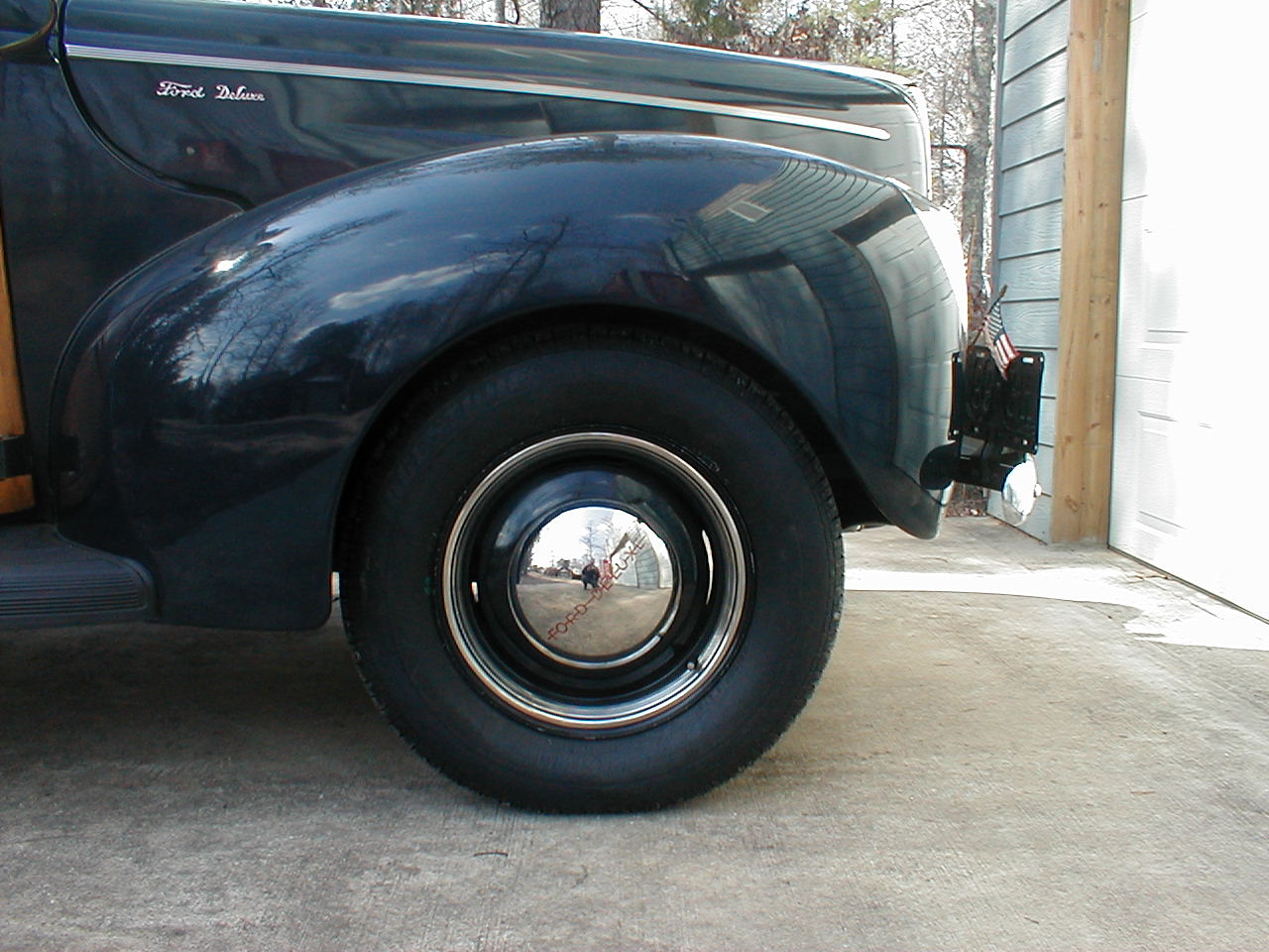

I have been running radials on my 40 wagon for 4 years. Firestone/Bridgestone Ecopia , never have run tubes. I do know of at least 4 other cars/trucks running these tires. 195 80R 16 high pressure radial tires
