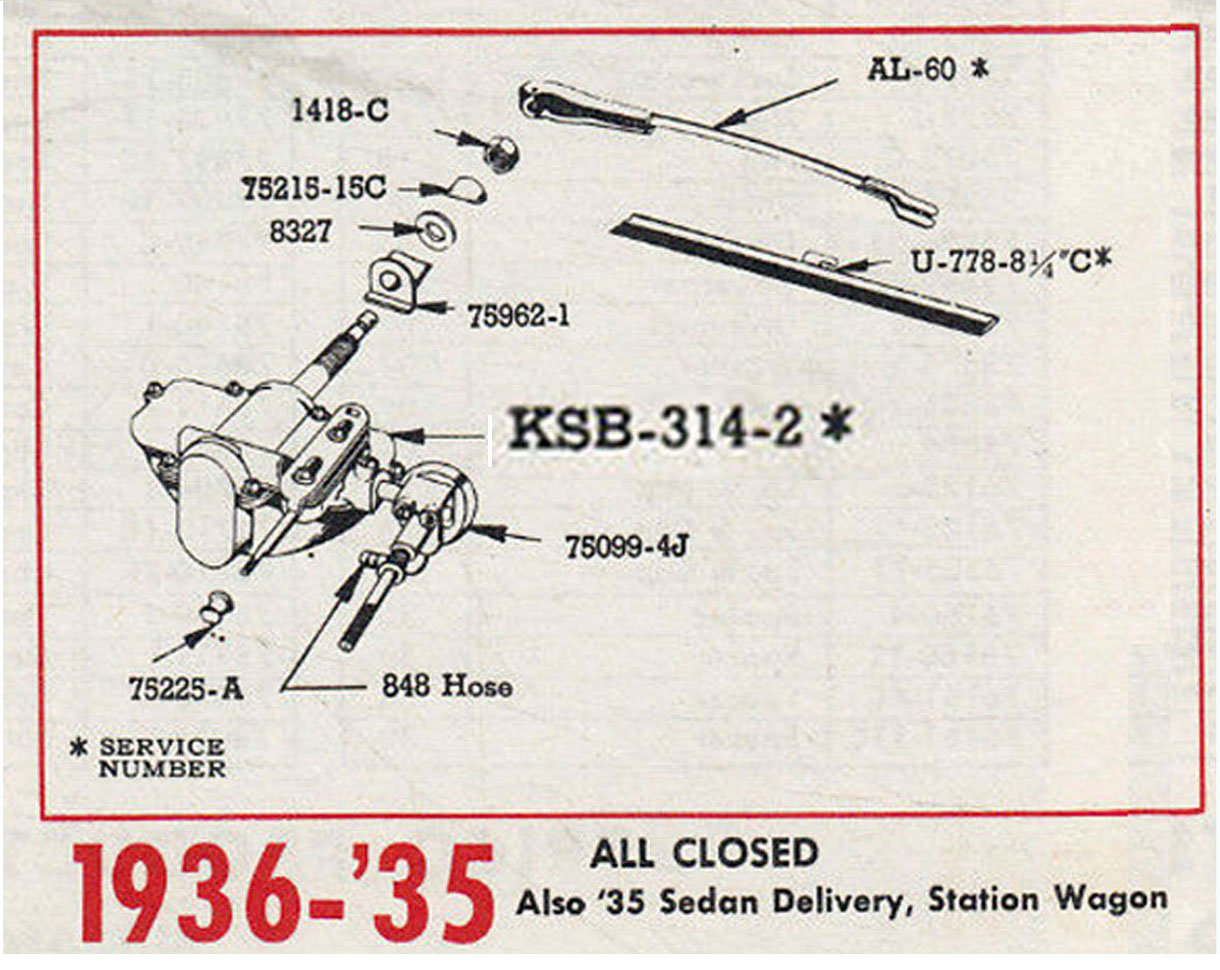

Wiper motor id'd as a Trico KSB-314-2 in my 35 coupe. Thks. What are the two knobs on motor? One on left turns it on but what does one on right do?
Motor rocks back & forth when in operation about as much as wiper blade does. How should motor be secured? Is it solely dependent on the tightening of the outside nut on the wiper shaft?

The knereld shaft on the rt adjusts the speed of the wipers. ken ct.

Make sure 75962 is in place and tighten the one outside retaining nut. Don't over do it just to stop the motor from rocking.
