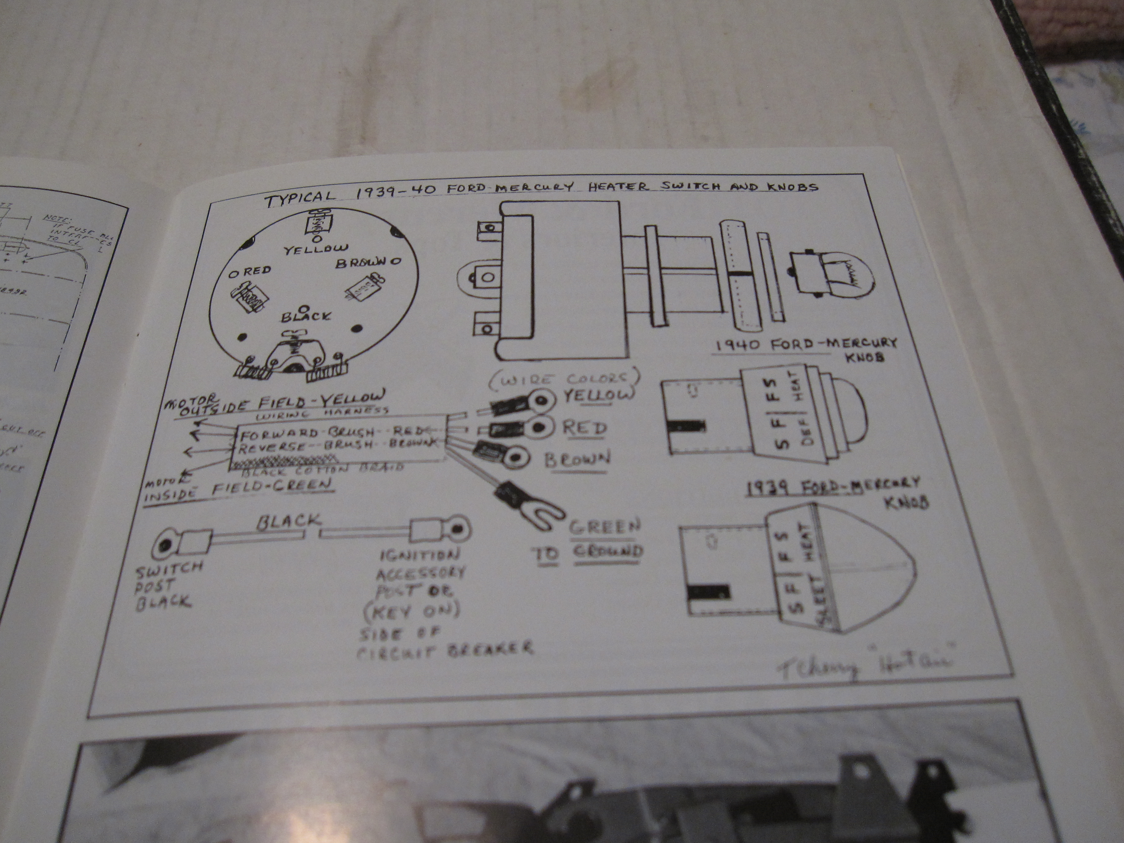

10-07-2017 @ 7:08 AM
Posts: 152
Will this help ? It is from the V8 Times Magazine July/Aug. 1989.
10-07-2017 @ 9:58 AM
Posts: 3573
Cpippo, That's (your schematic) for a hot WATER heater - very different than a hot AIR heater in both the switch and wiring.
My earlier post was a copy, word for word, from the authentic instructions included with a hot AIR filter.
