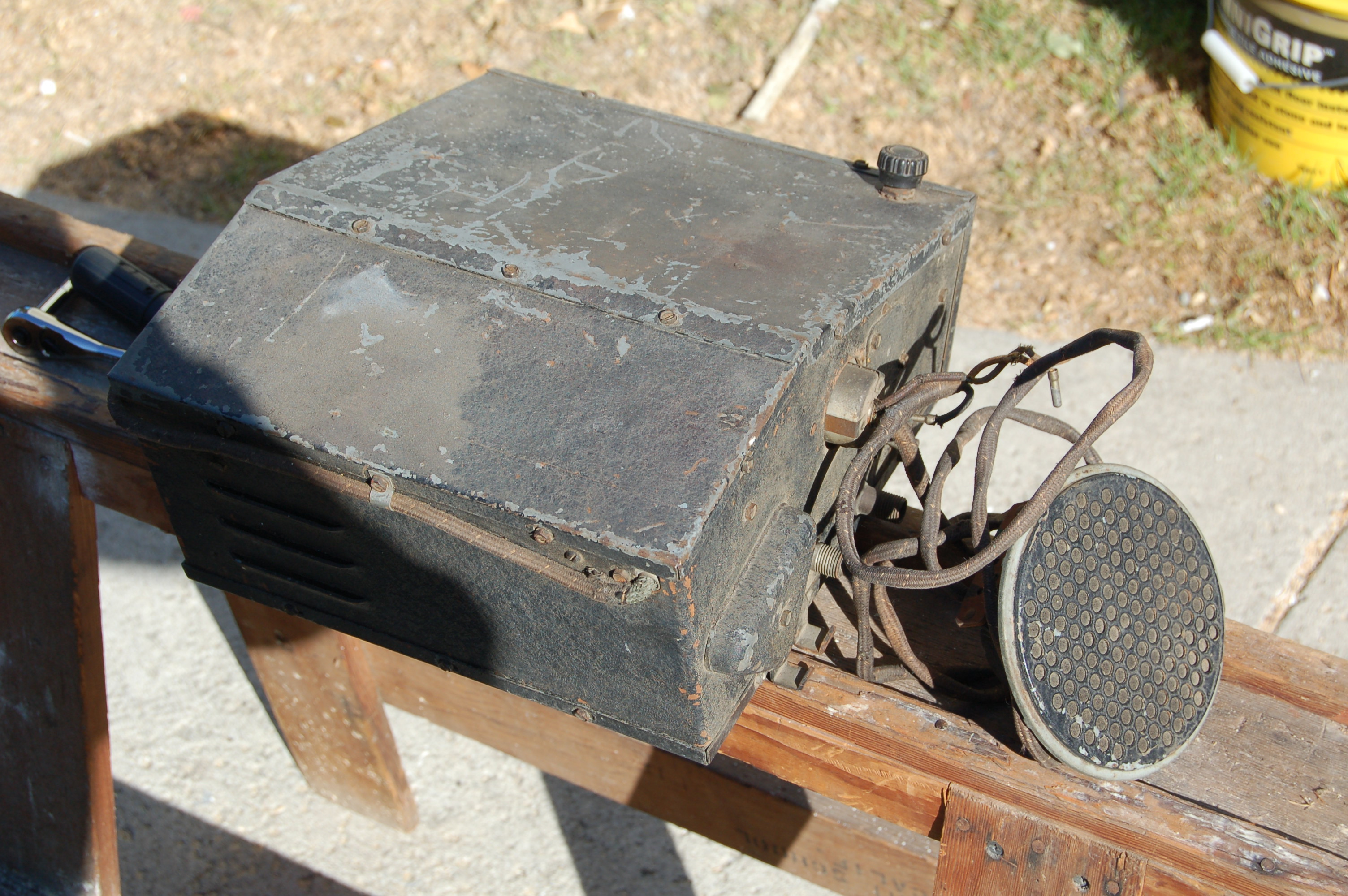

I have attached a pix of an original '35 Ford Philco radio that shows the antenna lead-in wire on the side of the box. I have a perfect lead-in antenna wire that has been modified with a bayonet connector.

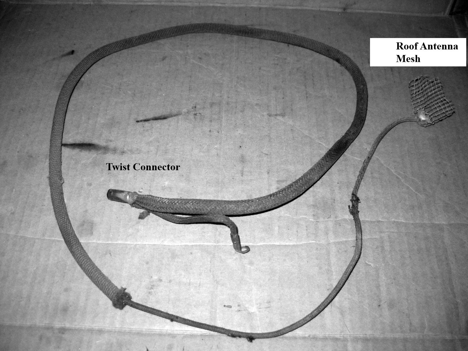

Here are some images showing the antenna lead in and connectors
Don Rogers

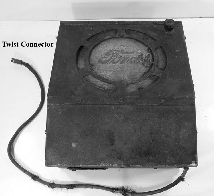

09-29-2017 @ 4:23 AM
Posts: 512
Image 2
Don Rogers
Posts: 512
Image 3

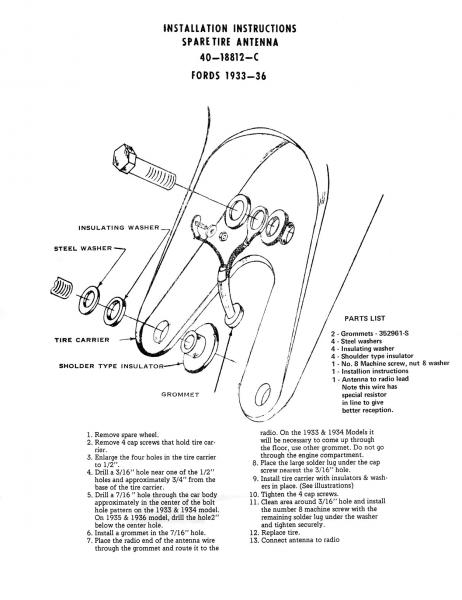

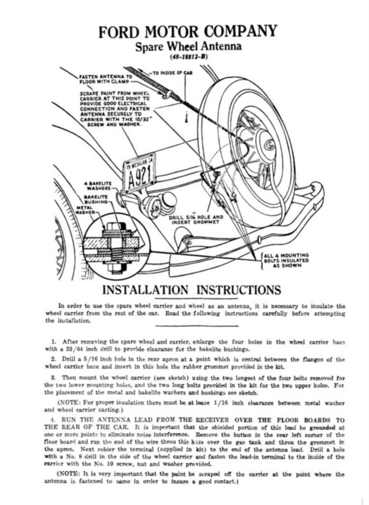

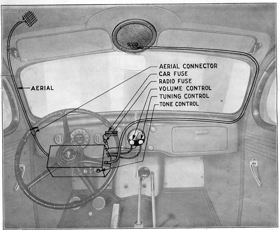

You did not mention your vehicle body style. In case it is not a Fordor, there is no wire in the roof of the open cars and the 35 open car would use the spare tire antenna.
This message was edited by 40 Coupe on 9-29-17 @ 5:13 AM
09-29-2017 @ 5:08 AM
Posts: 1800
more
