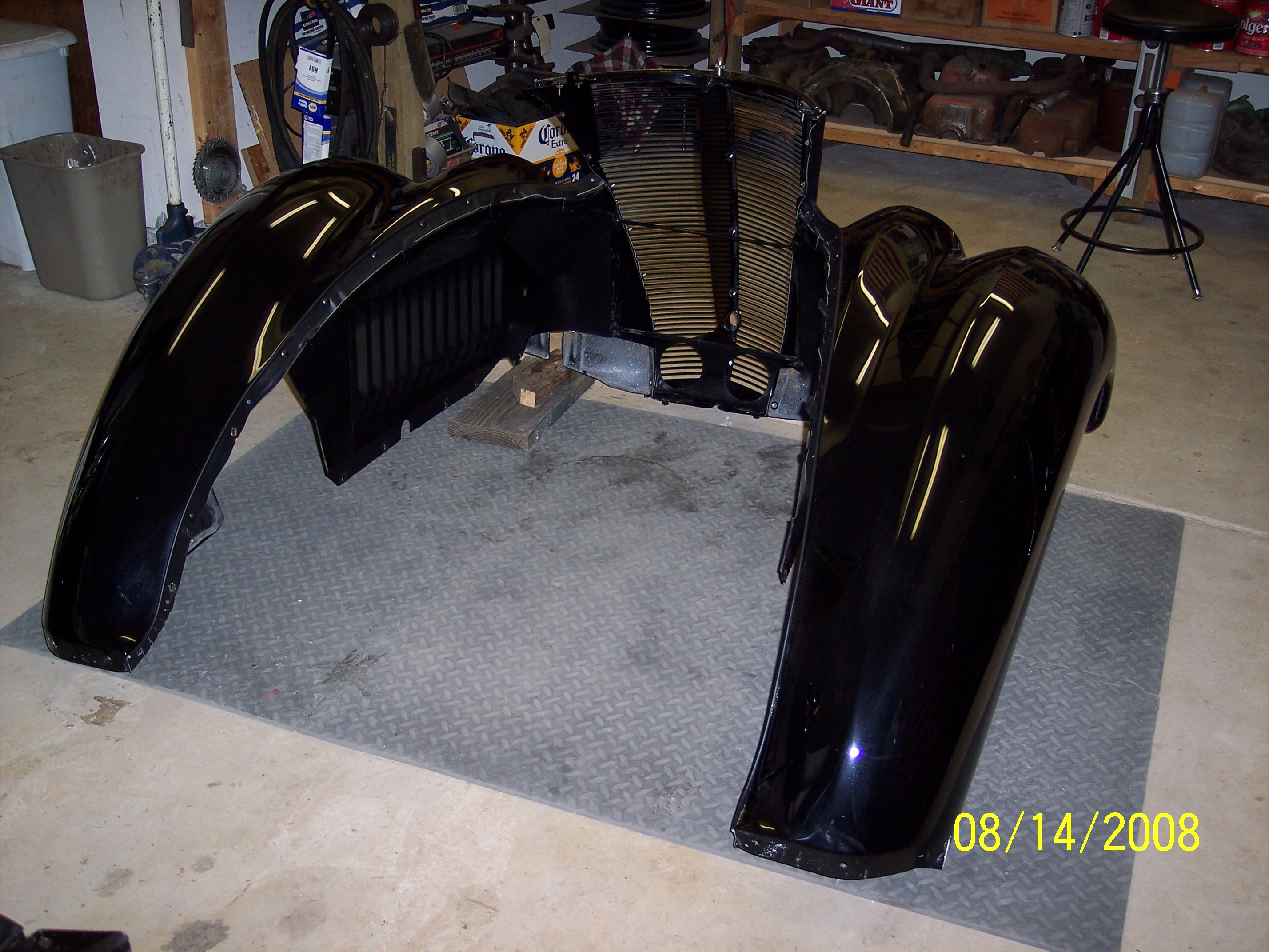

rg130 |
09-24-2017 @ 10:27 AM
Posts: 28
The horn/splash pan goes inside the grill (see photo).
1937sedandelivery |
09-24-2017 @ 1:21 PM
Posts: 501
Joined: Jul 2014
Hot diggity dog! That picture is priceless to me, thanks so much for digging it out. Back to the garage for me... Thanks again guys, gregg
1937sedandelivery |
09-24-2017 @ 2:28 PM
Posts: 501
Joined: Jul 2014
It took some wrenching, but the apron went in inside the grille edges. See attached pdf. Your help is very appreciated. gregg
