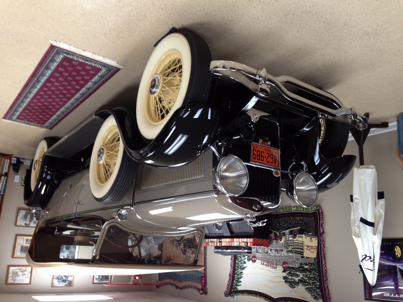

Voced, Gorgeous automobile !
voced
12-17-2017 @ 7:25 AM
Posts: 86
I had the same problem with the white Wall tires from Universal Tire on my 1929 Lincoln. And they told me that after a few years the black from the tires bleeds through the White Walls. It is frustrating consider what you have to pay for WW tires.
