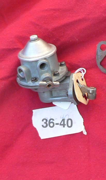

I have an engine apart and now I am in the process of putting it back together. The pump has a history of leaking. I pulled off the top to see the insides and the diaphram does have some cracks. So, I am at the point of rebuilding or replacing it.
09-20-2017 @ 7:44 AM
Tom, If you have the correct 1936-1940 fuel pump, have it rebuilt by Charlie. If it is the replacement type pump, just buy a new one, unless you are going to have the car judged, then I would look for a 1936-1940 fuel pump.
ken ct.
09-20-2017 @ 9:31 AM
Posts: 1513
Yes Tom O , that is a correct late 36 pump ie: offset inlet an outlet and no 4 tab top cover. Completely correct for late 36 -40. Funny thing is he just ordered a 47-48 glass bowl pump from me. Wish I had his phone # to find out what he really wants. ???? ken ct. 1-203-260-9780
