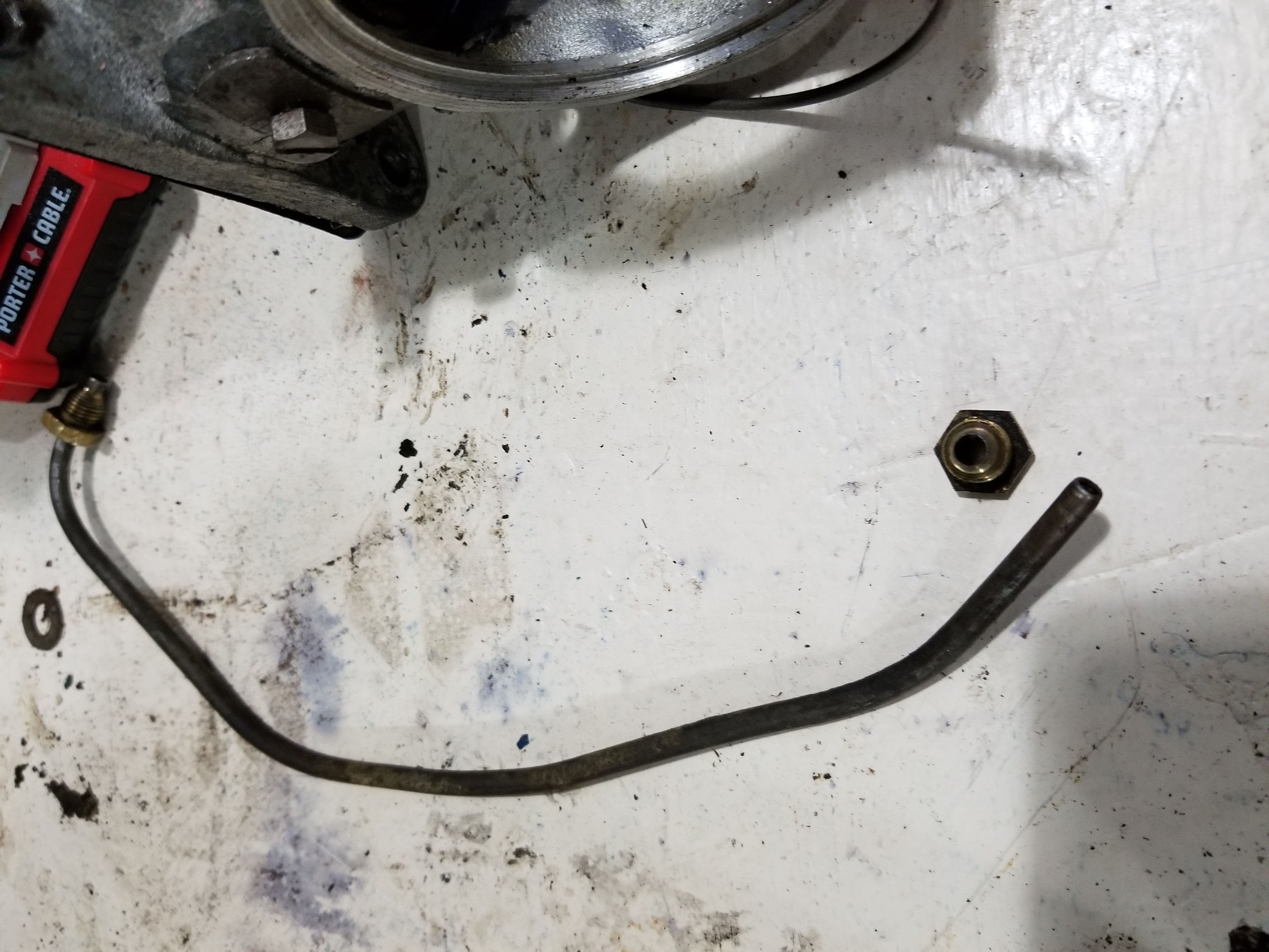

The vacuum line does not use a ferrule, so it could separate like that. It should not have made a difference.

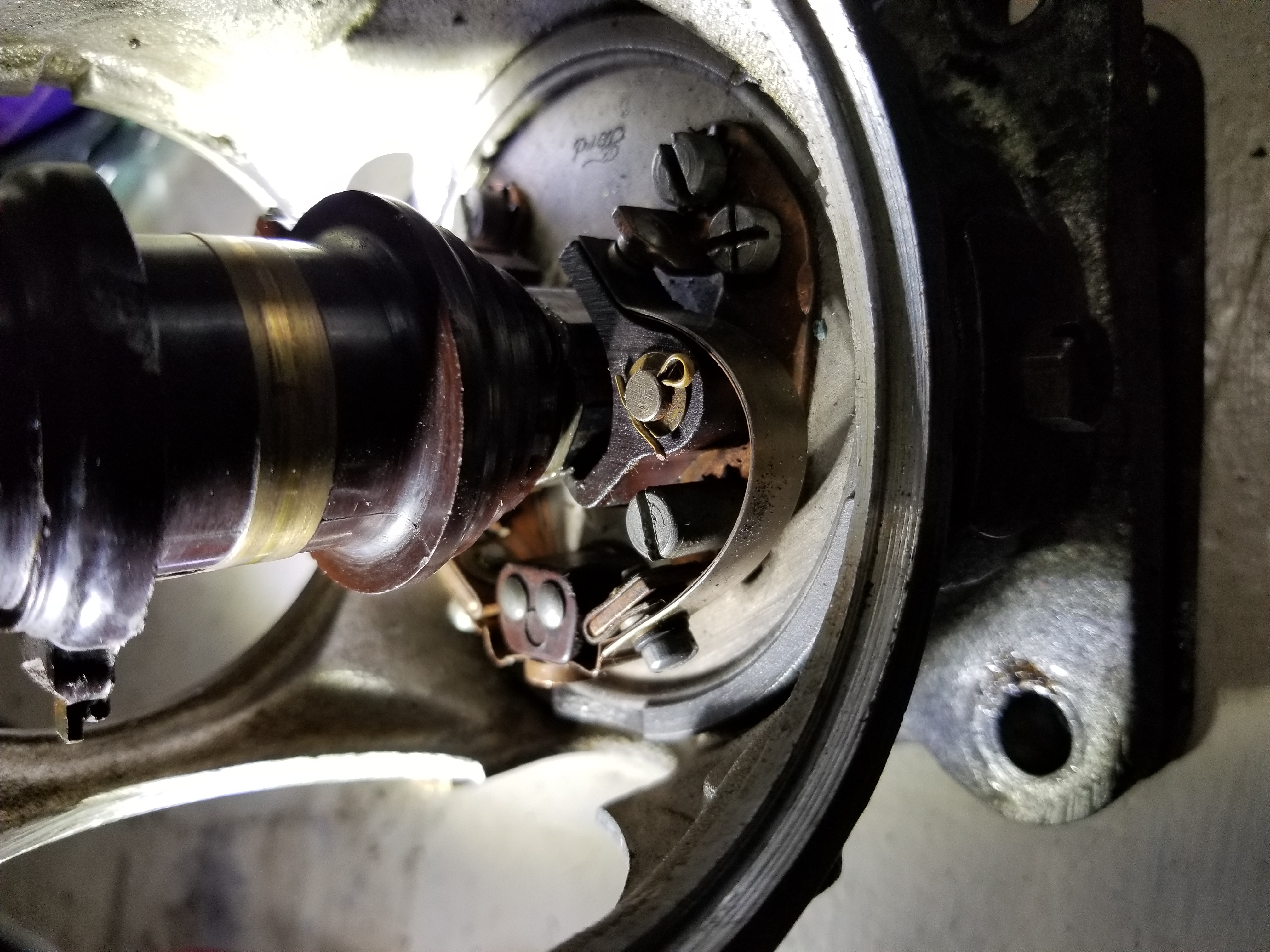

Both rotor contacts have chips out of them, so you will need a new rotor. If your inner caps have the silver contacts on them, they are the ones made in Argentina and they will destroy most rotors. look for damage around the contacts on both inner caps.
When you checked the voltage at the input to the coil, did you tap the starter button to see if the voltage changed? The 3.4 volts that you posted is good for when the points are closed and not good for when the points are open. If that is the voltage with the points open, then your ignition switch may be causing the problem.

Take an OHM meter and make sure the points are not shorted out. You should have no connection between the moveable point and the distributor base, with the points open. Slip a piece of cardboard or thin plastic between both of the contacts to make this check.
It is possible that the movable points could be shorted out where the spring is scr*w*d to the base.

Check our point gap you should have .014 to .016. The contact surfaces should be bright and shiney.
It looks like there is a chip out of the front part of the rotor, be sure it not break the cap, or that the rotor is not cracked.
The vacuum line should not come off like that, but I doubt that it would cause the problems you describe.
Can you post a picture of the other side of the distributor?

Ok. I pulled the distributor, and the first thing I noticed was the vacuum line separated from the nut. I'll post some pics of the inside of the distributor as well
