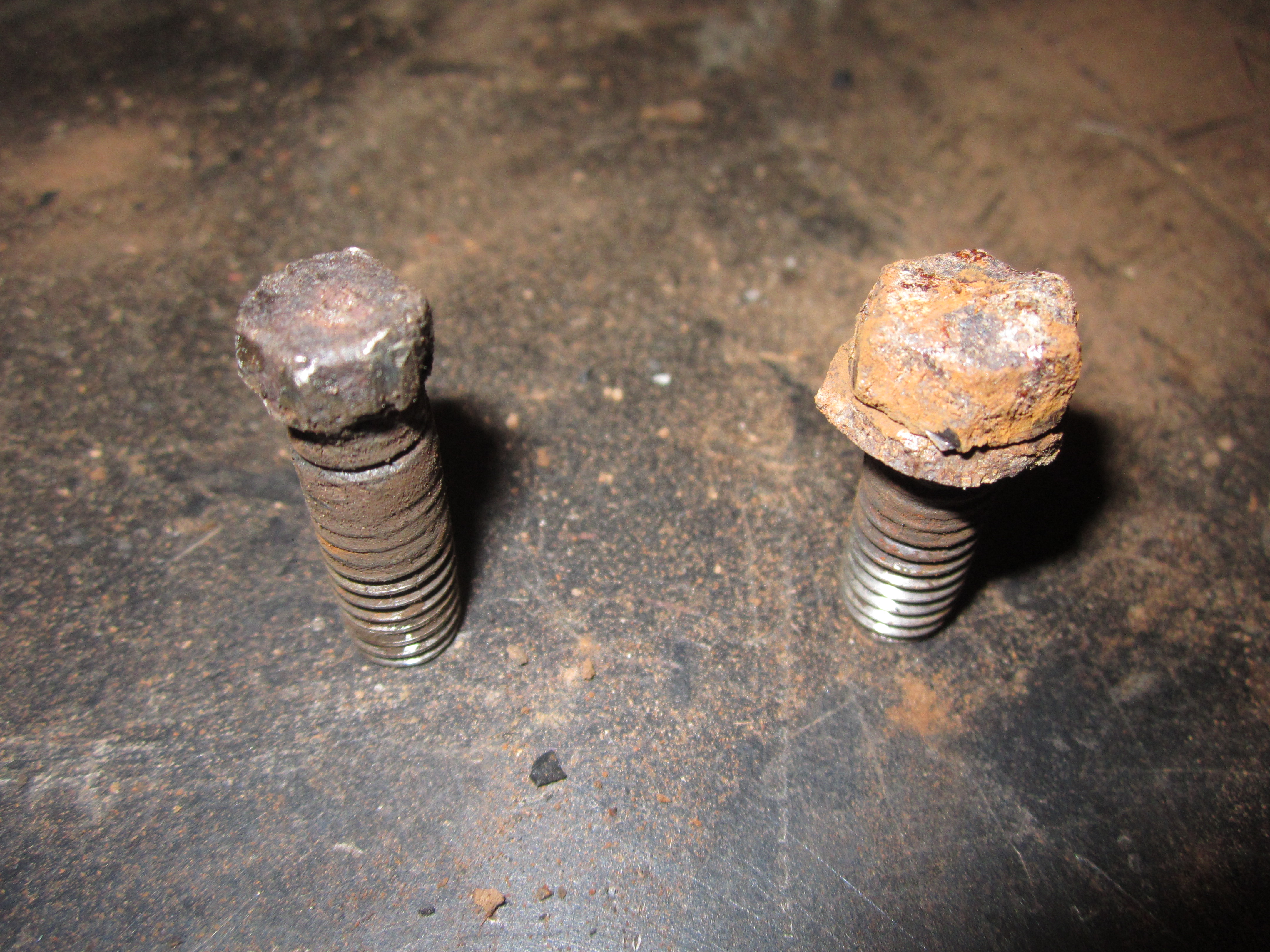

Update:
Success! I was able to remove the hidden bolt without too much hassle.
I sprayed penetrating oil on it and soaked overnight. Found a 10mm socket that fit snuggly over what was left of the bolt head. I pounded it on pretty good, gave it a couple extra slugs, just cuz. It broke loose a bit, then I worked it back and forth a small nudge at a time. I finally got brave and kept loosening it and Voila!
In the attached pic you can see the problem bolt on the left, while the other bolt is the one from the other water pump that came out pretty easy.
Thanks to all for the helpful ideas.
gregg
