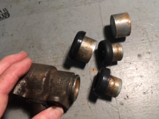

The rust comes from the cast iron wheel cylinders. The aluminum corrosion is white and the pistons will corrode if left in a water solution for a long period of time.
DOT 3 brake fluid attracts water, so if you did not use a fresh can of brake fluid, it may have had water in it.
With that amount of corrosion, I would flush the brake system with denatured alcohol and then again with fresh DOT 3 brake fluid before the new parts are installed. You will have to plug the rear lines in order to flush the front lines.

I have pics of the wheel cylinders that we took out. Lots of rust on the pistons and wheel cylinder walls. The piston in one of the cylinders would not budge until I kept flushing it with hot water and it finally broke free. How does "aluminum" rust, or the honed walls of the cylinders rust? The brake lines had been flushed, new fluid was added less than 6 months ago and the car is kept in a temp controlled garage.

Rust on the wheel cylinder pistons should not cause this problem as they should be aluminum and the rubber cups provide the seal.

Just got back from the garage where we installed new front wheel cylinders. My new wheel cylinder kits that I had installed less than a year ago had rust on the pistons [probably wrong term}. Bled the brakes. Also we checked the free play as soon as the car was lifted. It was ok. Test drove the car and it seemed to work ok.
