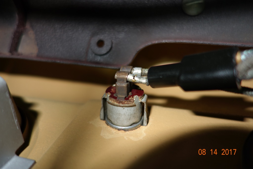

Bob, the switch may be OK. You can check it out by connecting your voltmeter on the 2 wires coming out of the switch and turning on the switch. With the switch off, you should read battery voltage (6.2 - 6.5 V) with the switch on, you should read 0.1 or less.
If the switch is the culprit, you can try to repair it by carefully bending the tabs to release the phenolic piece. The switch will probably pop apart, so be careful and hold the phenolic piec in place so you can see how the parts fit.
My guess is that there is a wiper that connects the 2 posts when the switch is pushed in and that you can clean the wiper and the 2 contacts to make the switch work.
If the problem is not in the switch, which is what I think, remove the bulbs that are activate by the switch and using the resistance scale of your meter, connect one lead to a good ground on the back of the dash and the other to the switch lead. If you get a reading, you have a short circuit. Check all of the wires going to the lights and the clock.

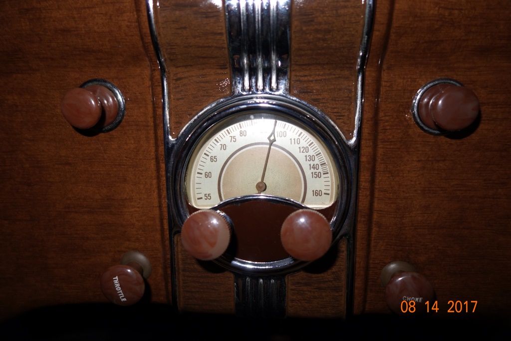

Again Steve this is NOT a dimmer switch ,either on or off. He also has a short some where in the lighting system , switch should NOT get hot. Find the short first. 35-39 all used this switch,knobs and sw.pos. are diff. on is either in or out depending what yr. ken ct.

Here is one on the dash. Upper left of the radio

Here is a photo from under the dash
