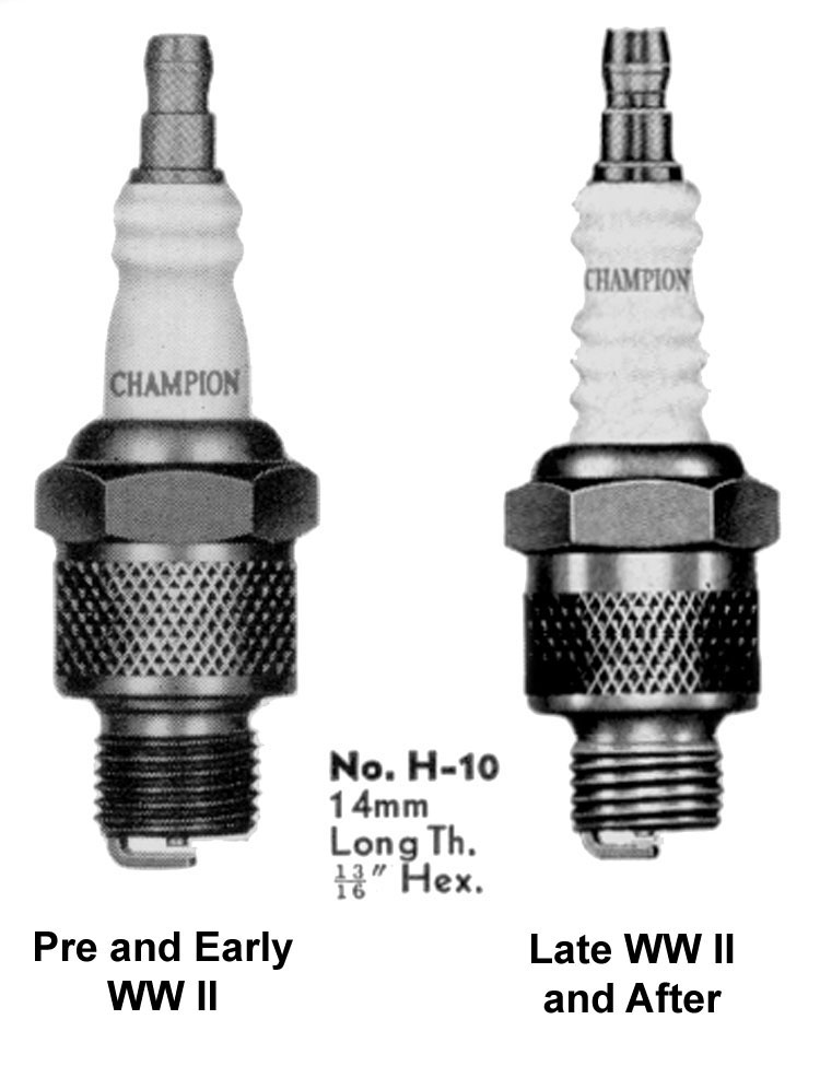

Mike is right again. Your title asks for "correct", which is not the same as "what type". The two rib plug Mike refers to is also described as having a coke bottle shape, and is priced at about $500 a set, not what you want to use for touring. The H10c plugs will have a straight shank, 5 ribs, and a silver color base. You can camouflage the base with a black dye or marker pen, but if point judged on the Concourse with a '40 Ford, the incorrect plugs will cost you points. Alan
This message was edited by ford38v8 on 8-5-17 @ 10:32 PM
Don Rogers |
08-05-2017 @ 8:05 PM
Posts: 512
Here's a comparison of early and later H-10 plugs
ford38v8 |
08-05-2017 @ 10:36 PM
Posts: 2883
Thank you Don, I misspoke about the later plug's number of ribs. Correction made.
