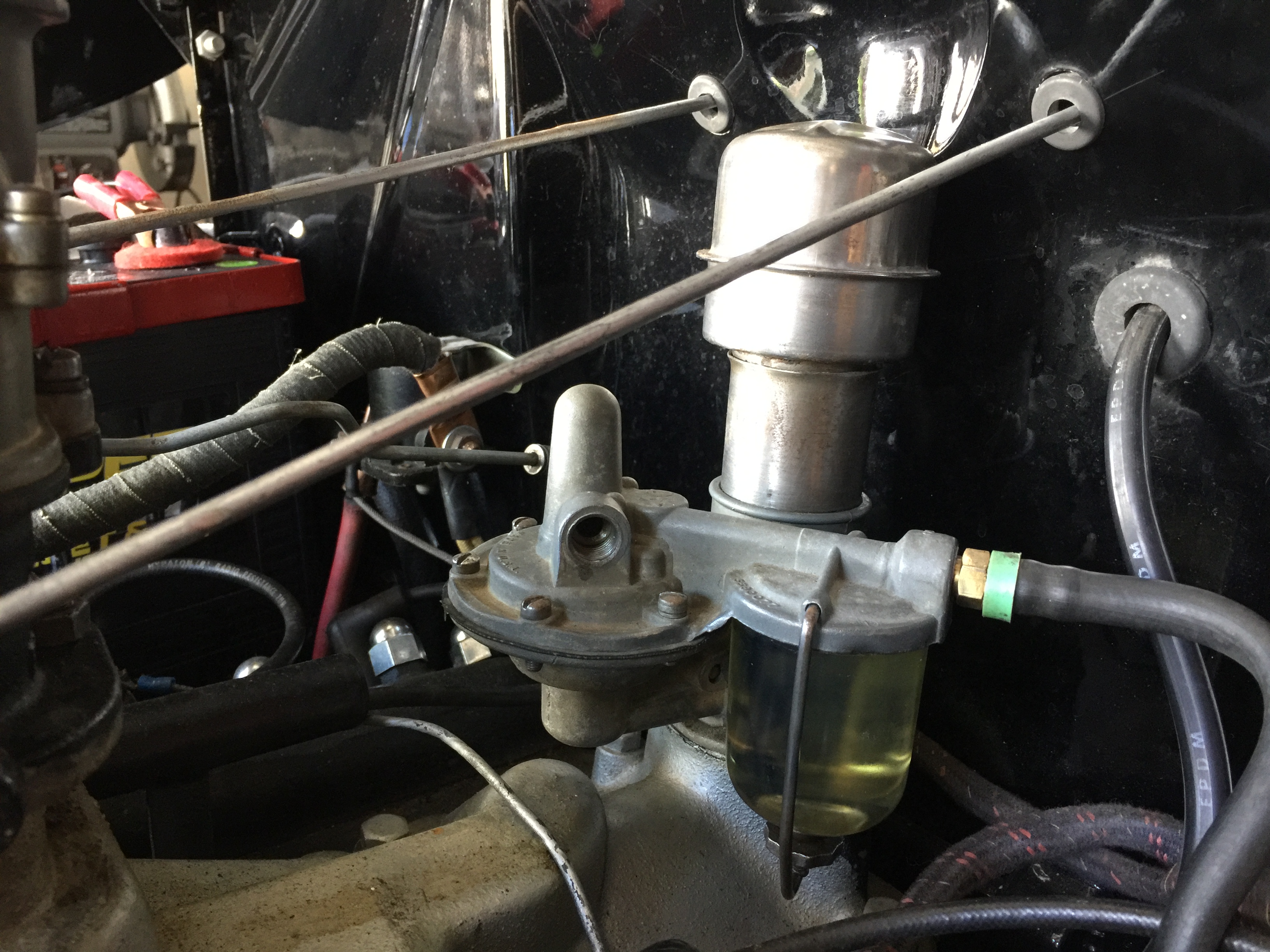

Can someone send a pic of the original fuel pump for a 1940 Pickup. I went to Mac's and Carpenters websites and it looks like the match for my pump is a later 40's fuel pump.
Mine doesn't want to draw fuel.....even from a gas can right in the engine compartment. I took the pump apart and it seems ok......pretty basic...anyone know where rebuild kits are found.

Before you go tearing it apart for a rebuild, how confident are you that you are not sucking air somewhere between the glass bowl, flex line, couplings, steel gas line and fitting to the tank? Been there, done that, so I'd make sure the entire fuel delivery line is buttoned-up absolutely without question rock-solid before blaming the pump. The fuel delivery line/'system' from the tank to the diaphragm CAN suck air and NOT leak gas, especially the glass sediment bowl seal. Spoken from experience and excellent advice from this Forum.

I already tore it apart and cleaned up the insides. I isolated the pump by disconnecting the line to the tank. I checked for pressure by sucking and blowing into the pump. Seemed to hold air pressure so I hooked up a fuel hose to a gas can inside the engine compartment with 2 feet of fuel hose and it would not lift any fuel. Is the picture I posted the correct fuel pump for that year?

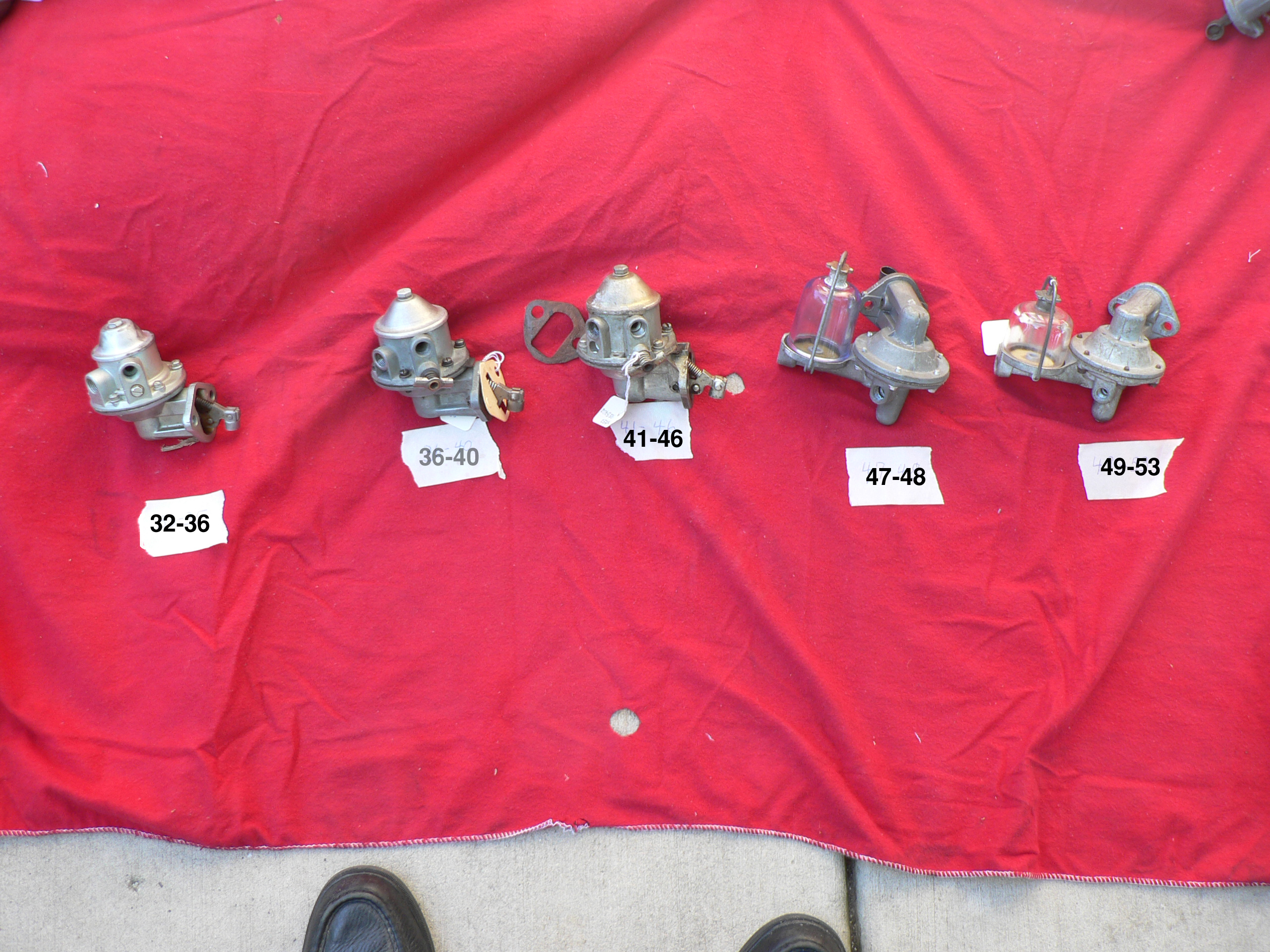

Here are photos of the fuel pumps used between 1933 - 1953. The pump labeled 1932-1936 was first used in 1933.
The pumps used between 1933 and 1940 all had the outlet port about 1/2" lower than the input port, the 41-46 had the ports at the same level and had tabs on the sediment bowl cover. The 1947 fuel pump started the use of a glass sediment bowl. Any of the 1936 -1948 fuel pumps will work on your 1940 engine.
If you have a vacuum gauge, connect it to the input of the pump and crank the engine. The pump should develop 10 inches of vacuum and take about 1 minute to leak down. If you don't have a vacuum gauge, I would buy one. They are very useful in setting the idle and for trouble shooting problems.
Sources for vacuum leaks on the input side of the pump are: sediment bowl gasket, warped sediment bowl cover, leaky flex line and connections that are not secure. If the pump does not develop vacuum, the cause could be the diaphragm or a worn push rod. If it loses vacuum to rapidly, the cause could be the input valve.
Do not replace the flex hose on tthe input to the fuel pump with a rubber hose and hose barb with a spring clamp. That setup leaks 99 out 100 times.

Tom ,is 95% correct except for the pump on the right 49-53 is a composent pump top section ok ok but base section is from a 34 to 46 as it is the short mount. 49 up have a much taller one than older ones and have 1/8" pipe thread for inlet an outlet. Thanks for the pics Tom as I cannot do them. ken ct.

Thanks Tom
Nice line up of Fuel Pumps. It looks like I have the 47-48 fuel pump on my 40'. I think I'll order one from Mac's or Carpenter's.
