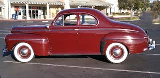

In 1946 there was a choice of only two engines.A V-8 and a straight 6. All had a three speed standard transmissions. Your car most likely had the V-8. According to the V8 Album a coupe had doors that were 34.83" wide. The sedan coupe had doors that were 43.56" wide. For those that maybe confusing a Sedan Coupe and a Tudor the bodies are totally different. The sedan coupe shares the body sh*ll with the coupe.

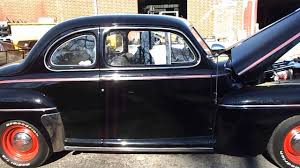

short door coupe

07-16-2017 @ 4:15 PM
Posts: 488
The coupe sedan with a rear seat had longer doors, like a 2-door sedan would have. The coupe with no rear seat had shorter doors as a 4-door would have. Google images of "1946 ford coupe" and you will see examples of both.

Their seems to be some confusion as to the wording "coupe sedan". Most of us think a sedan as being a car with front and rear seating, ether two door or four door. That's what some Ford literature is calling a coupe with a rear seat.
