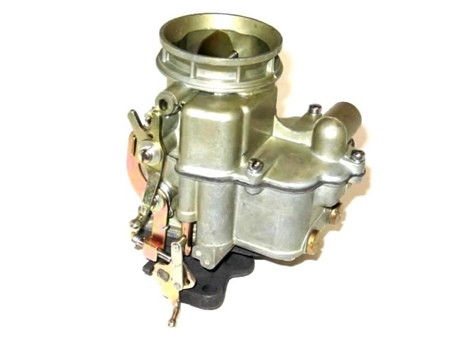

It is an original carburetor labeled Ford. See image, also called Holly 94. I think it was the only one sitting on Ford's flathead in 1953. Thank you for trying to help me and excuse me that it's a bit bad with English but hope you understand.
Lars
This message was edited by mercury1953 on 7-1-17 @ 9:05 AM

Oh,ok you have a 53 Merc with a Ford engine in it. And a correct 94 type carb on it.Looks like a dennis-carpenter repo to me. Don't care for his carbs,many Chineez parts in them. Rubber accelerator pump, rubber tipped inlet needle,incorrect power valve etc. etc. I have USA made kits with all the old-school componants in them for the DIYS guys. Email or PM me as I see you are in Sweden. ken ct

Ken ct The picture is probably from a repro carburetor I borrowed from the net to explain what model was sitting on the Ford engines 53. But the one I own is a good old Henry Ford carburetor. What I want to know is what height the float should be. I do not want to buy a new carburettor or rebuild kit. If that had been the thought, I would have turned to a company that sells them.
