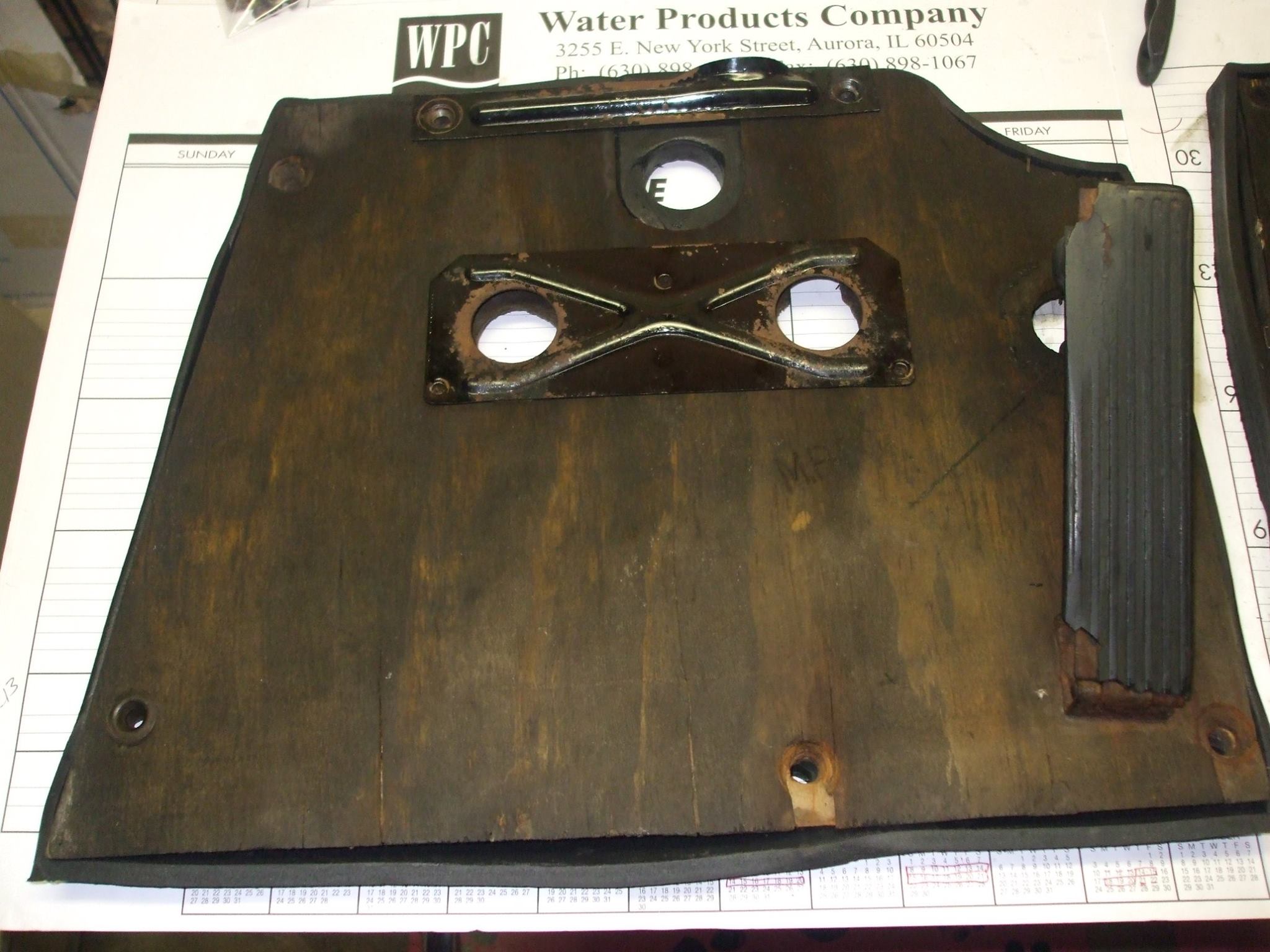

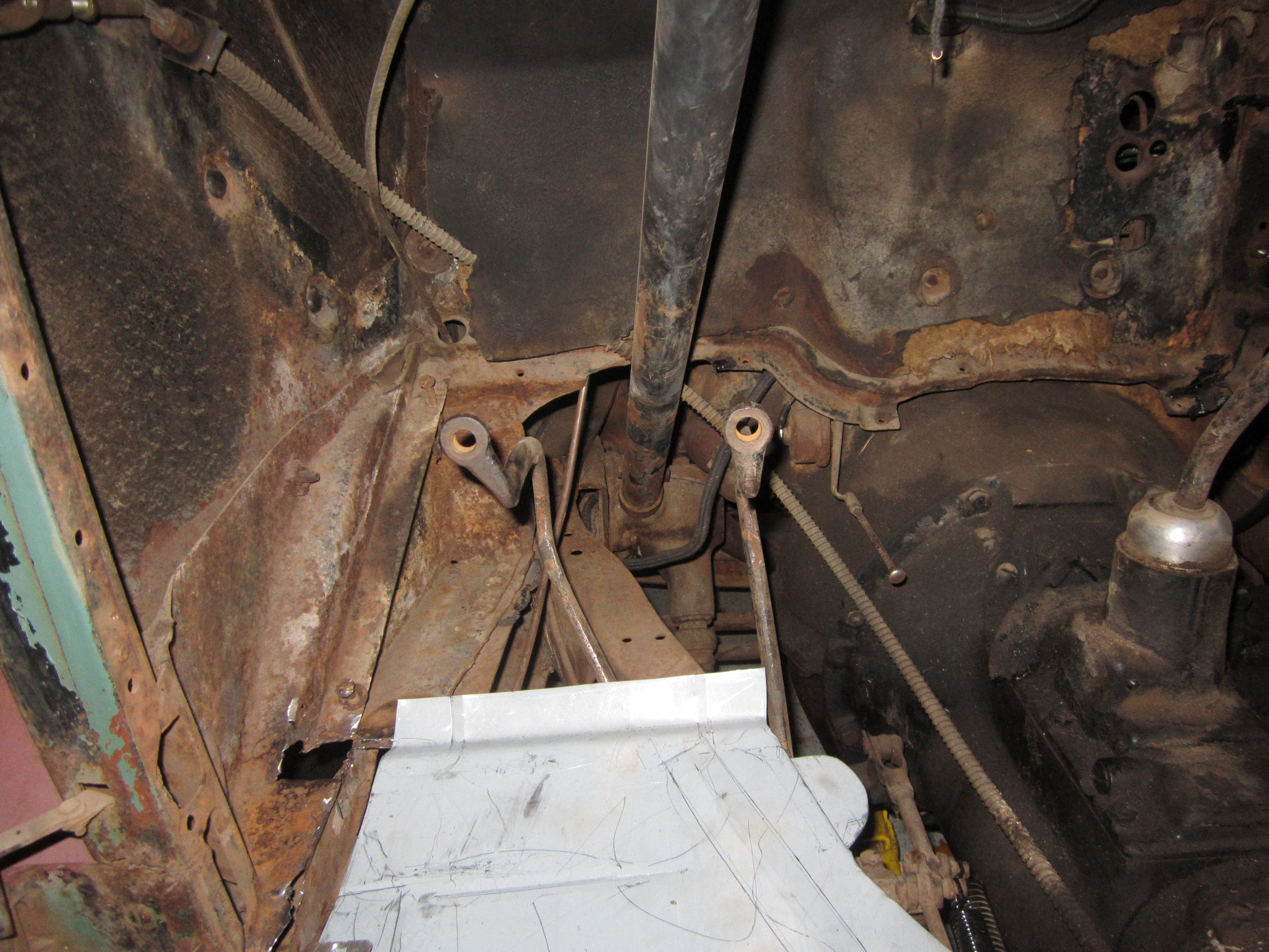

1937sedandelivery
06-25-2017 @ 8:51 PM
Posts: 501
Joined: Jul 2014
Hello,
Are these pictures and discussion about the emergency (hand) brake cable? Rather than the speedo cable?
I just finished routing all my brake stuff and the pictures look like where/how I routed the brake cable.
The speedo cable on my Ford (37) is routed through a hole in the firewall (dash), just above one of the body frame mounts.
BTW, my brake cable is about twice the heft of the speedometer cable.

TonyM
06-25-2017 @ 9:31 PM
Posts: 464
Joined: Sep 2010
Shucks. 37 Delivery, you might be right. That is the park brake cable. I was tossed by this photo. I thought the cable here was going to the speedo gear. Speedo cable is much thinner. Didn't mean to steer the guy wrong.

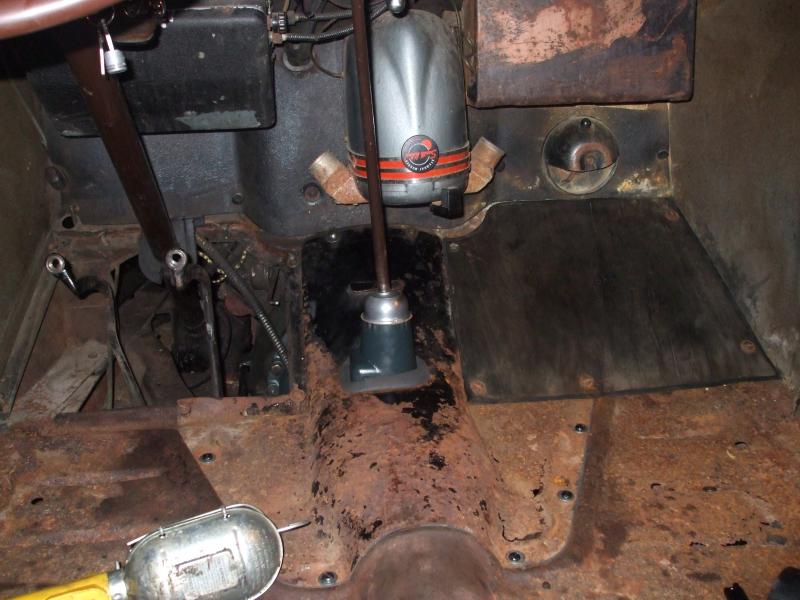

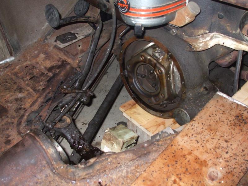

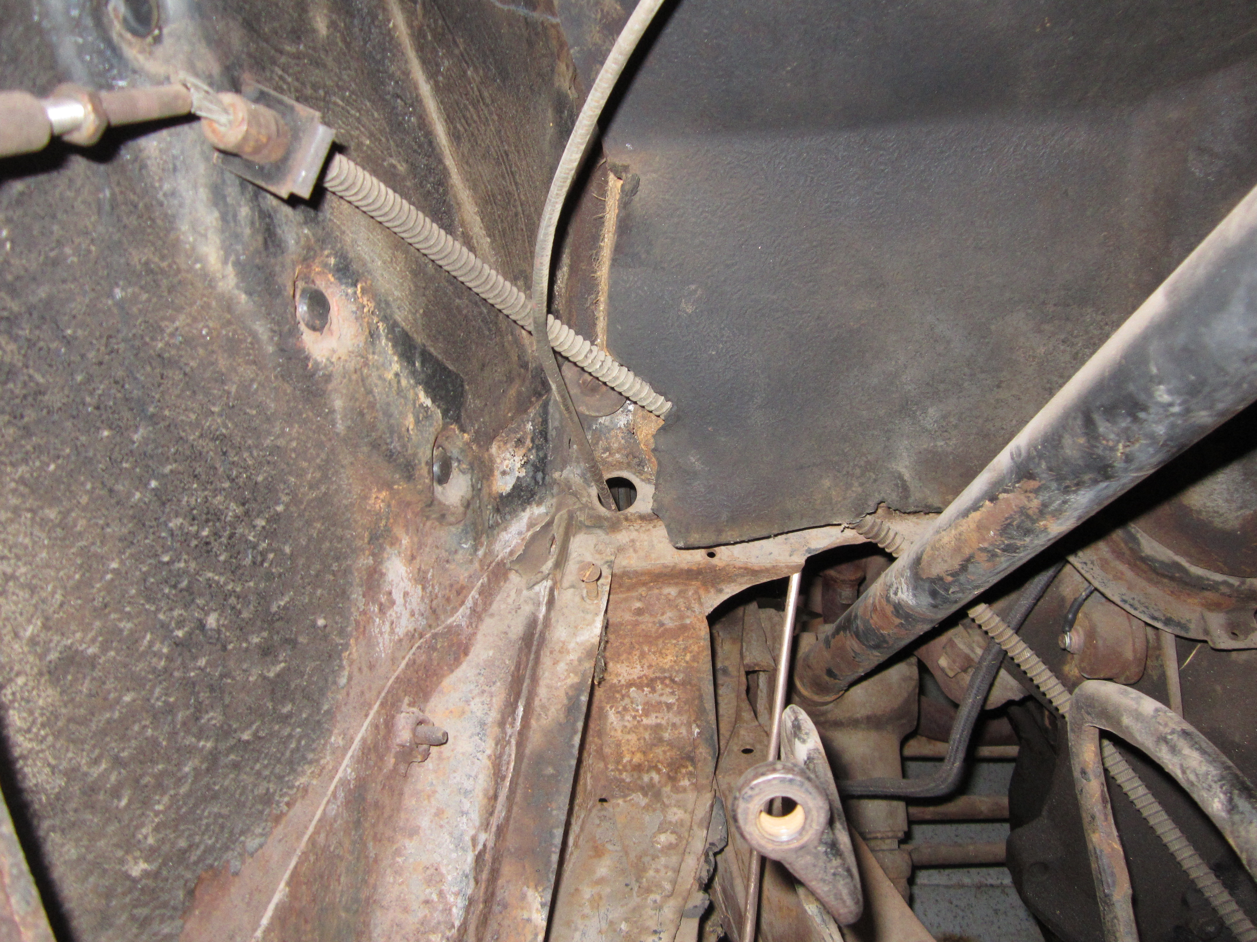

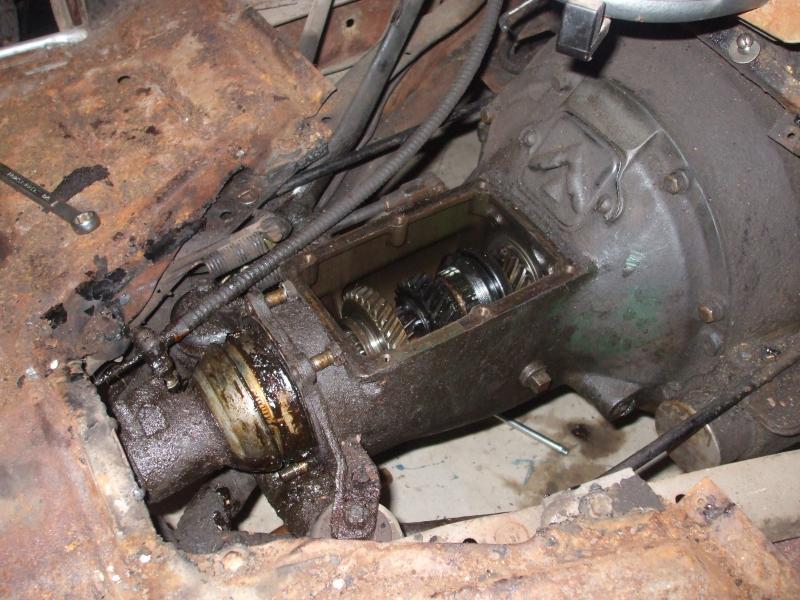

1937sedandelivery
07-22-2017 @ 11:43 AM
Posts: 501
Joined: Jul 2014
Hi,
Hope these pics help.
gregg
1937sedandelivery
07-22-2017 @ 11:45 AM
Posts: 501
Joined: Jul 2014
second pic...
The smaller diameter cable is the speedometer cable.
