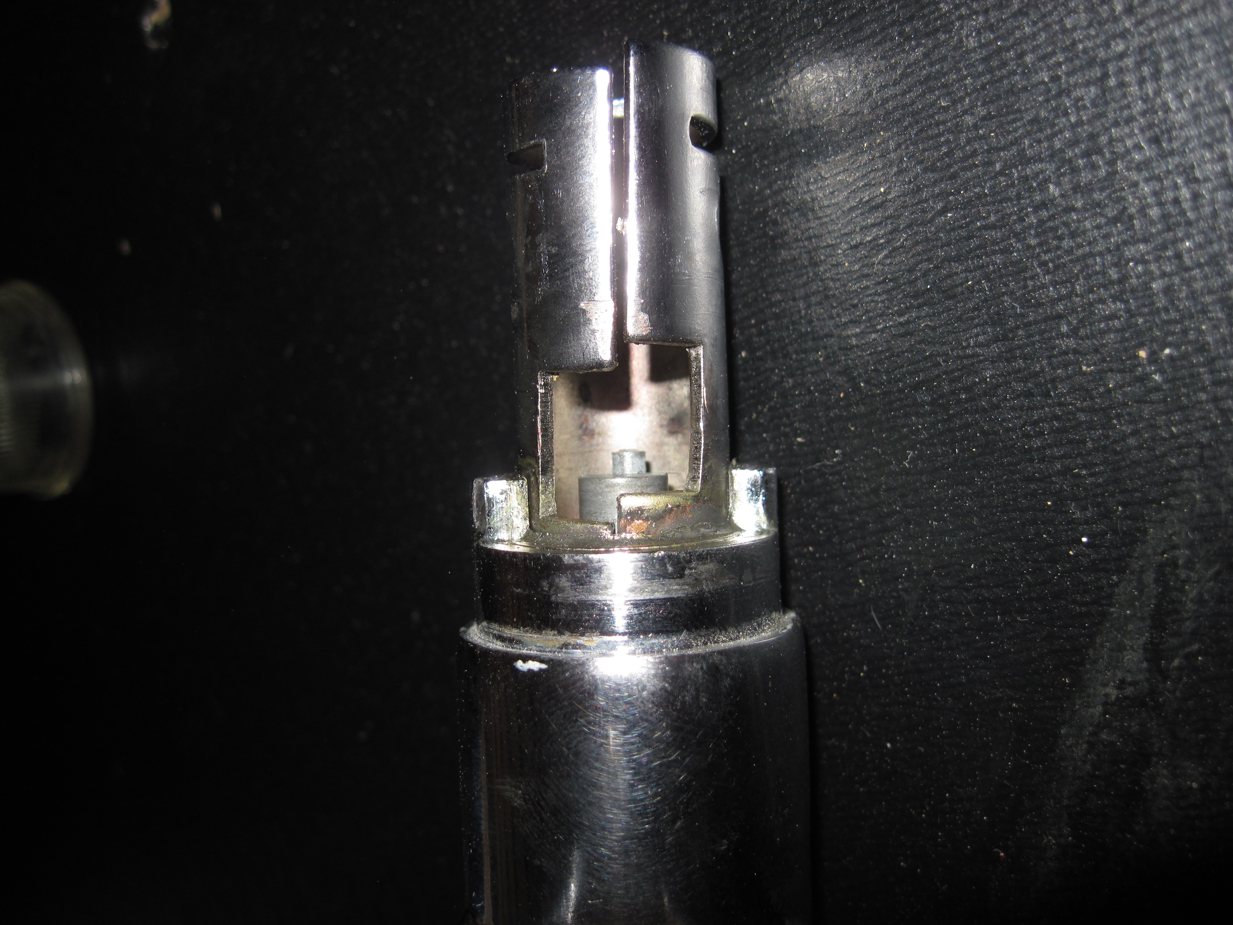

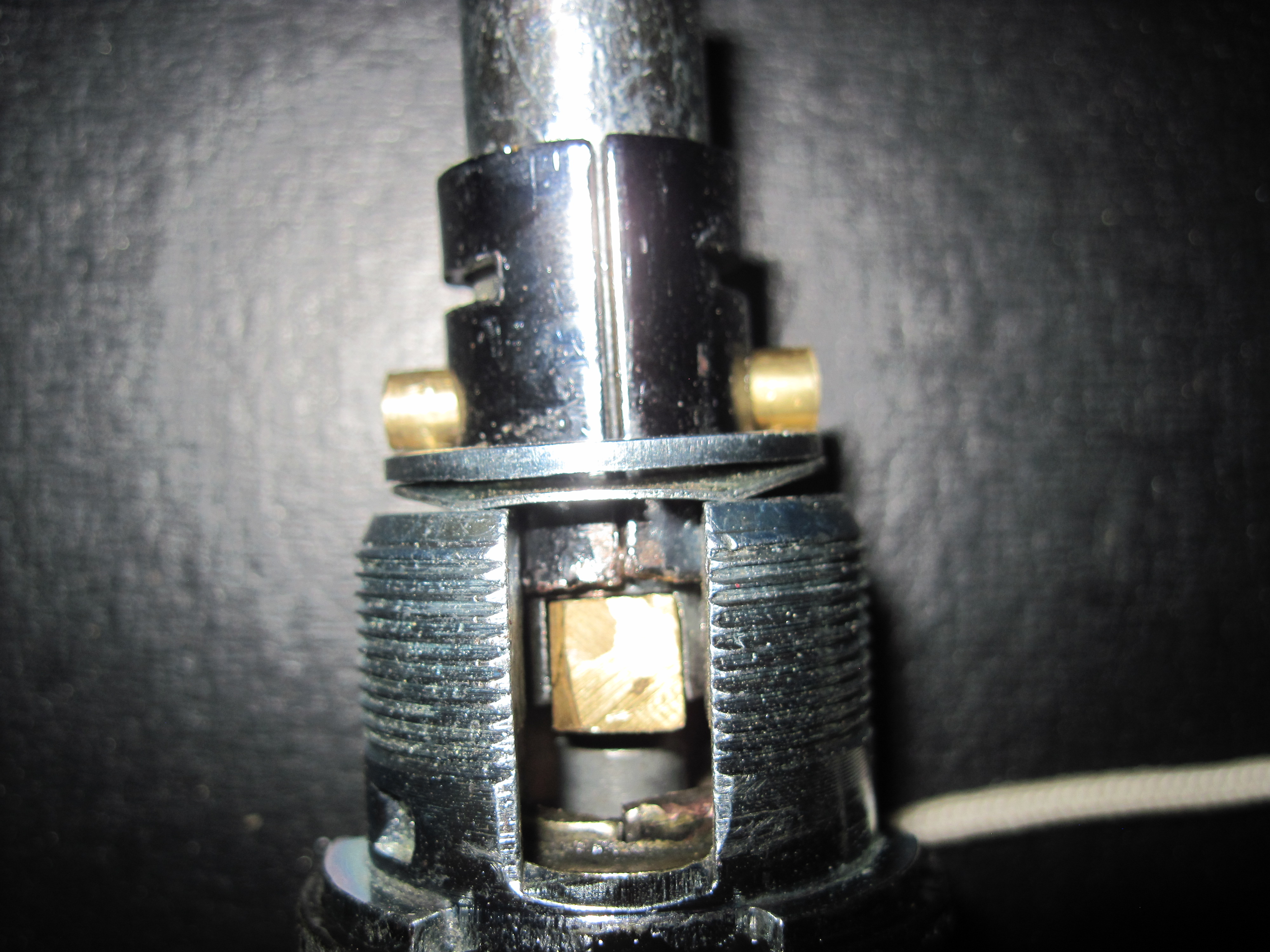

Okay, it's fixed now. I took out the back seat and was able to remove the trunk panel without damaging it. I emptied the trunk except the spare wheel and was able to crawl in to see what's up. There was a brass pin loose and things seemed sloppy, so I was able to remove the large nut that holds the handle on (that was a tough job!) Once it was out, I could then turn the square hole to pop the trunk from the inside. As I examined the part, I noticed that things were a little bent, so I was able to straighten and reassemble the handle. It's back together now, but I'm going to look for an OEM handle, since this thing is of inferior quality. I'm attaching some pics because I know everyone always wants to see the job.

Reassembled handle

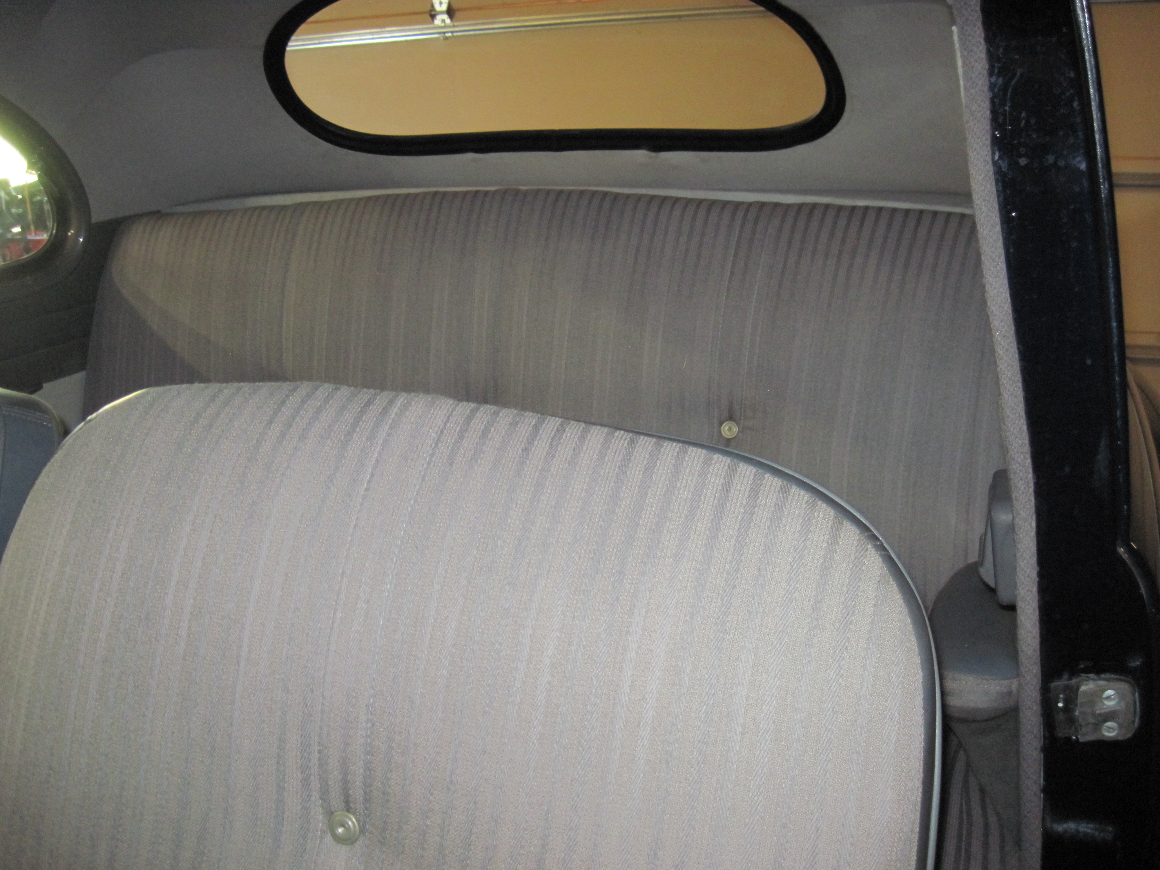

Seat is out

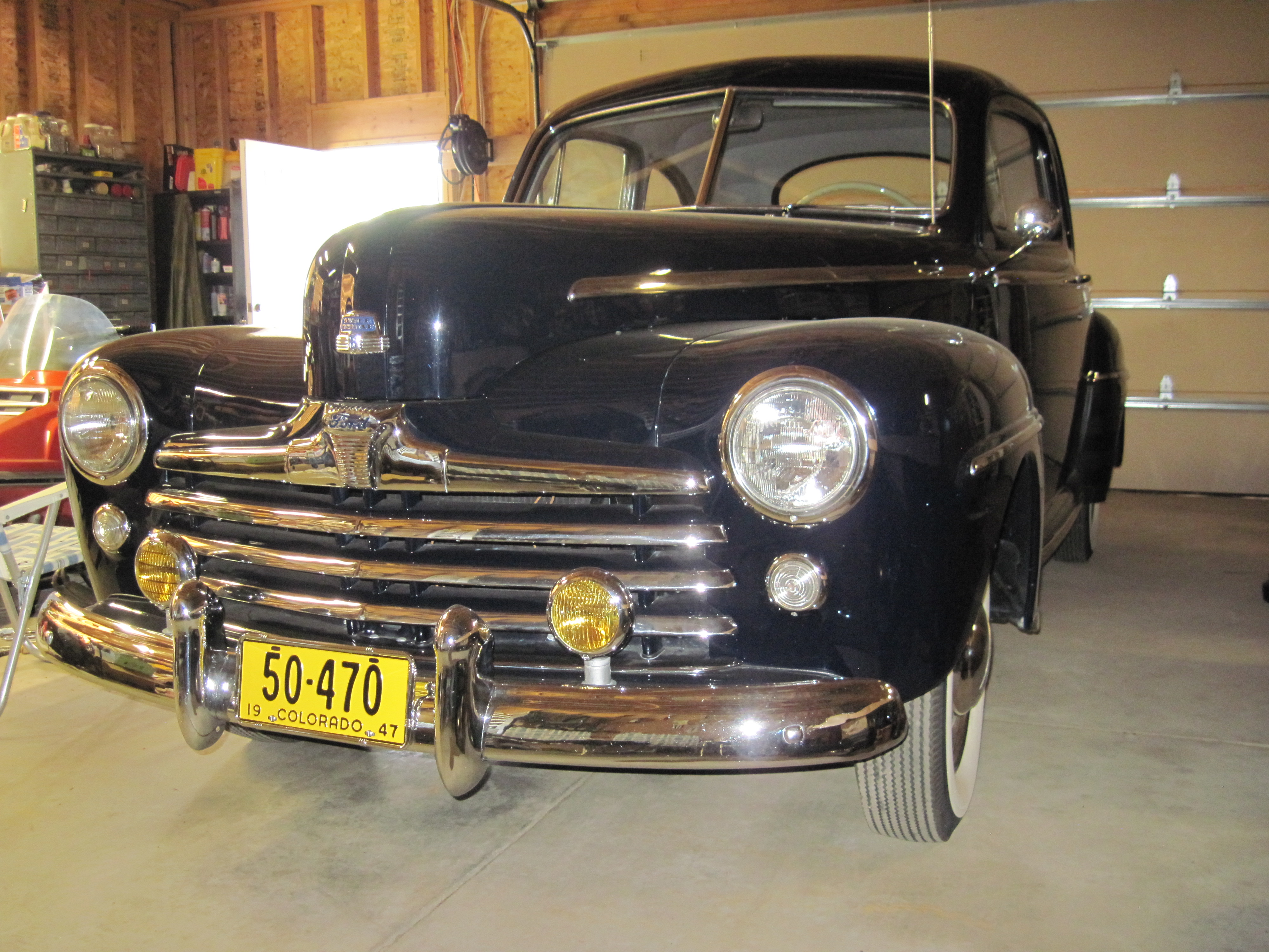

Car happy again (and the owner!)
