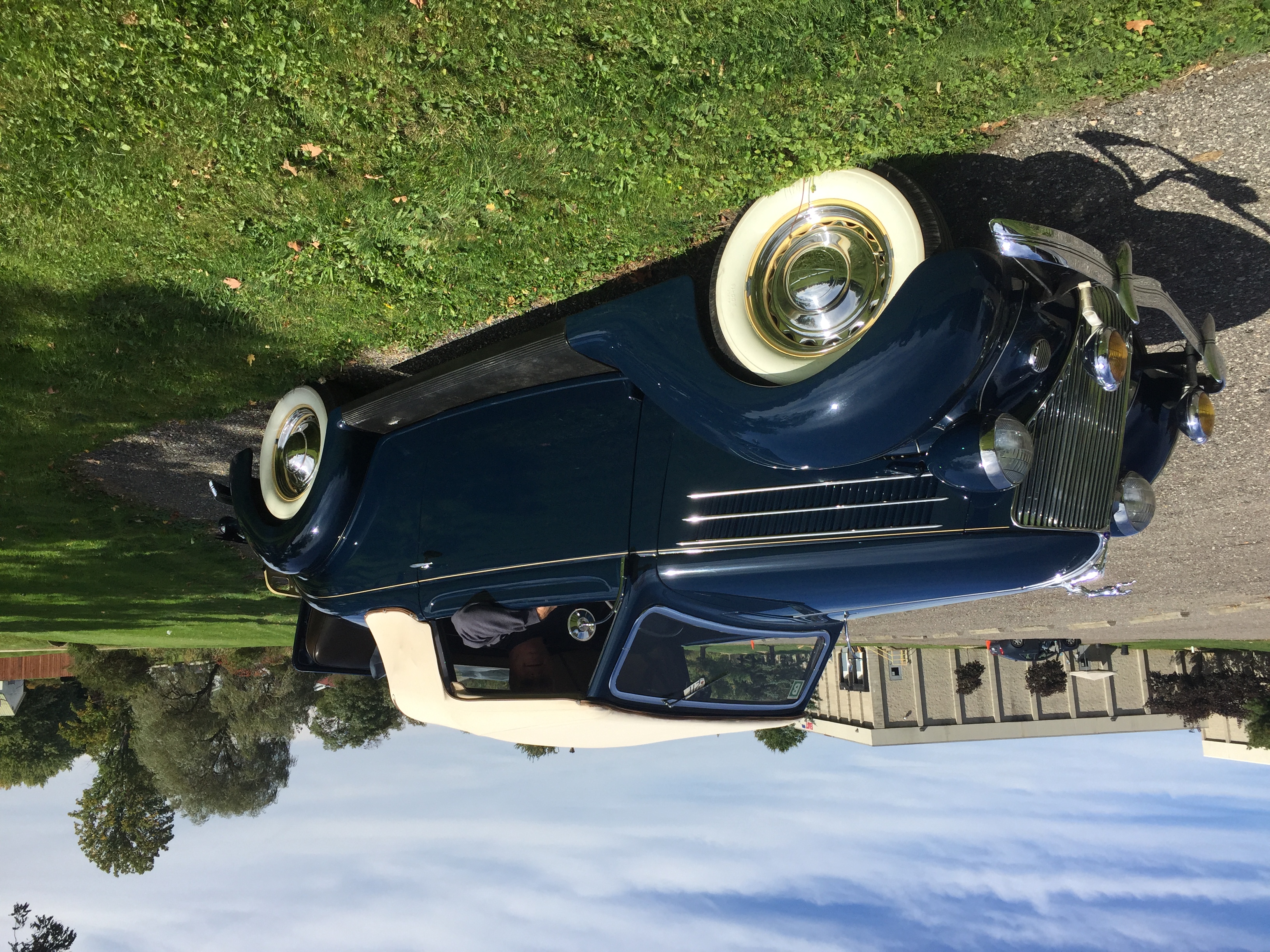

I have done everything with exception of taking the heads off of my 1936 Cabriolet to get it running right. Who would be a good person to call about this situation. Compression is even at 75 lbs and everything else has been rebuilt or replaced. Even the intake manifold. I have run out of things to do. Jerry 574-952-4550

I found the problem. It was the rebuilt carburetor that had one of the main jets oversized. It runs like a new one now. Thanks to all of you that gave me advice. Jerry Hollenbaugh
