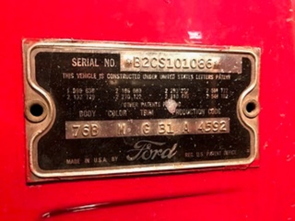

Can someone decode this data plate for B2CS101086
76B W G 31A 4592
Thanks

Your data plate reveals the following:
76B - Crestliner Convertible "Sunliner"
M - M-1722 Coral Flame Red (Sunliner Only)
G - Black Vinyl & Red Leather
31 - 31st day of the month
A - January
4592 - Scheduled Item Number from Production
B2CS101086
B - 8 Cylinder 239 Cu. In.
2 - 1952
CS - Chester Assembly Plant
101086 - Consecutive Unit Number
As you can see, the Data Plate describes the vehicle in great detail.
